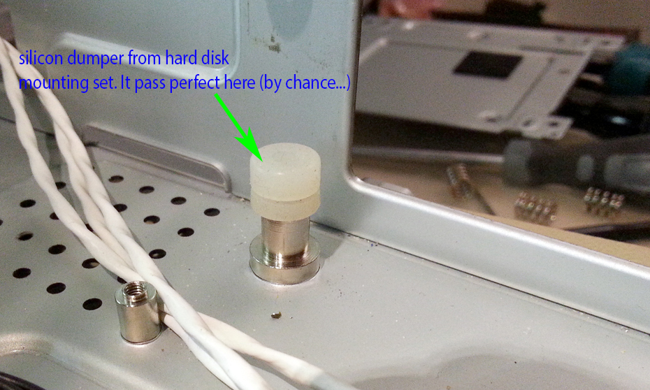

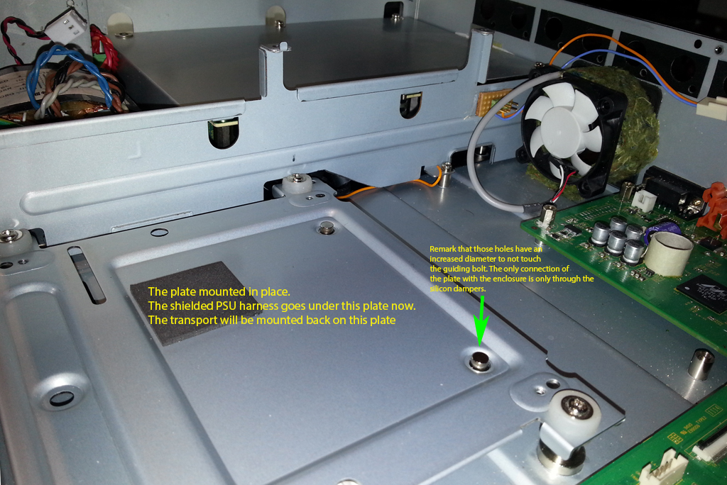

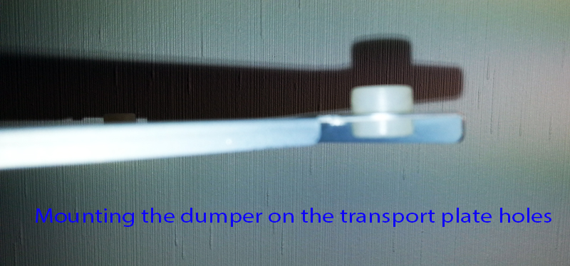

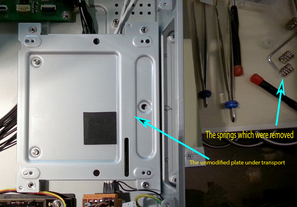

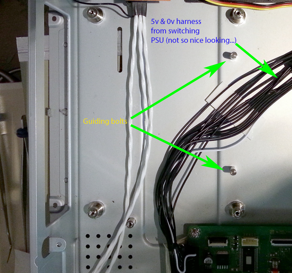

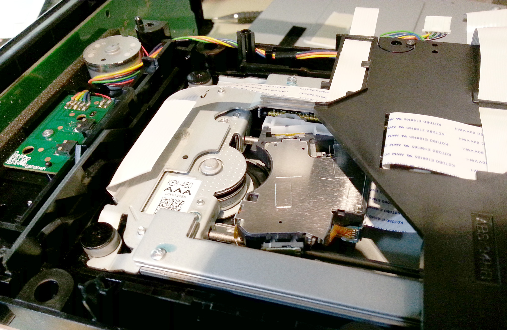

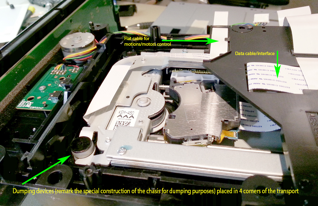

Talking about vibrations in the transport mechanism, I think to show here some pictures about a mod in this respect. I done it for 95 quite a time ago, but it apply very well now for 105 too.
As it is mounted this transport in Oppo players (and maybe in another ones too), it not may prevent vibrations to be transmitted to the optical head. As one can see in those pictures here, the manufacturer of the transport has already did quite much to damp the vibrations inside the mechanism. My opinion is that is not enough this.
Oppo use some springs when mounting this device in to the chassis, but the way those are used is very wrong. The plate is pressed on those springs (the pressure is very high), by some bolts, and this is a very rigid construction! The springs, the chassis and the transport should have separate mounting systems, hanging only on those springs, to allow an elastic coupling. Is not the case with Oppo players!
This mod is not very easy to be done, but I present here the pictures as an inspiration to those who want to try it. The first operation here is to eject the tray (when the player is powered), then remove the front panel of the tray (very difficult), then get the tray in again, and then start the rest of the mechanical operations. The first operation in this order is to remove the heavy front panel of the player. This is not very difficult. Then release very carefully the transport bolts, in a progressive way for all of it. The transport have to be protected against mechanical tensions, as the springs are very powerful.
In my case, I forgot to remove that front panel of the tray, when the player it were possible to be powered. It were quite a pain to have the heavy players front panel hanging all the time on that transport tray, under the whole operation... But it were fine at the end...
So be careful with the right order of the operations to be done, to get the transport out of the case...
Then the rest is to be seen in the pictures here....
