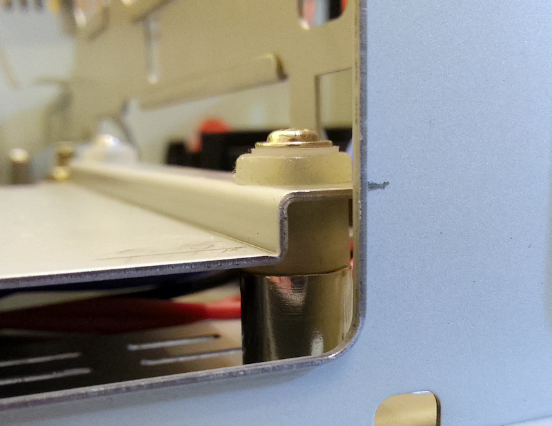

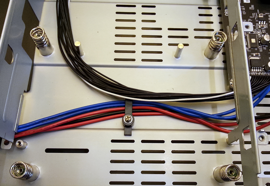

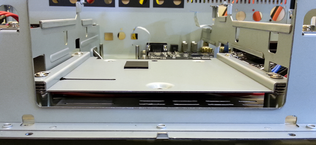

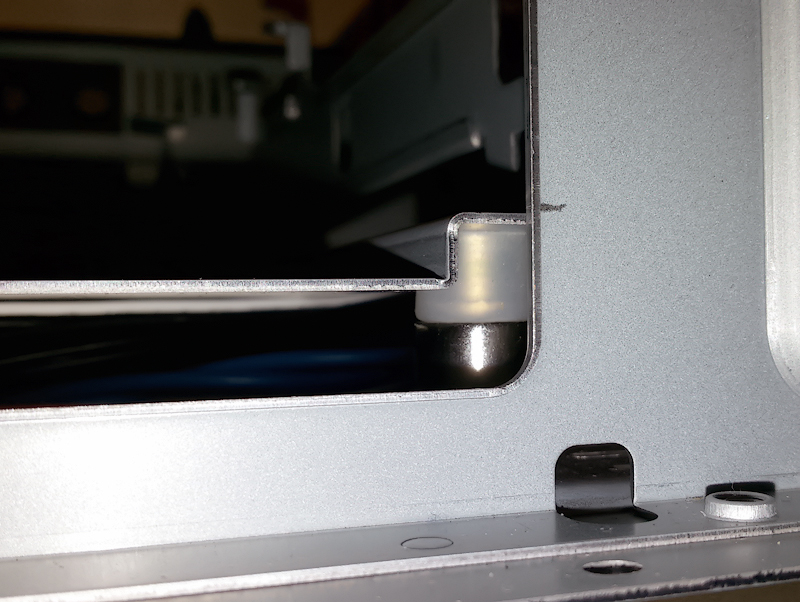

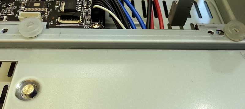

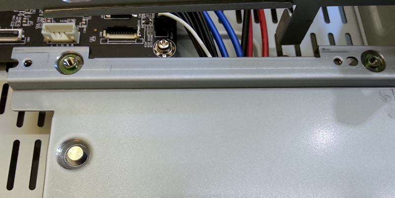

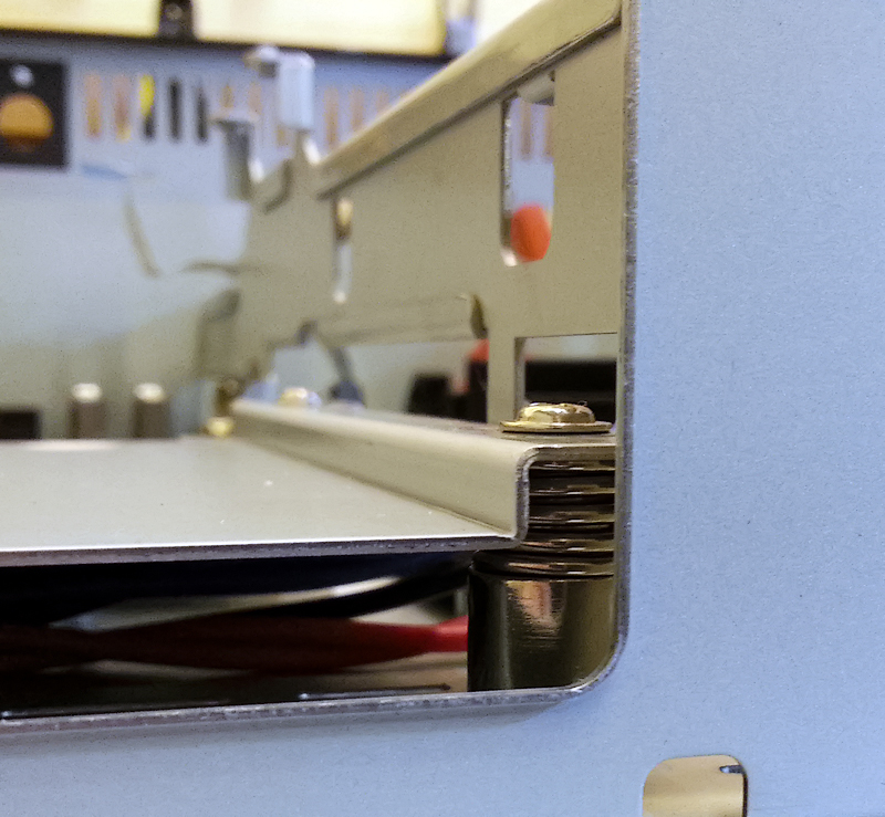

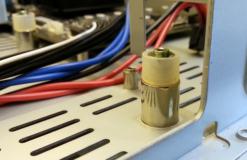

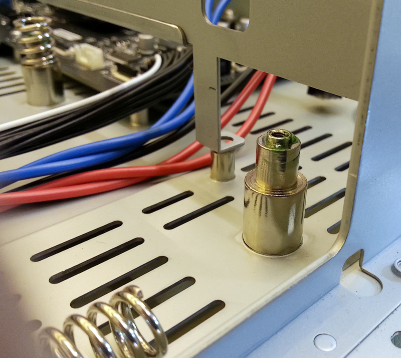

Well, I start my work on Oppo 105. Quite late indeed...
In this post I will be very critical to the mechanical solution Oppo developers have chosen to damp the transport in the chassis of both player models (95, 105).
I think this way is a kind of standard for other players models and theirs transport mounted in the chassis. In my opinion this is the wrong way to be done.
As one can see in the pictures here, the transport is originally mounted on a plate which is pressed on four very powerful springs, by the screws. Is quite hard for me to understand how they thought they who found out a such "damping" method. Where is actually the damping here?
The springs press very hard (it may be a kgF range on all 4 springs) on the the screw which is in a rigid connection with the chassis. What is the difference between screwed down the plate with/without those powerful springs? NONE, is my answer.
The transport is no more heavy than 200 gr or so. The springs all together make use of a force of 5 or more times heaviness of the transport device, to "damp" it... It may be something very wrong here!
To really dump that transport, one have to prevent the hard/rigid contact with the chassis. The transport it may "float" in one way in its place to have a very effective damping of the vibrations (lower and high frequencies too). Only the transformer in this chassis it may induce 50 hz vibrations to the optical system in this transport. The errors generated by those vibrations have to be corrected... This task/work it use much of the processing time, filtering and digital corrections, and at last it may alter enough the resulting sound. But of course is not only about those 50Hz vibrations. It is here about a complex of vibrations which have to be prevented to disturb the optical head in reading the infos, and avoiding the processor further work to get rid of the errors.
I think I get the way the designers here thought about that: there is not so important how the dumping it may be or if it is not so accurate, when the electronics do the necessary corrections on the way... Is cheaper to electronically correct the errors, than design and produce in the right way the mechanical system... In my opinion this way of thinking is only wrong. Processing to much the digital signals induce alterations which are audible at the output. Or if not audible, it lower quite much the resulted sound fidelity, and this it may be audible too...
For sure the Oppo`s engineers have to find the right way to effective dump this transport mounted in the chassis of those players, but not with those heavy springs mounted in the way they are. One may not only copy this mechanical system from another manufacturers of cheap products...
As one can also see in the pictures here, I used some silicon pieces which by chance fits in the task of this case. I do not like very much this solution, because the silicon pieces are not exactly right designed for this purpose. But anyway, this way to dump the transport and isolate it from vibrations is much more effective than the original one.
