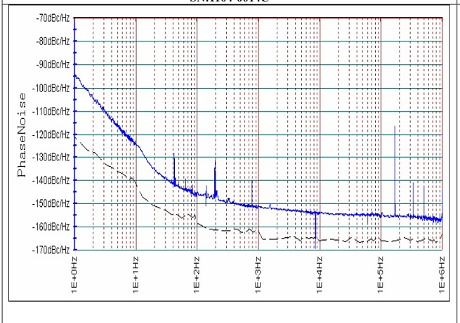

Understood qsp.
This is a tricky discussion because we have peoples products (upgrades)
being (indirectly) scrutinized as a result responses will be affected. I try
to avoid conflict but it's not so easy.
I have to say I have a certain degree of frustration, technically speaking,
trying to make sense of this whole scenario. On one hand Joe is promoting
power supplies that have super low LF noise and very good 'stability' , but
then we have a clock which is poor in this area of performance. From a
purely technical perspective it is hard to join the dots so to speak.
The second reason, which up till now I wasn't going to get in to was the
results I have had with my own clocks. However, I think it is relevant to the
discussion. Refer to the phase noise plot of one of my 'zenclocks'. As you
can see these -do- have very good close in phase noise. That is -95dBc
at 1Hz offset.
These are based on custom made 11.2896MHz OCXO. Sine wave OP, the
crystals are custom made by batch. The supplier gives me complete
set of measurements with each and every clock. I do my own squaring /
level shift, separate PS for every element. So far these have sonically beat
every other aftermarket clock on the systems tried. They are expensive.
So as you can see my results are at odds with results from SAW but there
are other issues WRT 100MHz versus 10MHz, SAW vs crystal, also power
supply 'Q' factors etc etc. I will talk later gotta scoot.
