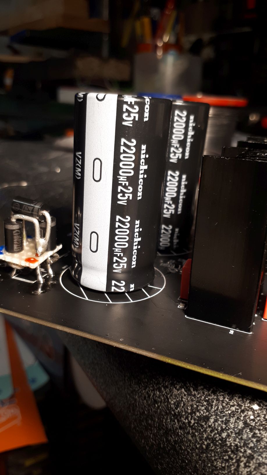

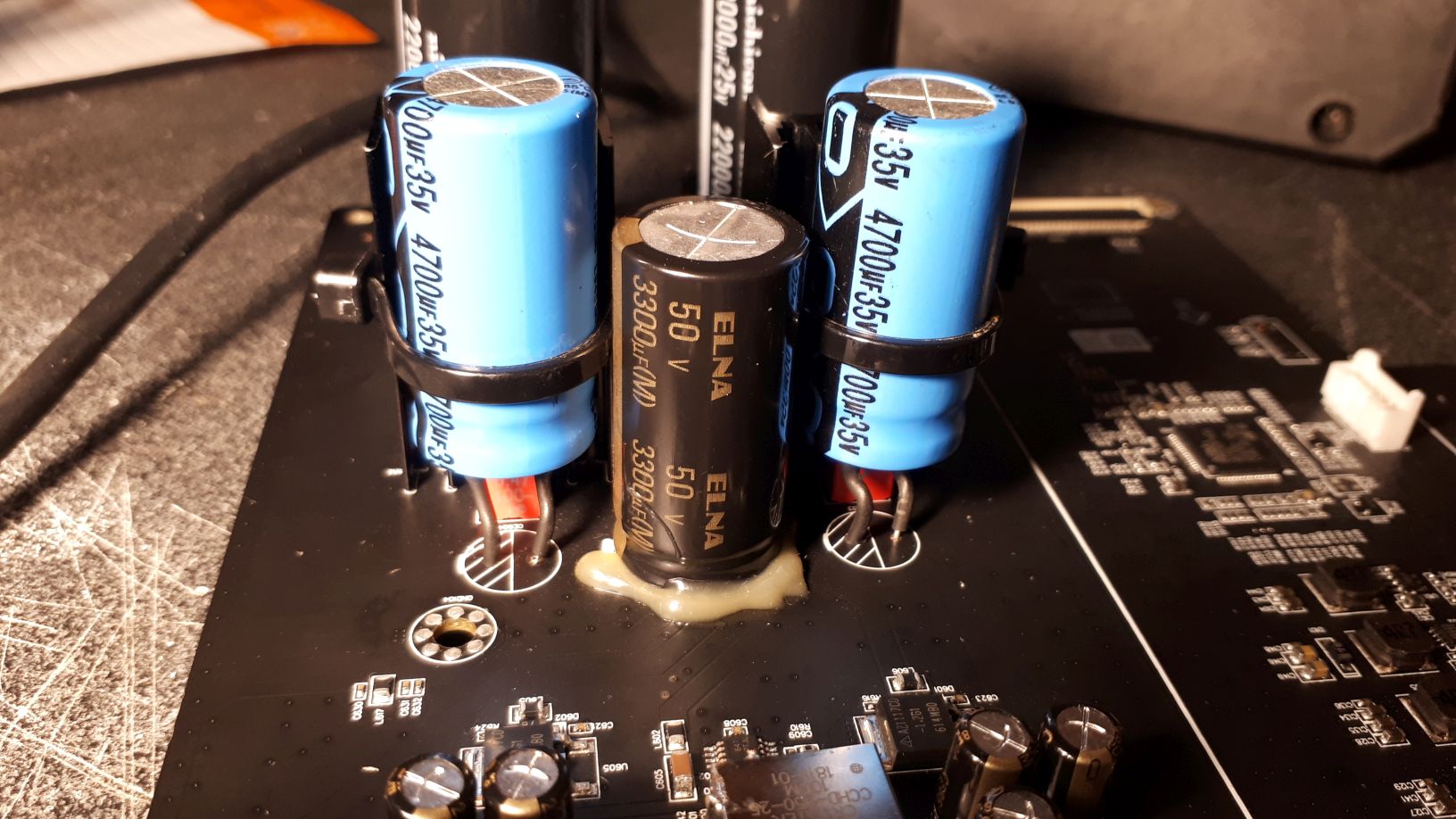

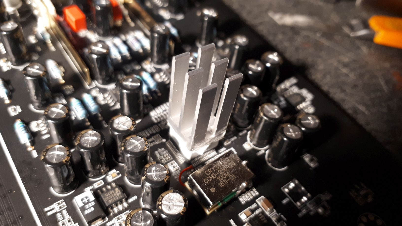

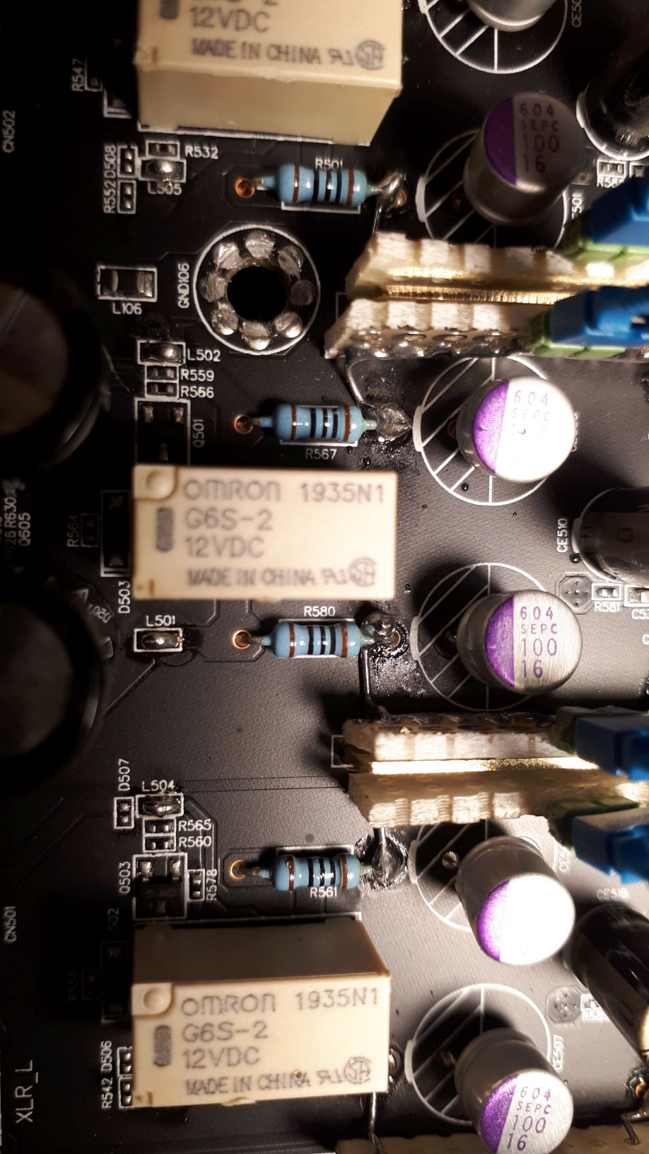

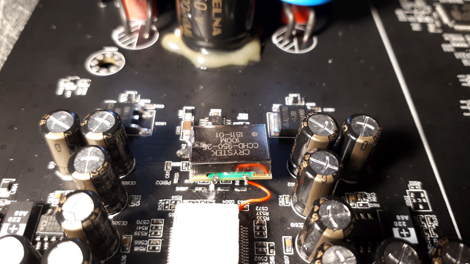

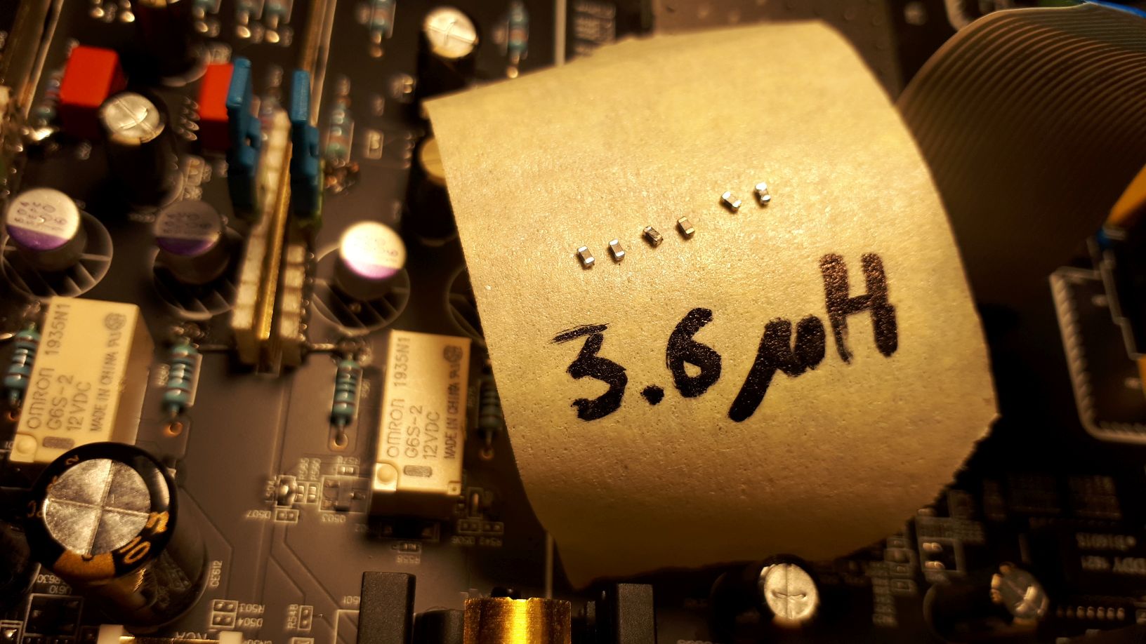

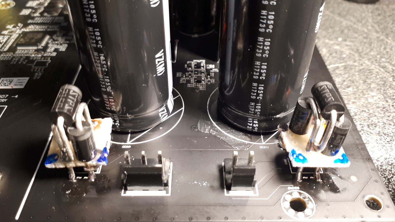

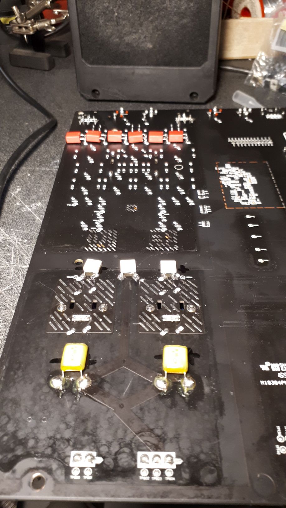

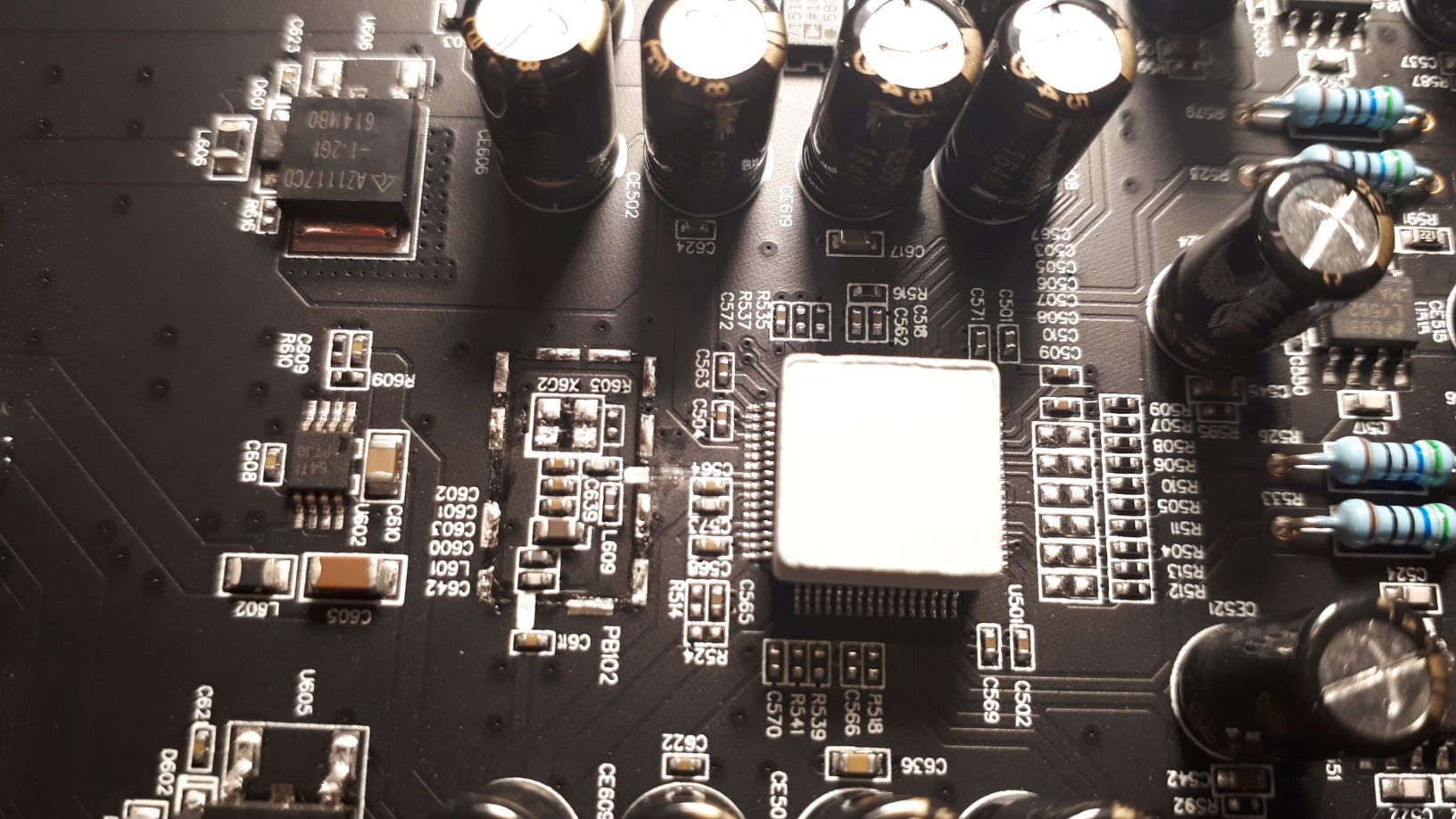

Completed the Upgrading jobs !! (For the moment)😀😀 Replaced the Rectifier Bridges with Schottky Diodes. Replaced in the 12V dual power stage the 6800uF capacitors with 22000uF and 1000uF capacitors with 4700uF, 100nF bypasses were all provided. Replaced +/- 12V regulators with very low noise modules. Removed original 100MHz Oscillator and replaced with module CRYSTEK CCHD-950, thanks to an air desoldering station (purchased on Amazon at 117 €) in 30 seconds with a temperature of 280 ° C, it was very easy to remove the metal screen, it is recommended to have it not to make disasters !! Previously performed, change to decoupling capacitors by replacing the original 100uF with PANASONIC OS-CON with parallel WIMA from 1uF type MKP1 Remove the 3.6 uH inductors in series to the output signal after the relays and bridged with tin drop. Placed with mini heat sink pad on the ESS9038 chip.

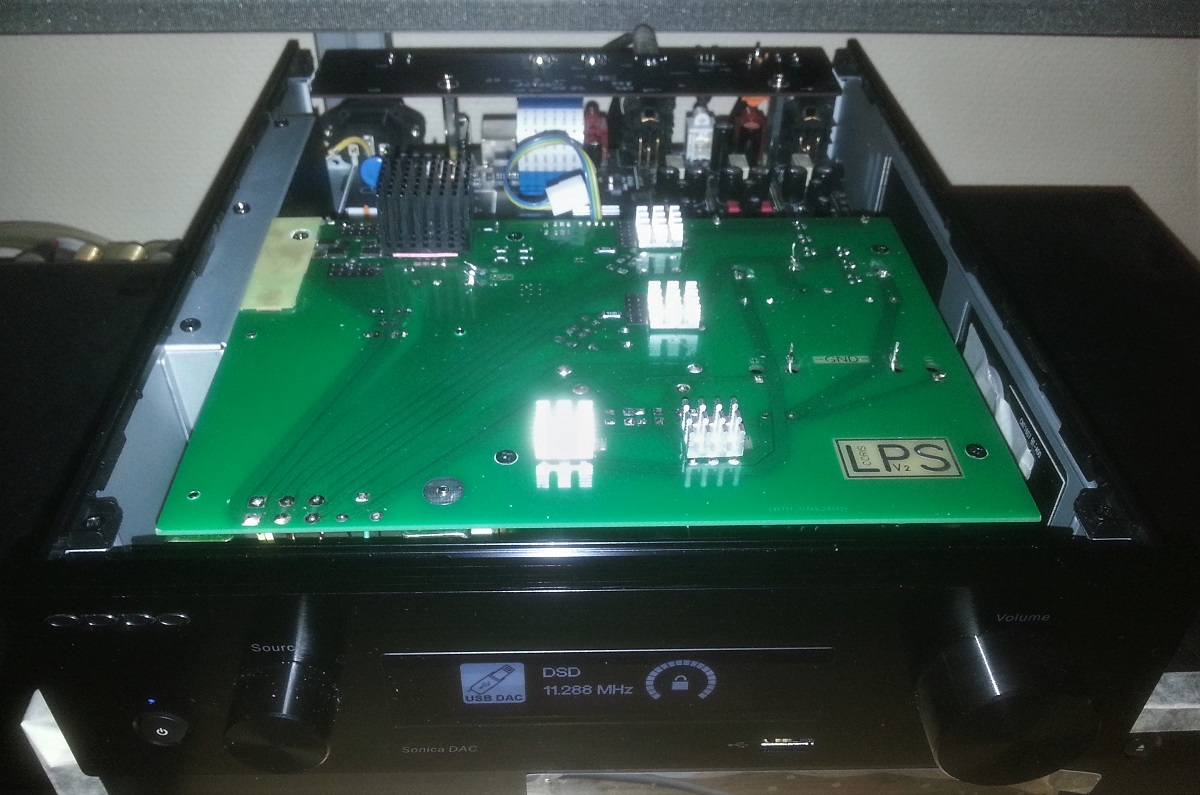

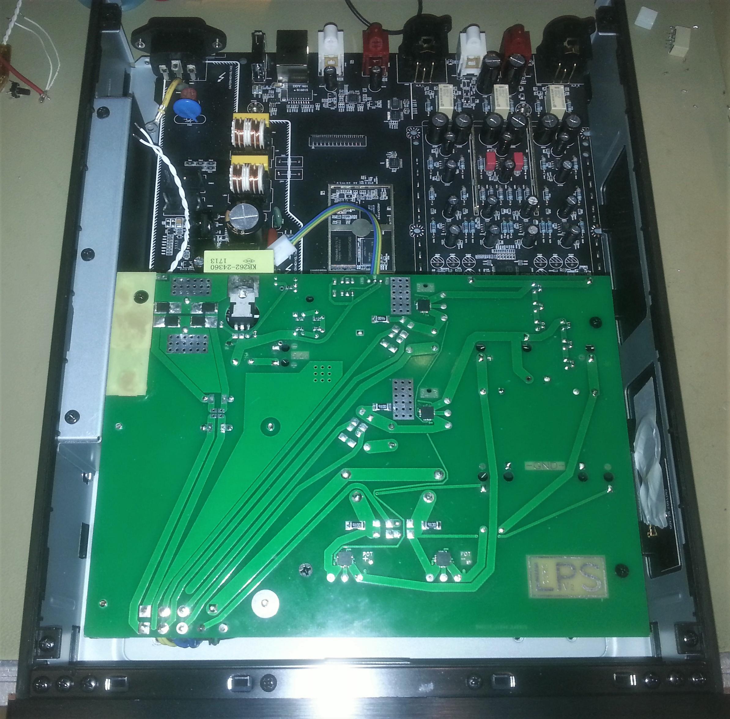

Well, the original power management of Sonica it gave me some serious headaches. The device would not want to accept my LPS. Finally I figured it out.
Now they are working well together. The sound so with only the LPS in place is just exceptional. It will follow now the clock board, and my fully differential output module. The work is ongoing...

As expected, the grounded DAC output channels are not active.
So, for Sonica as well, the SabrePro chip is configured to output only on two channels pairs (XLR/RCA). The only possible improvement in this case is unifying these two channel pairs.

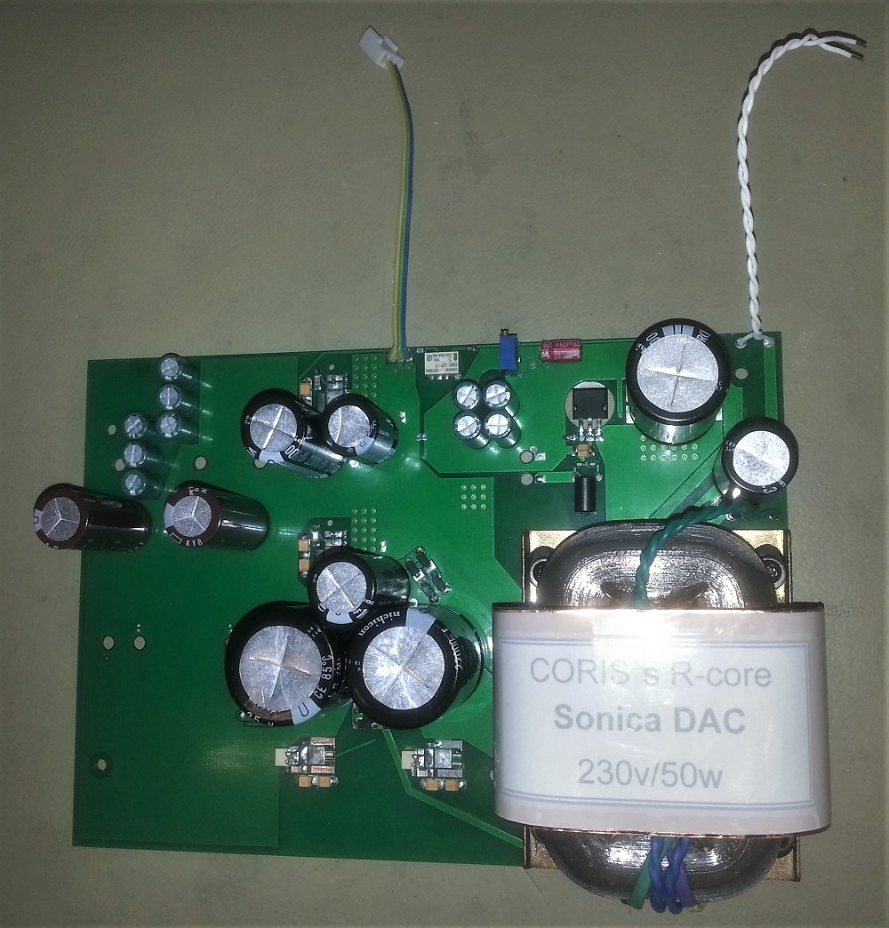

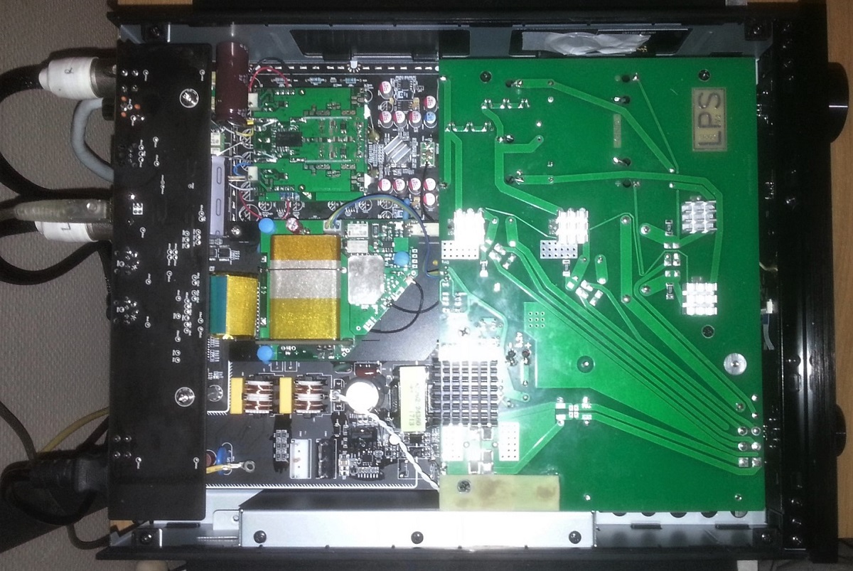

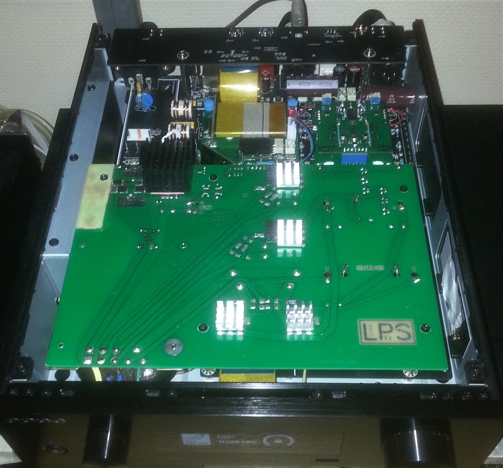

My fully upgraded Sonica...
New and fully linear power supply, clock board battery powered, improved DAC power system, and the fully differential (OPA1632 based) output module for both RCA and XLR out (the two available DAC output pairs are tied together). Also some improvements on USB input board. WiFi/Bluetooth module is dismissed in this device.
New clock system it use two SAW oscillators (54Mhz divided for 27Mhz digital clock, and 100Mhz clock for DAC chip.
Very surprisingly the clock system upgrade it is decisive for the final touch in sound quality improvement. I did it this clock replacement in the end, after all upgrades it were in place. Lifting in sound quality after replacing the DAC oscillator, it is obvious.
How it sound all this? Over all expectations...
P.S. The picture hereby it was taken with the device in function. Therefore are placed the small heatsinks on the LPS regulators. Else, the LPS heatsink it will be the cover of the enclosure (thermal contact by thermal pads).
