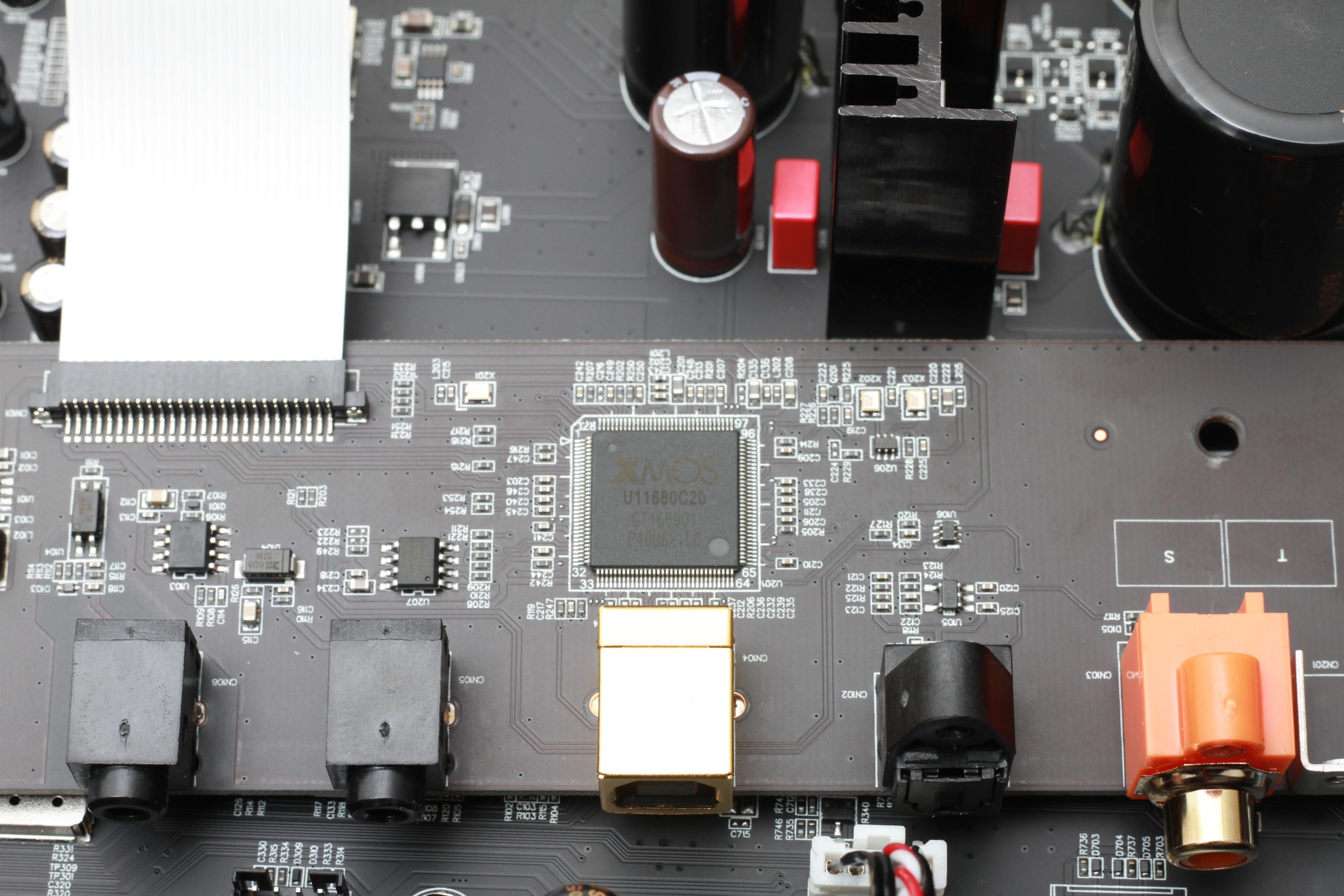

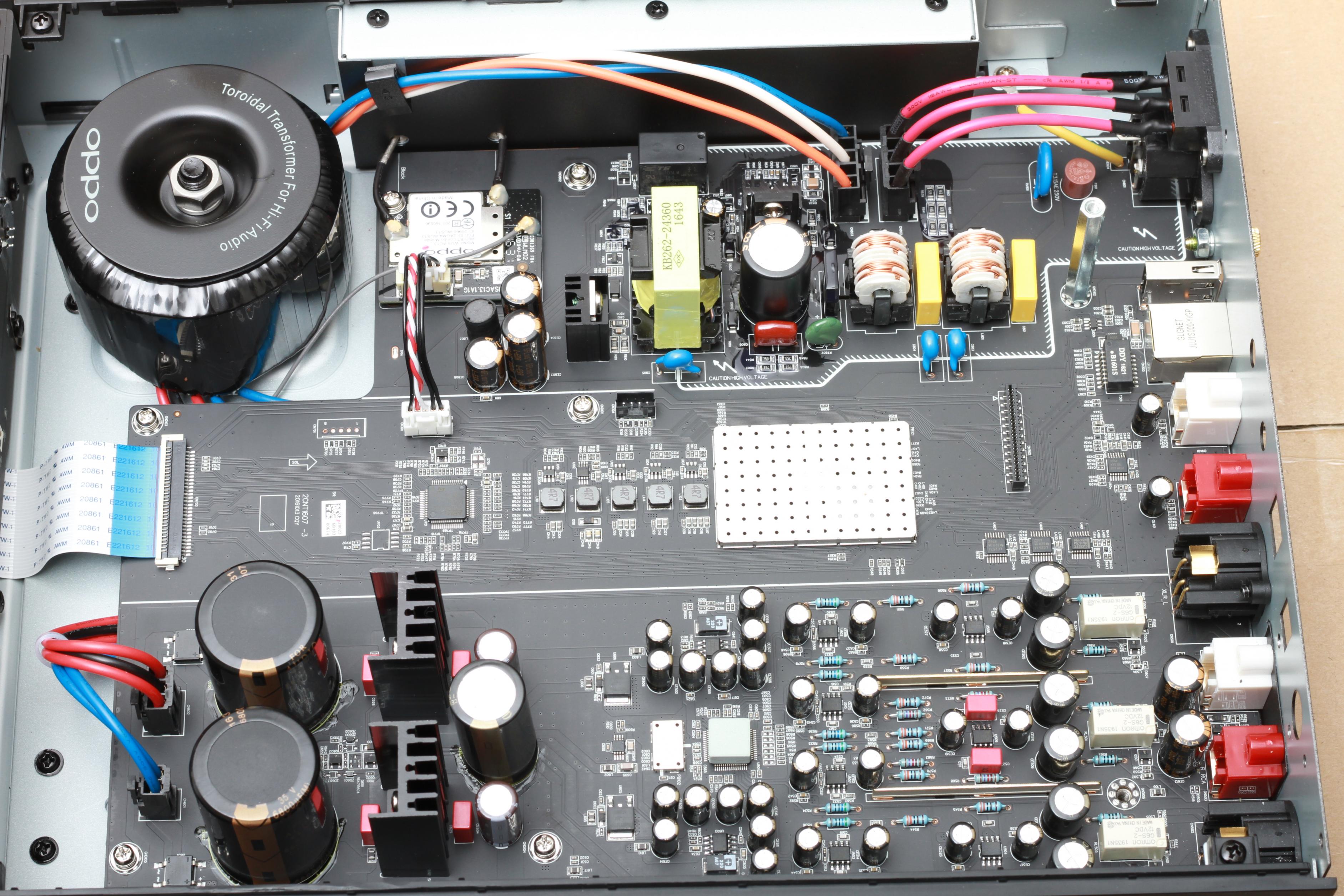

Naked photos of the Oppo Sonica DAC
You've seen the internal photo posted by Oppo. The shipping product has one notable difference: a strange ceramic block atop the ES9038pro dac chip. Also visible are the output traces from the dac to the I/V and output buffers. The balanced sections are on the outside and single-ended in the middle.
Op amps are LM4562 and LME49724. Voltage regulators include LM2940 and 7912 for +/- 12v, 7805 for logic, mp2019, az1117. PCM1808 ADC. 2x df02S rectifier bridges. The third photo shows the Xmos USB receiver.
Full sized images not reduced by diyaudio here: https://drive.google.com/open?id=0B8n6TAaE9yPJVU1JSTNIT1FqbkE

Much appreciated your contribution, with these detailed inside pictures here.
Old approach/design adapted to a new product. Minimal design improvements for the DAC section, as I can see into these pictures, compared with Oppo previous products..
Indeed, what a hack is that on the DAC chip top? It looks to me as a passive device.
Has Oppo adopted in the last time a mystical way of electronic design? A kind of "bybee" device on top of the DAC chip to improve its performances? I should expect a heatsink on the top of the DAC, as a more logical approach, but this ceramic (or whatever material may be) device is very strange indeed...
A DAC chip capable for -140dB dynamics, used into this Sonica, specified for -120dB dynamics, with a mystical ceramic device on its top for improved performances?
This it looks to me quite astonishing as design concept... If this mysterious device is glued well on that chip, it may be a big problem for further (my) modifications in this area...
At least this kind of DAC heat it is hide now the marking on that chip... It is used a 9028Pro instead of 9038Pro, and this it is hidden by using this trick with a such ceramic cover...
I assume Oppo should explain soon what about this "unexplained" and unexpected design "invention"...
