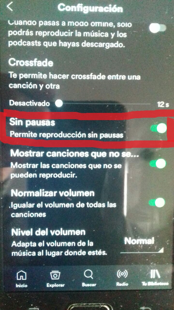

Originally Posted by academia50 :
But I have seen an option to select YES or NO gapless in the smartphone.
Here is, there is no gapless selecting the corresponding option. Plus point for Spotify, point against Tidal.
It seems that the reviewers talk too fast without finding out ...
It is obvious that Oppo did not want to discredit Tidal, clarifying that Spotify has this option, because the two app are in their Sonica application. Ultimately, the development of the Tidal streaming platform is responsible.

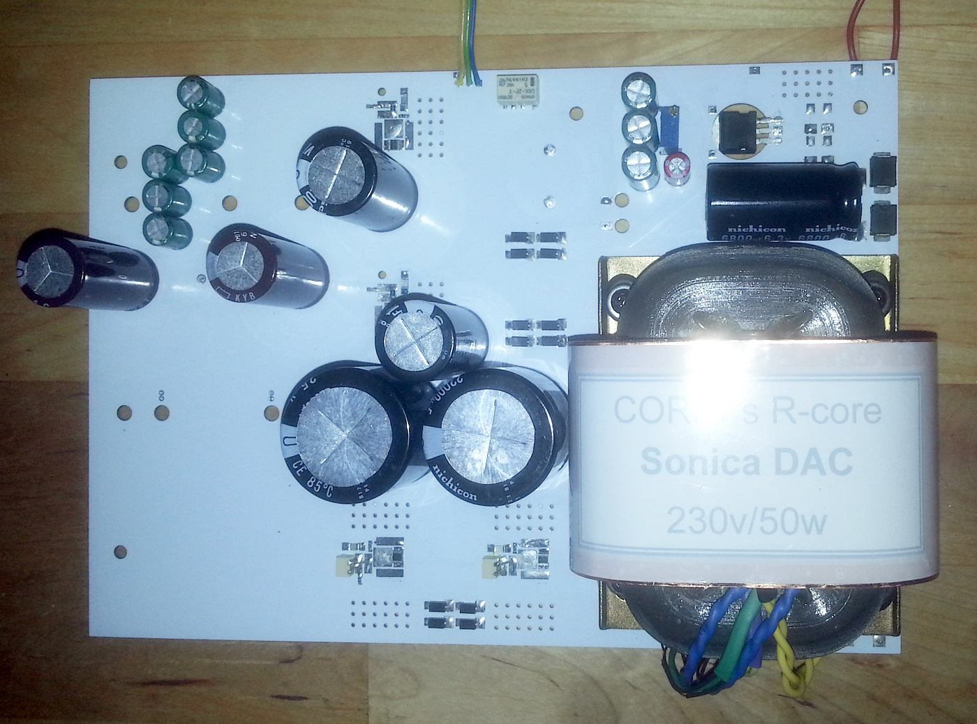

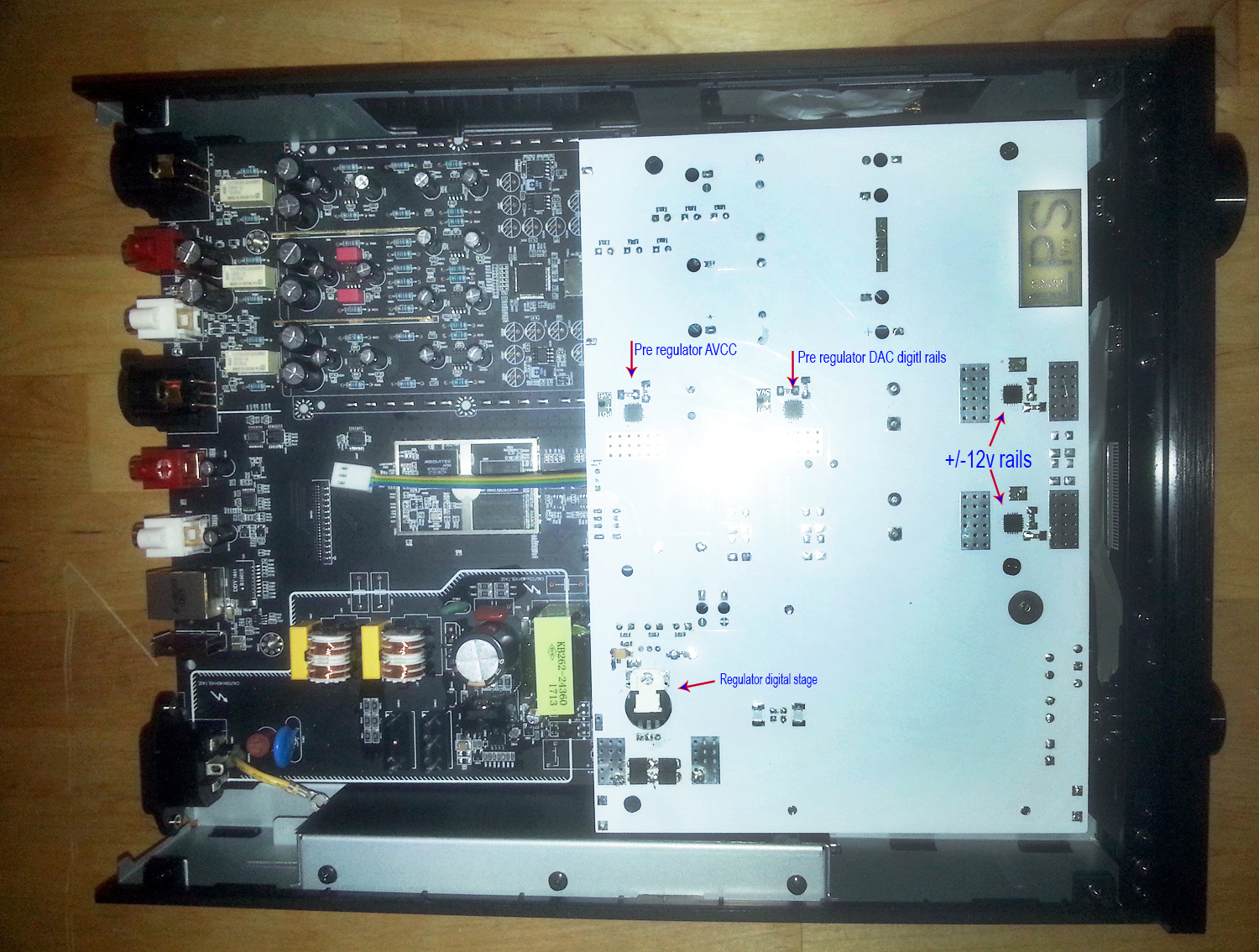

Working on a complete and fully linear PSU for Sonica, based on a single (customised) R core transformer... Of course, inside the enclosure.
Full upgrades for DAC and post DAC circuitry, as well.
What is it that bothers you with the Sonica DAC? What would be the gain after these mods?
From tests done by Archimago (see bottom of this post), Sonica DAC had no PSU issues, jitter was very low, mains hum almost non-existent, right? Also, Sonica has Linear PSU for DAC and surrounding digital & analogue components (I/V, LPF and buffer) and the internal SMPS is used only for BlueTooth, LAN & streaming communication and is pretty well shielded and should not interfere with the LPSU for the DAC.
Why an R-Core transformer would be better than existing toroid? If there is no mains-hum with the toroid installed, with the new R-core some hum might appear because the electromagnetic field of the R-core is larger on the horizontal plane. Also, EM field will bounce back when you close the metallic case and that makes it difficult to predict if an R-core transformer would make things better in any way.
Could you please post some pics with ripple&noise, but also with FFT of existing V+/V- rails? It would be interesting to compare before vs. after.
Also, jitter, THD and SNR measurements done now and after will help a lot.
What do you mean by "Full upgrades for DAC and post DAC circuitry"?
Thank you!
P.S.: I've upgraded myself PSU components and also changed SMPS with LPSU in couple of DAC-devices as well, but I had mains hum (50Hz and it's 2'nd and 3'rd harmonics audible with IEM's) and I also had background noise from the boost converters, probably lower harmonics of the SMPS regulators (between 150-170kHz was the fundamental, so I probably got background noise from 4'th and 5'th harmonics, but also coils noise/EM propagating through the PCB traces)

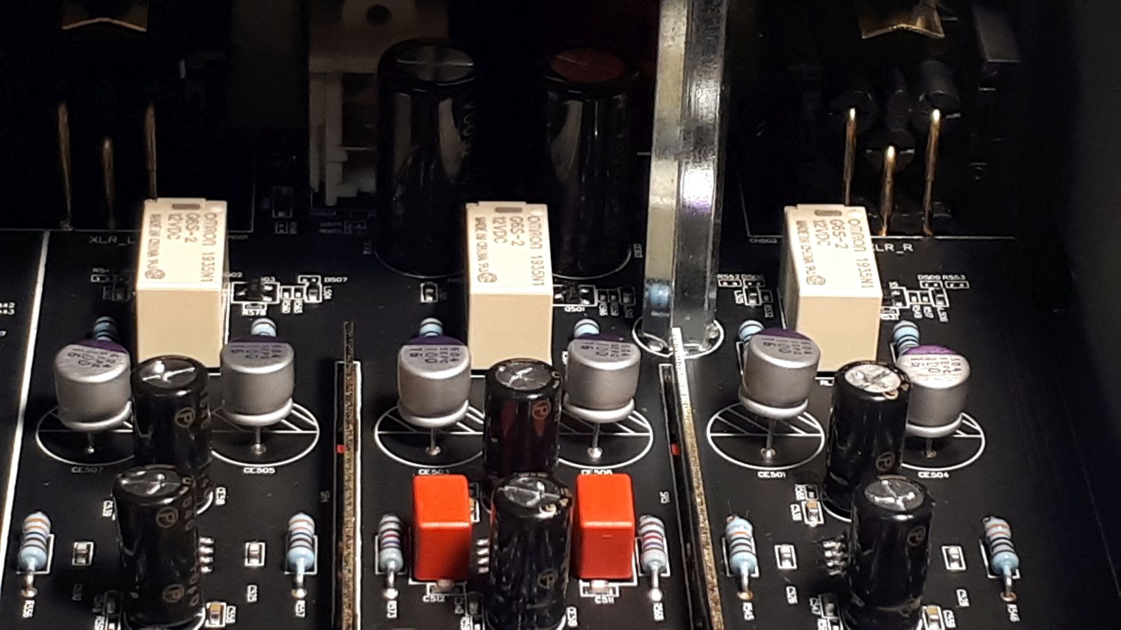

You did right by replacing the AC coupling caps. Even better if those caps are just wired bypassed. If the AC coupling caps should be used, then in my opinion it should be much better using non polarised caps of larger capacity. The bigger the capacity (in the available space limits), the better.

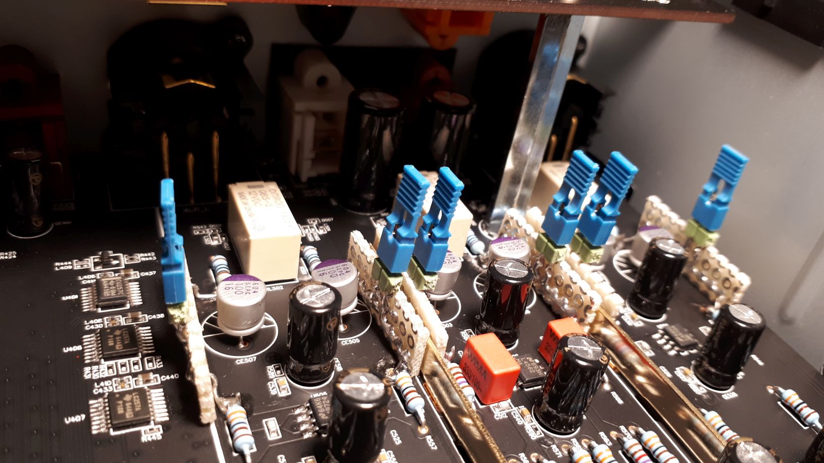

I see in your pictures some jumpers mounted on small test PCBs. Some of these jumpers (and its boards) are very close to the ground connected brackets (brass bars). The metalised holes on both sides of the boards it could come in contact with the brass bars, and ground so something there. Please note about that, and eventually isolate it...
Yes, a 100MHz Crystek CCHD-950 it will be a better solution for DAC clock. You can adapt its mounting somehow over the original one can. Cut the power trace to the original oscillator and connect it to the Crystek. The same for the output/input clock signal.
As I mentioned above, I am now very close to finish my fully linear PSU for Sonica. All regulators related to analogue stage are TPS7A, solid filtering caps, integrated DC blocking filter, and an R core customised transformer. Heat dissipation through the upper cover of the chassis.

Well, Sonica it get now and finally a fully linear power supply.
The LPS is powered by an R core transformer, where the high current winding, powering the digital section, is double EMI shielded and grounded. The whole transformer is also shielded. Supplementary HF filtering is implemented on board, minimised so the digital noises to be induced into the analogue system. The regulators for DAC and analogue power rails are TPS7A. Large filtering capacities are on LPS board (as usual for my design). A power section is also reserved to the clock board and its battery charger. There is also integrated on board the DC blocking filter. The original main AC filter included on SMPS section it will be used for LPS, as it is very good so as it is on original design. The device power system it still be protected by original fuse on board.
The LPS board it may looks quite large for the regulators dimensions, as for the circuits necessary areas, but this is because mechanical and mounting reasons. The original power components are fully removed from the Sonica board, and substituted by the components on LPS itself. The heat generating is quite low, the cooling is passive and it is ensured by thermal contact with the upper cover.
Unfortunately, this LPS board it have to be redesigned, and fabricated again, as many improvement solutions I have found it under assembling and testing processes. The concept it still mainly be as pictured bellow.
