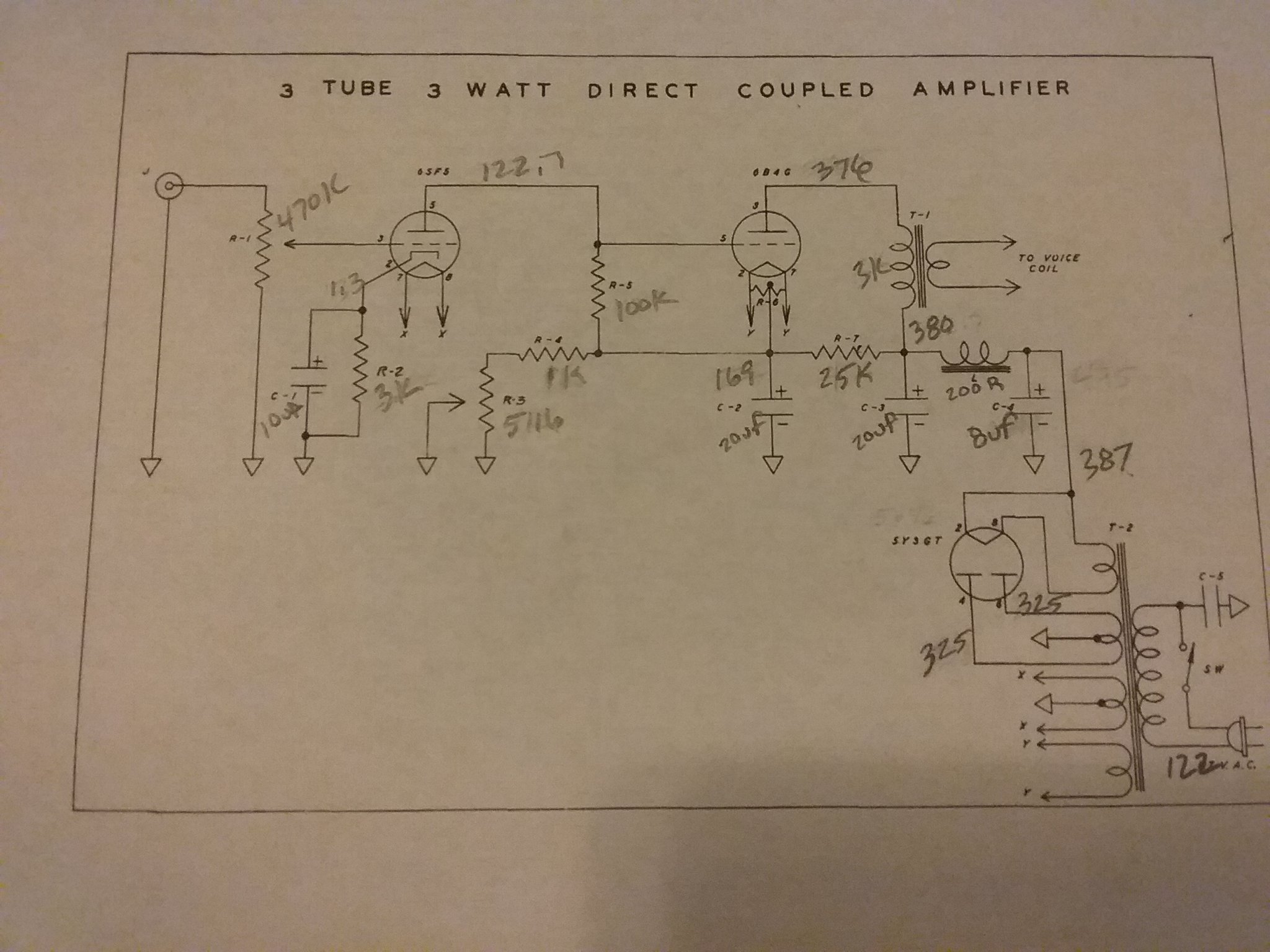

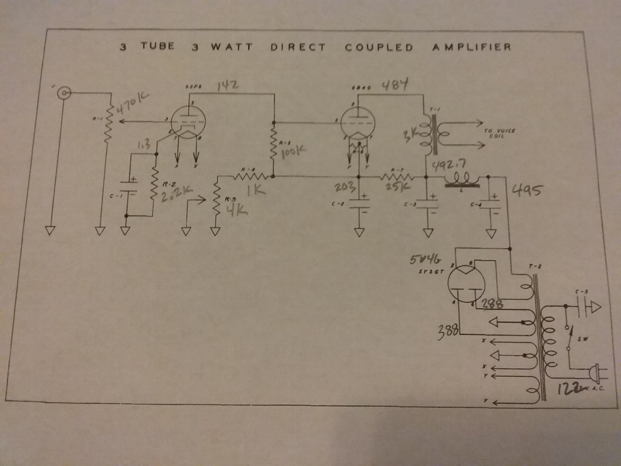

Yes, I reverse engineered a Don Garber amp, generating this schematic, and found it matched with Lipman. FYI - I recently painted a chassis which will be used to build my version of this classic.
Yes, the 25K Mills resistor marked R7 is not an appropriate plate load for the 6SF5. That load is 100K in Lipman, 150K in the Shishido.The drawn schematic doesn't.
Lipman's R7 is 25K/10W and goes to B+, not to the 6SF5. That's a more likely place for a Mills!

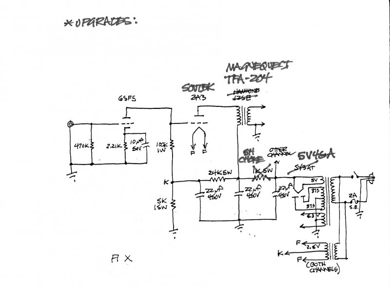

Oh yeah, looks like a drawing error, is supposed to be B+ not gnd at the bottom there.The drawn schematic doesn't.
My fault! I knew I should have thought about the wording a little more but wasn't sure how to do it without it getting cumbersome and I was in a hurry.
I meant the difference between the drawing you posted and the Lipman. R-5 in Lipman's is in the same position as R7 in yours. R-7 in Lipman's doesn't have an equivalent in yours, making it (in my amateurish view) fundamentally different. My thinking is that if yours is a part for part representation of the Fi then the Fi isn't a Lipman.

I do think the multi-tapped resistor across the power supply is the most distinctive feature. The Lipman circuit abandons three of the taps (large driver cathode resistor with negative supply, screen voltage tap, and driver B+ greater than cathode voltage for a higher plate load) so it's not really the same thing. Only the tap to the 2A3 cathode remains.
That resistor chain does improve the stability of bias points as the tubes age, or are replaced with similar-but-different tubes. This has always been the issue with direct coupling. It was a very clever idea at the time. But it wastes power - today we do it with trimmers and servo circuits.

I'm now at the point on the list where I'm going to work on the Lipman/Garber direct-coupled circuit using the parts I have to hand. That means the power supply caps will have different values than the 20uF units in the original schemo, but it shouldn't affect the voltage. I've been playing around with the circuit and operating points in LTSpice and learning a lot.

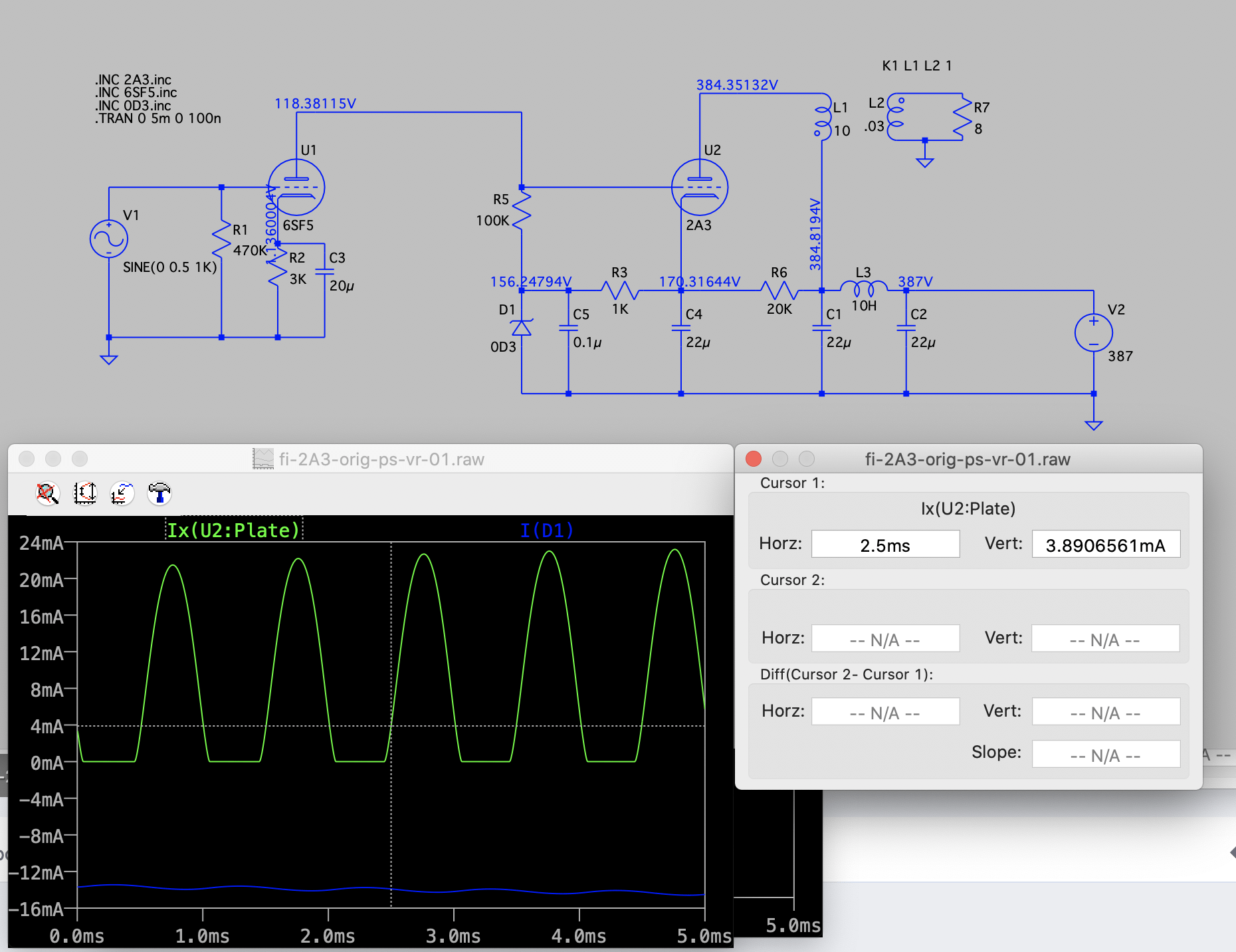

The Lipman circuit uses a PT with an HT winding of 325-0-325 into a 5Y3GT, single channel. In LTSpice, at voltages I guesstimate to be in the range of 650Vct into a 5Y3GT, it's really hard to get the 45V across the 100K input plate load/output grid leak resistor without excessively high current in the 2A3. But with a B+ of say 365V or 385V, the dissipation wattage is within a reasonable limit of the resistors spec'd in Lipman.
On the other hand, when we raise the voltage higher to what has been speculated in this thread to be the ~450V B+ of Garber's circuit, the dissipation is so high (about 8-9W on the variable resistor, for instance), the spec'd parts don't really leave enough headroom to prevent running at very high temperatures (I don't like that).
So, I'm going to breadboard the original Lipman circuit with one channel, into a dummy load instead of a speaker, and take voltage measurements as a starting point. I have a PT with a 660Vct winding, which is a bit high. My wall voltage tends to sit at 123V these days. So, if I use the 125V leads on the PT primary instead of the 120V leads, that's:
That 6 hundredth of a volt is a little hairy, but for a DIYer that should be close enough to the original.
I'm calculating this based on the notion that PT windings relate to one another in a fixed ratio. If anyone sees a problem with it, speak now or forever hold your peace. 😆

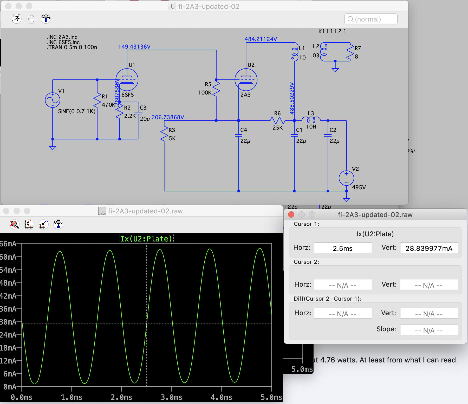

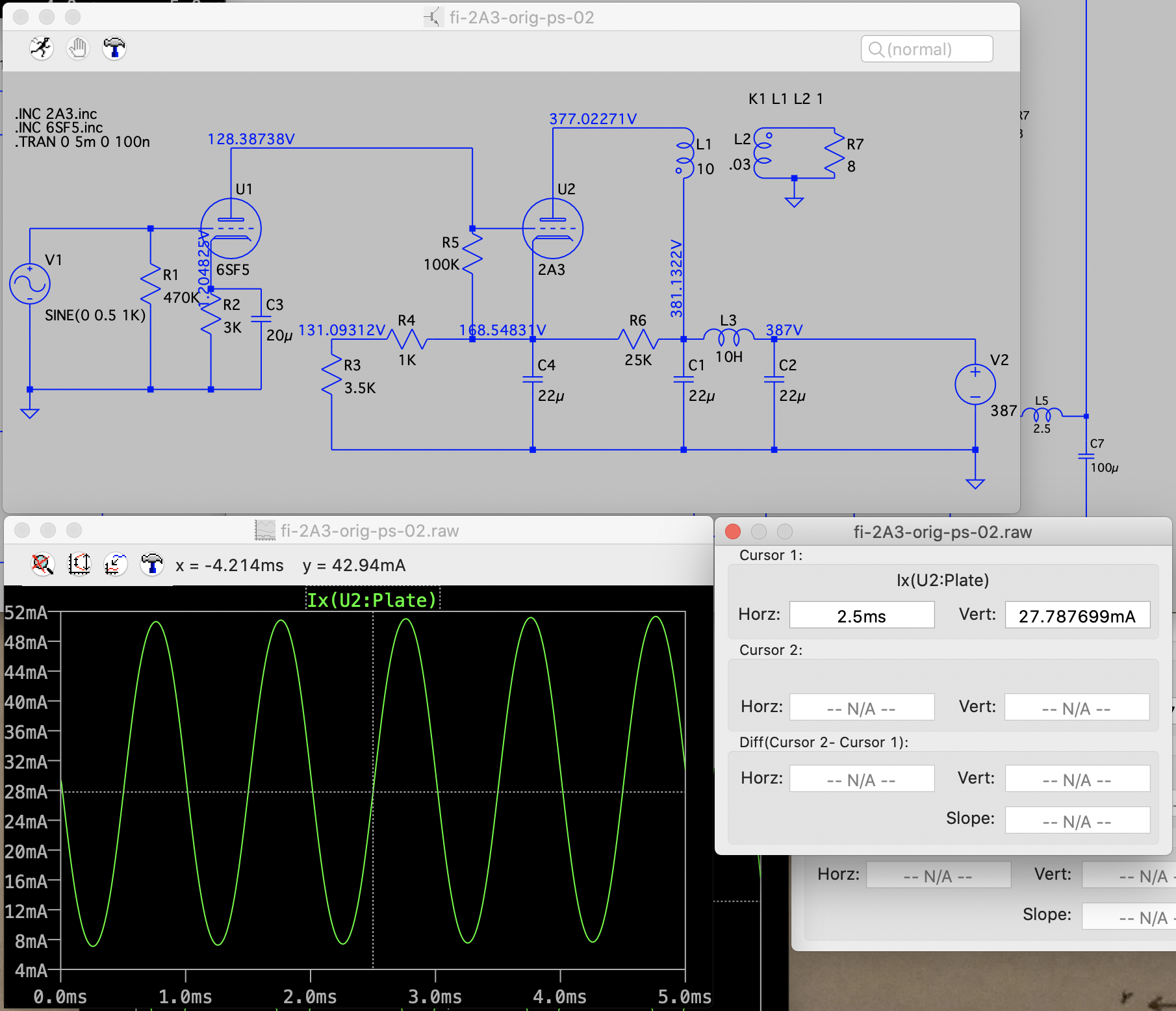

Gee, thanks! Super helpful! So, in post #33 you build the "updated" schematic that Garber had given to a customer, and which is available online (and attached here). Where you have 1K->4K in the bias set network, Garber has a single 5K resistor. According to your voltages, that 5K is dissipating 203V / 5K = 40.6mA ^2 * 5K = 8.24 watts. How's the heat on the resistors there? A single 5K 25W resistor would be only 3x the dissipation. And you've got 61V across the 100K resistor.These were the numbers when I built it exactly to that schematic.
When I model your "Updated" schematic in LTSPice, it shows the 2A3 running at about 278V/28mA.
In the original schematic, where you measure 169V on the 2A3 cathode, the bias network is dissipating about 4.76 watts. At least from what I can read. Your variable resistor at R3 is set to the full 5K, correct?
In the original Lipman circuit, I can sort of get close to your measurements in LTSpice with 3.5K on the variable resistor in the bias network. 2A3 is at about 208V/20mA (you measure 207V).
I'm struck by how both these designs run the 2A3 with much lower current than we tend to do today. One case runs it at much higher plate-cathode voltage, and the other much lower.
What were your impressions of the sound quality (if any) in the two circuits?
Thanks again for sharing. This is so fun to think about.
OK, so I started thinking about using the various PTs and rectifier tubes that I have lying around, in order to try and make the voltages in Old Big's schemos. Re: the original Lipman, I speculated about using a 400Vct transformer with a choke-input 83 rectifier in each channel. That probably wouldn't produce high enough voltages. But nonetheless, the idea of a nice glowy gas rectifier tube made me wonder if it's possible to use something like a 0D3 to regulate the bias network.
The 2A3 in this LTSpice model certainly didn't like that (4mA plate current and clipping galore), but anyway it's fun to speculate about. I tried to produce the voltages in Old Big's measurement to model the behavior. 😆

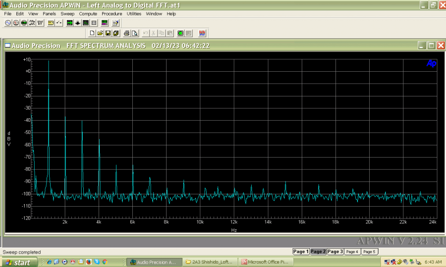

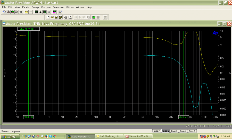

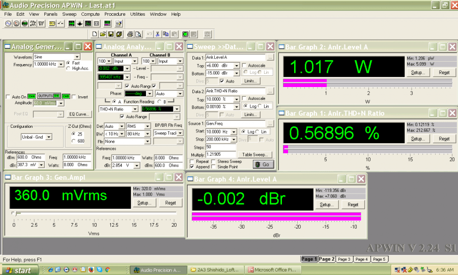

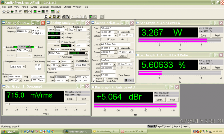

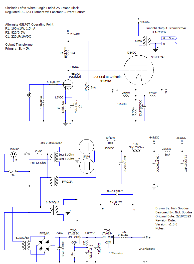

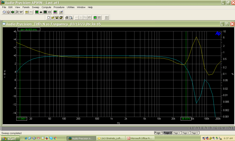

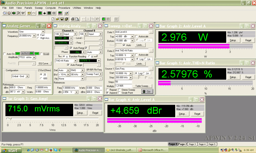

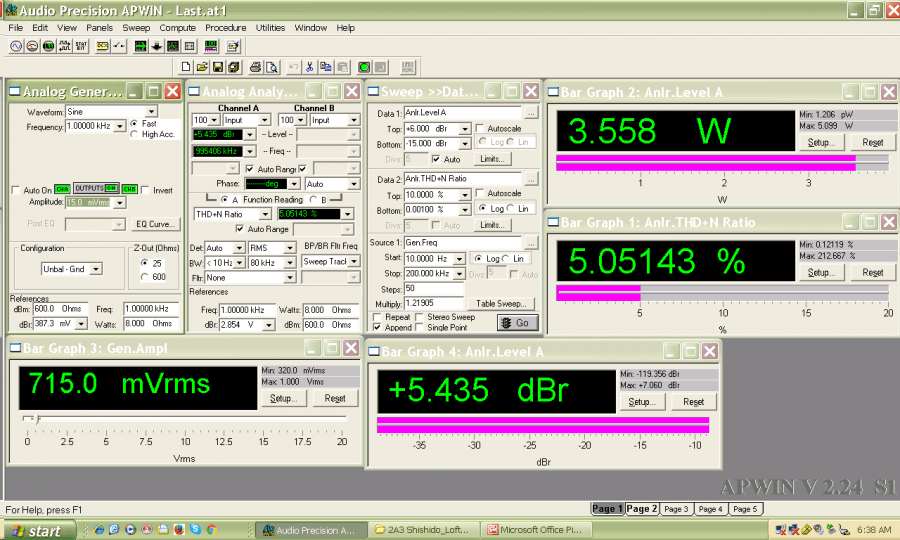

I built the Shishido version and it is very stable regarding operating voltages. The voltage divider (22k & 3k) resistors help lessen the stress at start-up and provide a reference for the 2A3 bias voltage. Of all the direct-coupled circuits I have seen, this one makes the most sense and probably has the most stability. The Robin & Lipman circuit (Garber) looks stable too, but it's just configured differently.
I used a surplus power transformer, but many will work with a secondary voltage of 350-0-350 or 375-0-375 @ 100mA (mono) or 200mA stereo. If you need to lower B+ add a power resistor directly after the rectifier before the first capacitor.
I initially used a Lundahl output transformer, but have since put in a Hammond 1627SE. Both sound great and the Hammond has better low-end which is good for my three-way horn speaker that is >100dB efficient.
Loftin-White_Shishido SE 2A3 Mono Direct Coupled_v1.1.0_021223.png23.8 KB · Views: 278

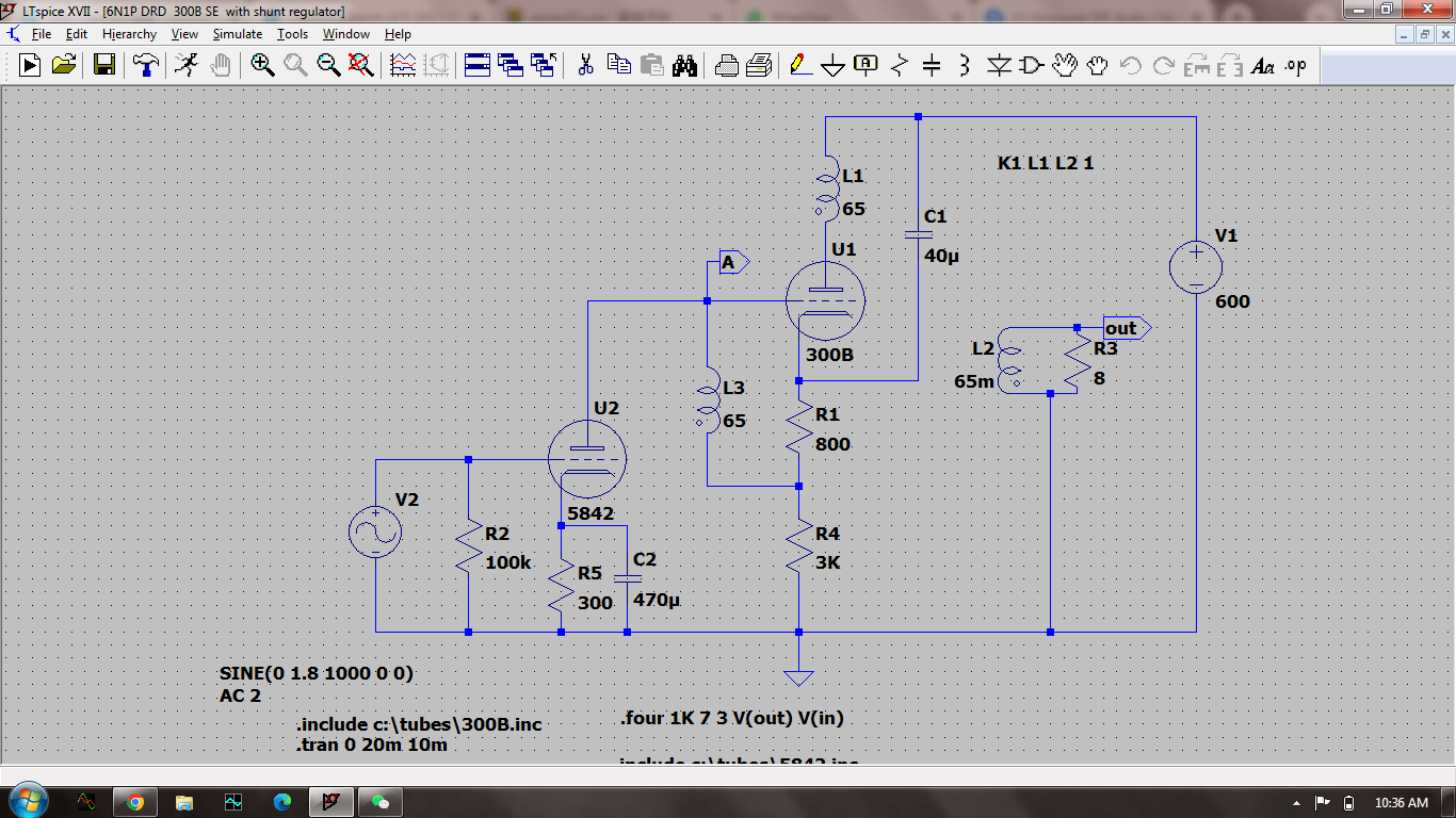

The attached direct coupled 300B should have better performance. Using the plate choke would provide more clean signal driving the 300B. Also, the circuit is fail safe for the 300B in case the driver tube fails or loose from circuit.
The circuit can be easily modified the 300B to 2A3.
