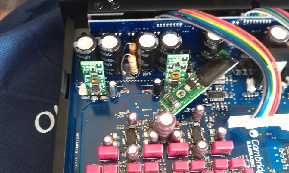

Now I have replaced the 15-volt regulators with Dexa/NewClassD.
See attached pictures.

Nice work...
what about temperature ? are those Dexa regs working good without heat sinking ? Can you be more explicit about sound impressions...

The dexa-regs are on the heatsink, see the pic when they are fully connected and the blue light is on.
No heat-issues so far.

I just replaced the U404 5v regulator. the one where Rajapruk uses a burson.
I use the newclassd dexa regulator:

Just plugged it in last night. So as Rajapruk, it still needs time to burn in. But my initial experience is still very good.
The changes are small but noticeable. the Dac has become better in all aspects.
Deep bas is more deep and calm. middlebas i more firm and quick, really gives you a smack, when present on recordings. Midrange seems more calm and a little more defined. But most important change has been on the treble, where I can surely hear that, there is a lot less sibilance. The treble now seems more far-stretched, and nice to listen to, even when I put on recordings that I know to be slightly anoying in the treble. Now they are far more likeable.

I don't use Burson, I use Belleson 🙂
I think I hear much more ambient sounds after 15volt change, but I want to evaluate more, before giving my statement.
I will give sound-impresions after a week or so, when everything is burnt in.

Yes it is dc-coupled. The output-caps are shorted on the backside.

Dexa fits on the heatsink, no problem fittin them in the box.
