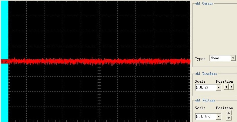

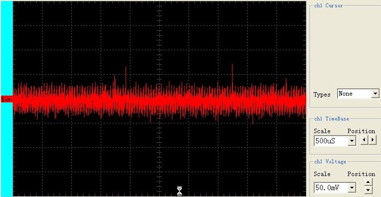

Would it be possible to improve the digital PSU by introducing a gyrator circuit after U12 (MC34063) ?
If not, what other options you would consider to reduce the switching noise from U12 on to the digital power supply ?
For powering X1 quartz crystal, even a simple cap multiplier with 2 transistors will be a great improvement over stock power supply.
Ferrite bead FB5 should be removed and new 5V power supply (only for quartz crystal) connected to X1. Most important thing for this new power supply is low noise. Low noise at 1 Mhz is not important, important is low 1/f noise.
Capacitor C32 can stay and a bigger elcap (47uF or 100uF) must be added. And a smaller cap (SMD, 10nF, size 0603) is a must.
Improvement is measurable with scope and improvement is also audible. More details, more 3D sound.
Happy modding :nod:
Look at the Scale (lower right corner) on pictures. Both measurements taken at X1 power supply pins, before and after.
