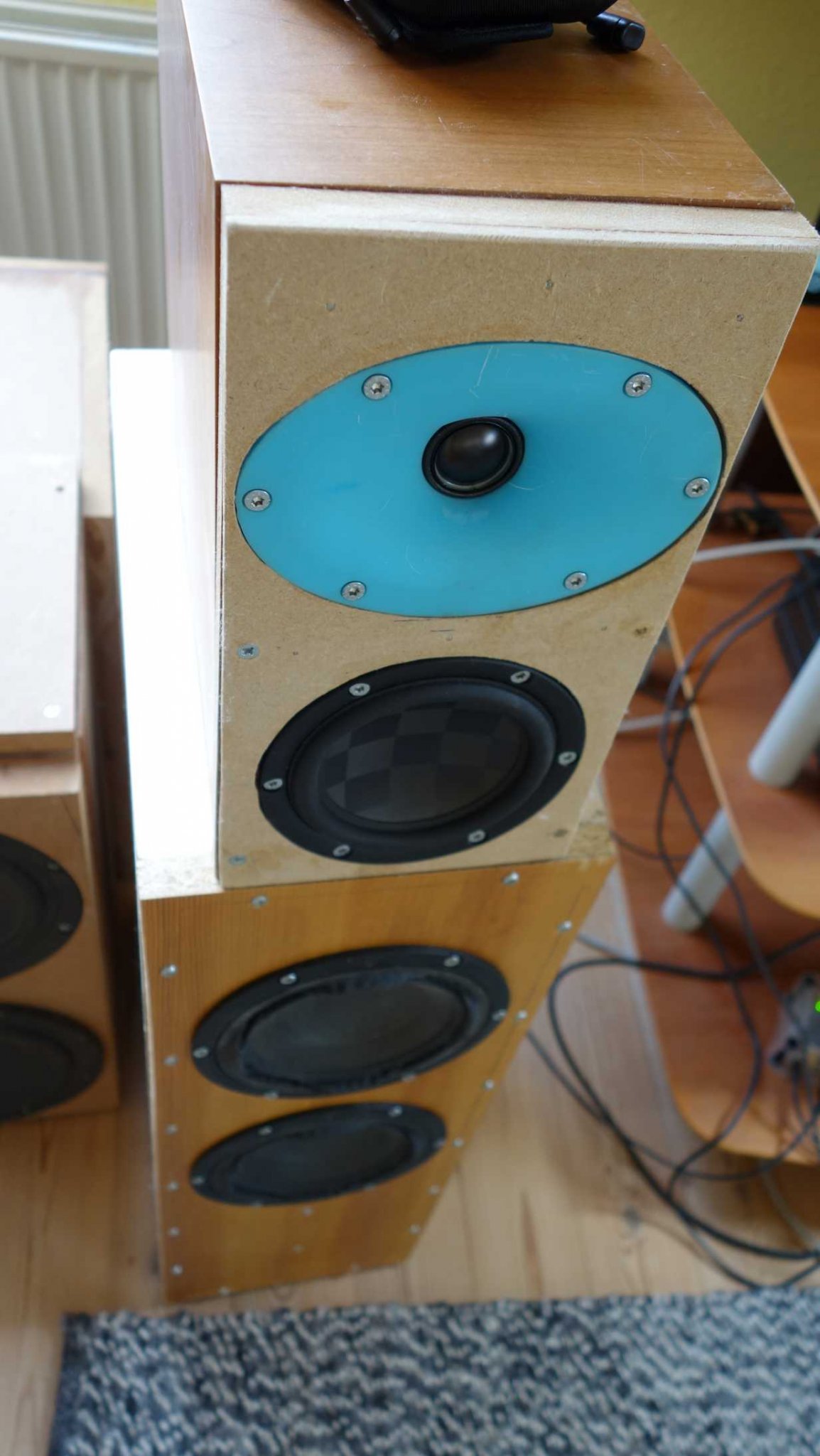

Just made a quick box to test the 5" waveguide with a SB26ADC - works really well.
Sound seems much more clear than my Seas DXT - even though both measurements are very smooth and even. The ADC seems to need way less EQ to work well.... which might give a hint. Awesome work you did with the waveguide - donated 👍😀

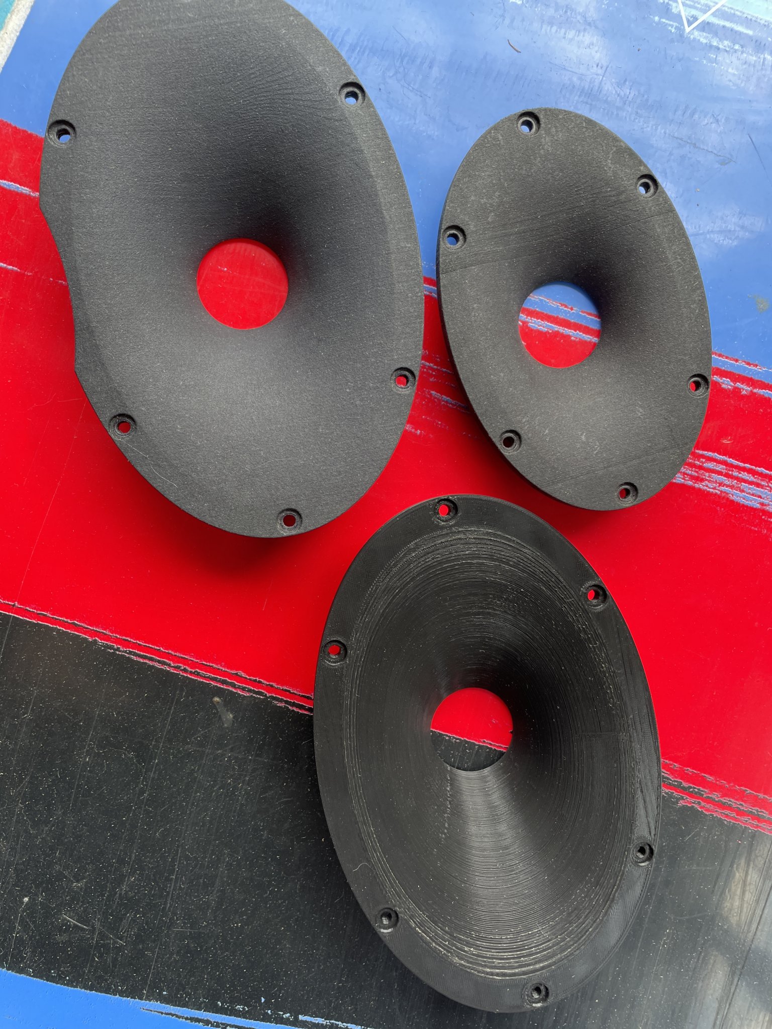

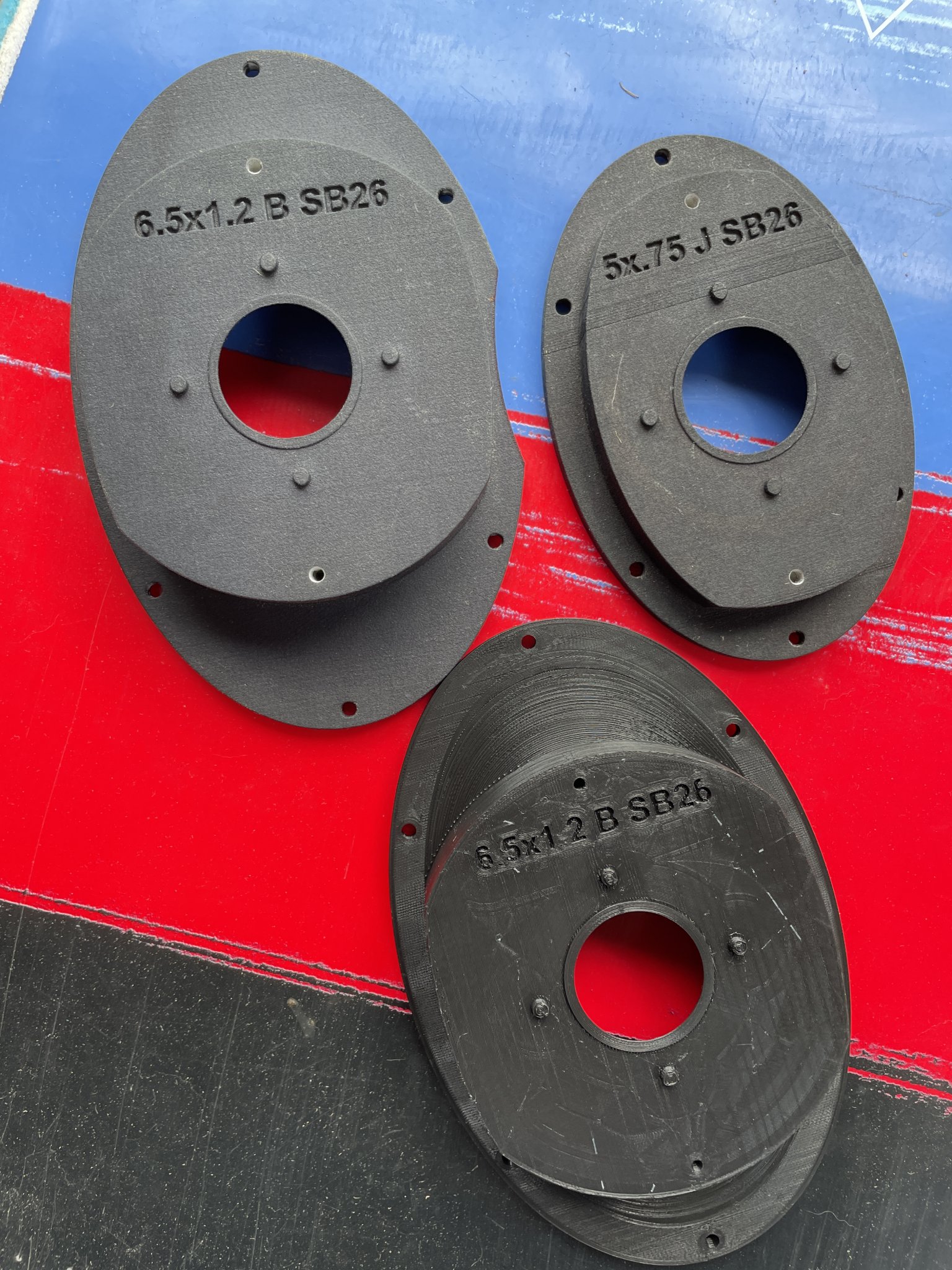

I would be curious to hear from the experienced 3d printer operators: recommended number of perimeters, top and bottom layers, and infill settings. Presumably the waveguides are printed face down with supports?Thanks for the great walkthrough! I really have nothing to add to that. I will say I'm no 3D-printing guru, so I have no idea on infill. Do you have pics of your 8"? Mine are the same quality as any of the little ones, I'm pretty impressed with my Ender 3 Pro. When I do an actual speaker though, I'll probably have it done commercially in SLS nylon.

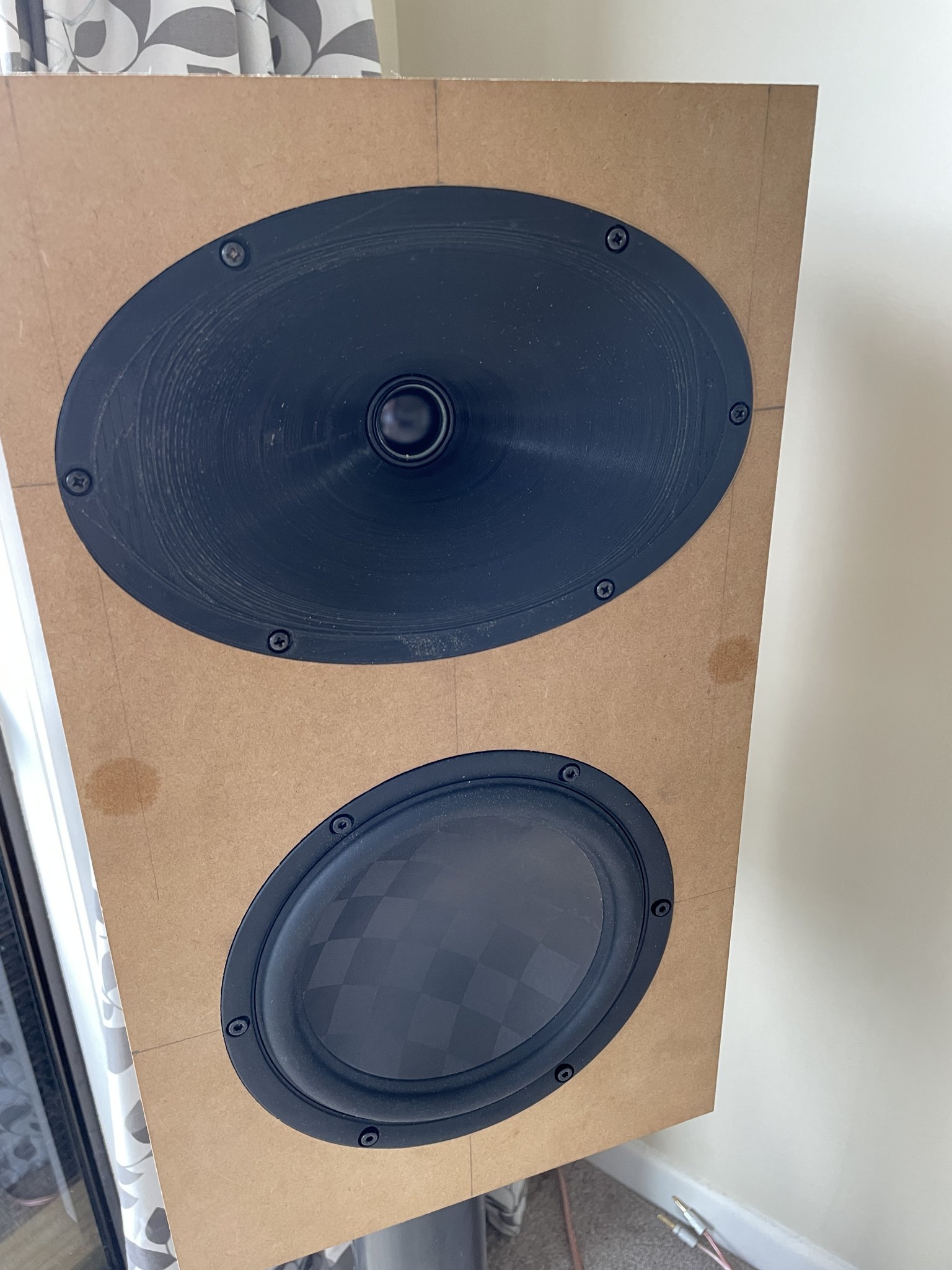

Speaking of a real speaker, I'm making a test cabinet to do some research on edges before I start final designs on a family of speakers. This gave me a chance tonight to try my routing template. Worked as expected, so I'll get them posted on the website soon. This will require changing all of the waveguides a bit, so if you are relying on using the routing template, I would hold off on downloading any waveguide files right now. You'll know when you can download them when the template files are available, and I always have a revision log at the top of every page where I note updates.
I tried using double-sided tape to hold the template in place, but it didn't stick well. I ended up using a finish nailer to attach. I thought about integrating screw holes into the design, but I like that the finish nail leaves a tiny mark that is easy to fill. Any other ideas for attaching them before I do a final template design?

That will leave a poor finish on the important side where the supports have to be removed.Presumably the waveguides are printed face down with supports?
Cubic subdivision or similar from 20% upwards makes quite solid parts, gyroid is ideal if you want to fill the voids with resin, the resin can find it's way through but many resins get hot when curing.
I use 4 layers on all the perimeters. You could probably reduce the sides to 3 or 2, but the top needed 4 to make sure the infill was not exposed on the curved face of the waveguide. Print face up, you don't want supports marring the business end of the waveguide.
