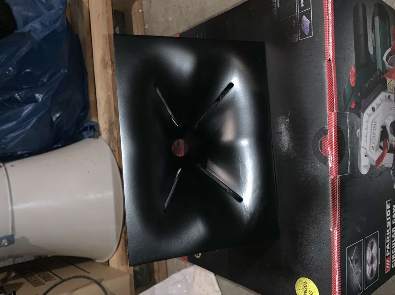

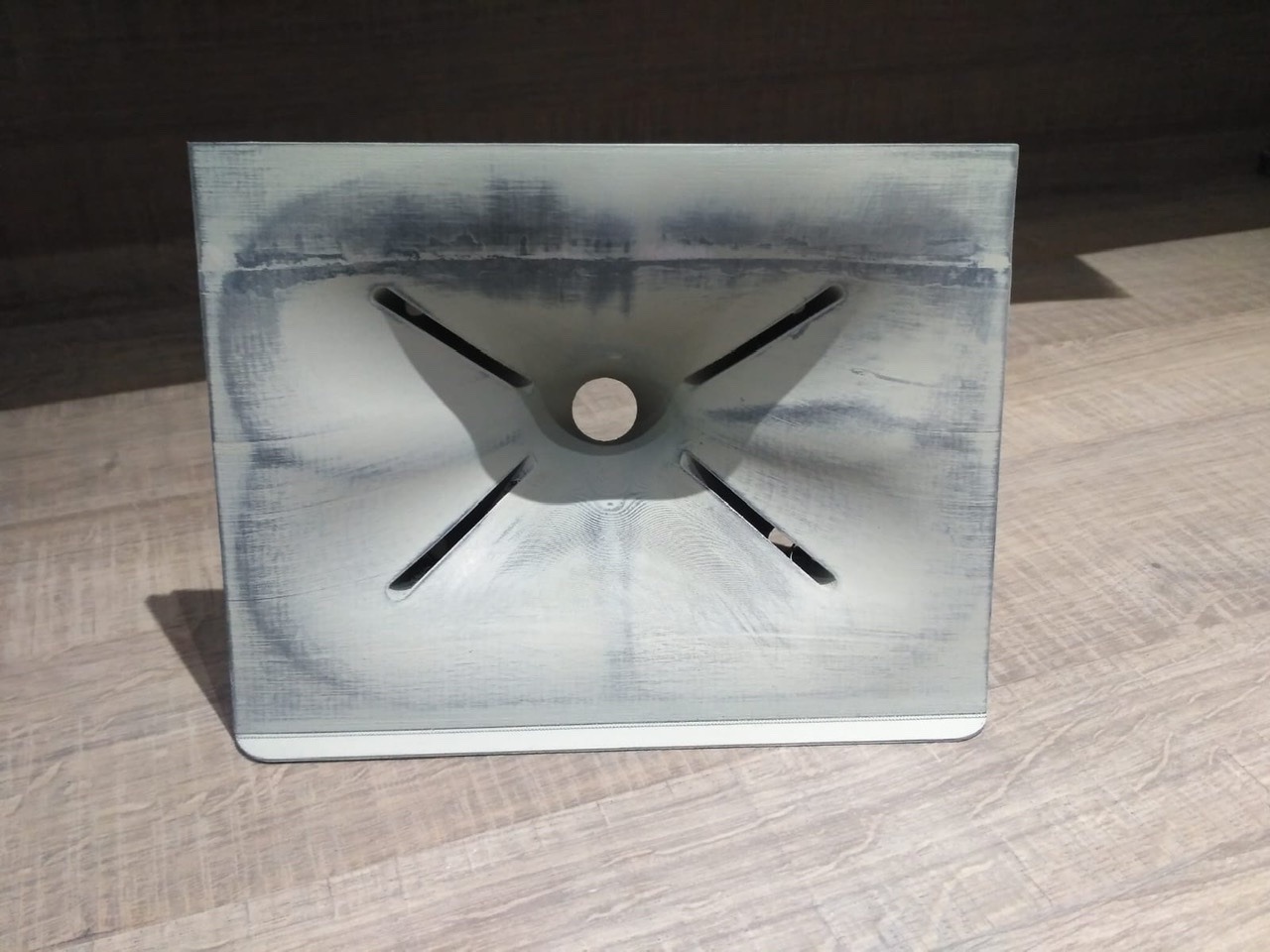

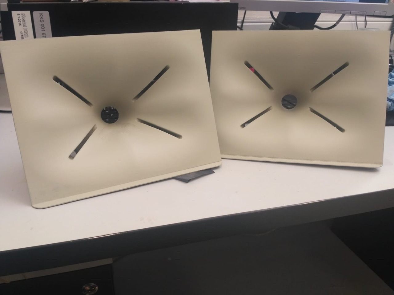

Is it possible to do some surface treatment on the waveguide?
What's best recommendation on how to treat the surface? Just sandpaper? Can it be spray painted?

For my PETG waveguides I used Revell Plasto. Also, acrylic based wood putty works as well. If the print is good, then spray on putty is enough. After sanding, just a few layers of acrylic spray.
Those look good. Has anyone measured an effect of a raw layered print vs a smoothed finished print or even heard a difference?
That is something I need to look into more. What I can say, is that at one point I went from SLS nylon printing with its sandpaper finish, to PLA printing with a layered finish, and the waveguide that had been printed both ways measured the same. Sample size of one, but that was reassuring.

Sanding them and spraying with (car) bumper spray can give them a nice look as well.
Something like Rust-Oleum or other texture sprays will probably also work.
The sanding part is just always pretty tedious, or you need to print with a 3D resin printer.
Which has also its disadvantages.

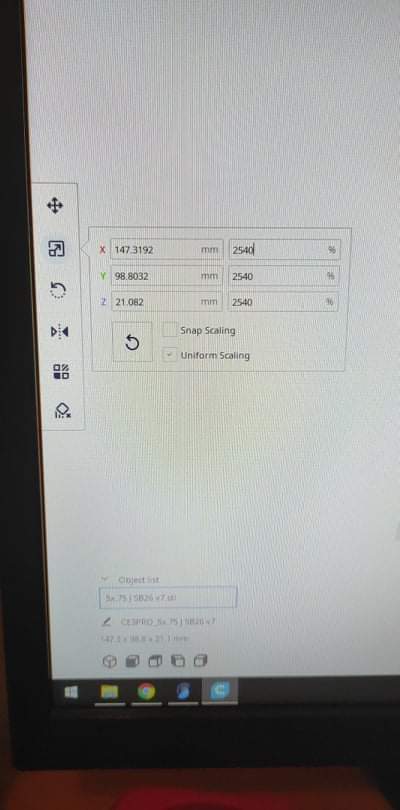

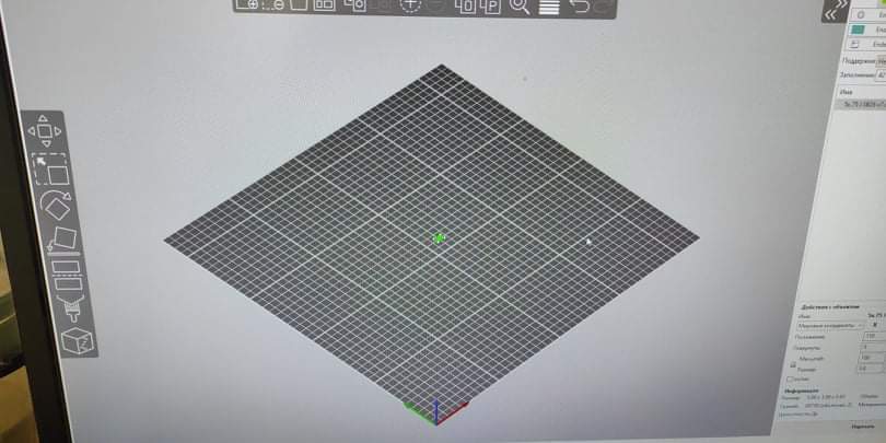

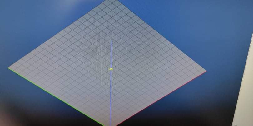

Hello friends,
I downloaded the sb26 5inch waveguide and gave the file to a friend with 3d printer but he told me that the printing preview shows a very small waveguide, dimensions are 5.8 Χ 3.89 Χ 0.83 mm which are obviously tiny.
The programs used are superslicer, cura and slic3r but all of them give the same tiny item.

Dimensions are in inches. You have to multiply everything by 25,4 to get milimiters., or scale it to 25,4xHello friends,

Correct, and it will properly fit your tweeter.So, if i scale it 25,4 it will be correct? No artifacts?
Looks correct. Is there not something in the slicer to set the units? That would be easier.

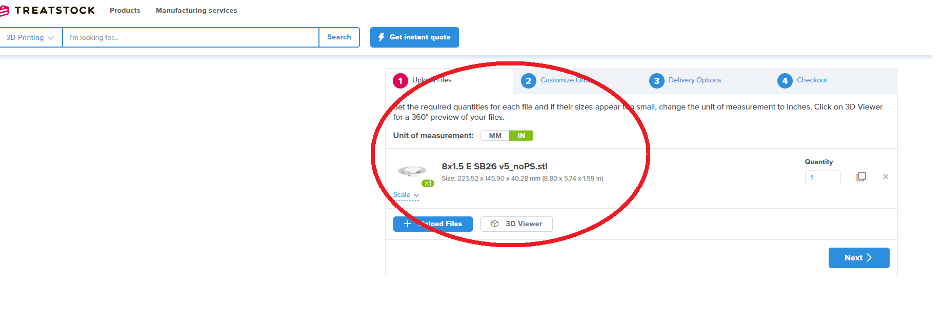

So here's what you do, for a 3D printed, PLA (should be sufficient for most users) waveguide. Choose SLS if you want to pay more for a stronger, nicer finish. Pics of a nice SLS are up at Brandons website under the SB26 link - made from xometry.com
1) download you .stl model that you want from augerpros website www.somasonus.net/waveguides
2) go to https://www.treatstock.com/ or www.xometry.com or https://i.materialise.com/en then;
3) upload your model.
4) For the love of god CHANGE THE UNIT OF MEASURE TO INCHES, no one seems to get this part. The website should then display the completed model size in both inches and mm.
5) (treatstock only) then ensure you have your location selected correctly and set the plastic to PLA and black (or any colour of your choosing). I think the infill requirements are computer estimated based on the model but augerpro is probably more qualified to choose the right infill. In my case the 3d printing company chose the infill. It will display a list of local 3D printers to you that can perform the print and deliver to you.
5) (xometry only) select the plastic, colour and finish of the waveguides, confirm order and pay.
5) i.materialise I have not used so I cannot help, but I imagine its not too different to xometry.
6) complete your order, the chosen manufacturer will que the project and deliver when finished. No, you cannot get 3d prints same day/overnight, noone can without access to their own printer
7) donate to augerpro on his website via the gofundme link on the waveguides page. I have, as he is deserving for the community service.
If you are not computer literate, ask for help from a younger to perform this downloading/uploading for you.
As far as I know, other than CNC machining, this is the only way possible of getting these waveguides, short of having your own or a friends 3d printer to do it. It is how I do it, and I now have a 5", 6.5" and 8" waveguide pairs printed for the SB26 from a local 3D printer to me here in Auckland. He has been very facilitating.
Best of luck. No responsibility taken for crappy prints. My 8" ones were.. okay. They will vary from mfr to mfr, printer to printer.
