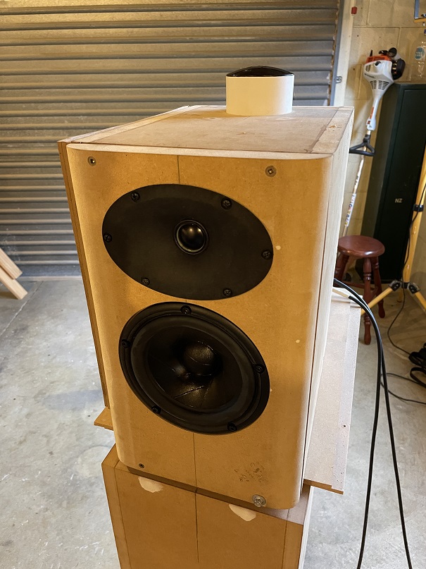

Just bought a pair of SB26ADC to try this out. Playing on a set of Seas DXT right now, which require a rather narrow baffle to play good.
Does the 4" waveguide make it possible to place it closer to the midrange than the 5".... I mean does the shape change or does is becomre higher, creating a bigger CTC?
Also... was there not a round waveguide at some point for the 26ADC?

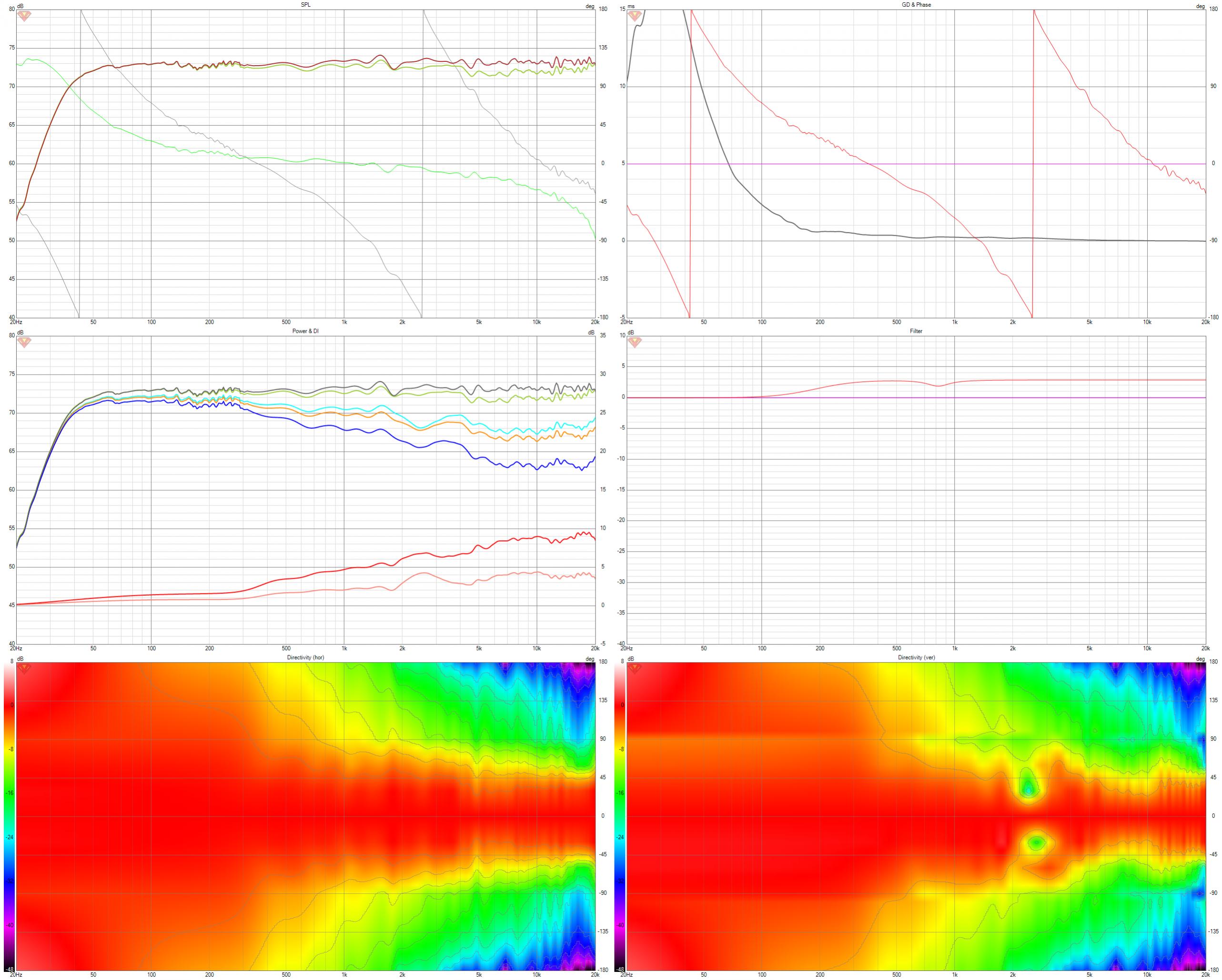

Just another taste of just how good these waveguides are.
2 way, 15L bass reflex 15W8530K00+SB26ADC in 5" WG. LR4 2500 xo, quickly slapped into a test cabinet.
I'm using DSP to correct the on axis smoothness, but the normalization gives a good indication of the DI match between WG and 5" Mid-bass. The tweeter did still require 0.06ms delay to get perfect phase match between drivers on axis.

Very nice results!
Sweet project, mainframe99! Any reason for the 2.5khz xo? You could smooth that directivity even more if you dropped it some.

Hi, just reporting in to say that I’ve put together my first prototype box using one of these waveguides! The off-axis seems to be well behaved, though I have some work to do to generate reliable measurements. Early crossover work in the Minidsp has gone fairly well.
It seems that the on-axis response of the RST28a in the 8” waveguide *does* have that >10khz cut and I’m still deciding how I feel about it. I think the final word on that will probably be how it sounds after I’ve developed the passive crossover. For home theater use (my intended purpose) it definitely isn’t a deal breaker, but it’s something I’m paying attention to.

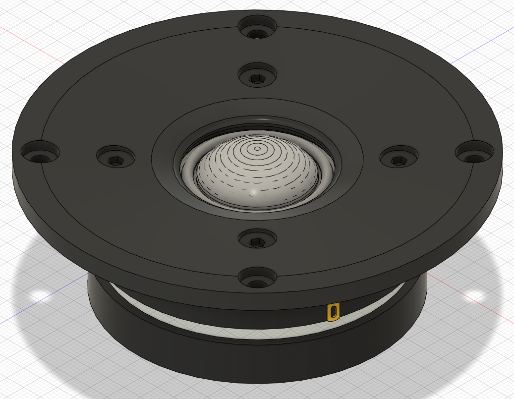

I found something interesting today that I hadn't noticed before.
Scanspeak has 3D step models for most of their drivers available on their website. This should make modelling of waveguides a lot simpler as all the geometry for the domes, surrounds and lips is there.
@fluid I wonder if that is just indicative or real geometry. I imagine for 3D modelling the mounting is the main issue for a designer... not the curve of the waveguide. It's not uncommon in industry to obscure such a thing. Interesting pickup though.

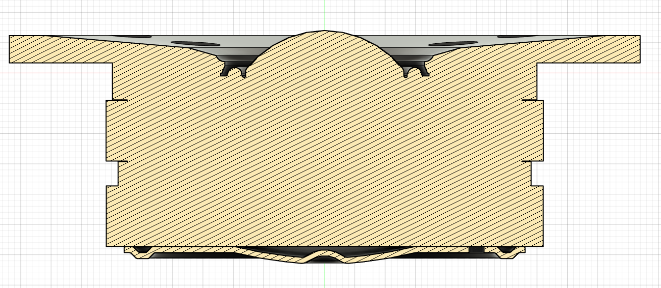

I don't have a driver to compare to give give a definitive answer. Why model all these features in this level of detail or even post them at all if obscuring was their intention.

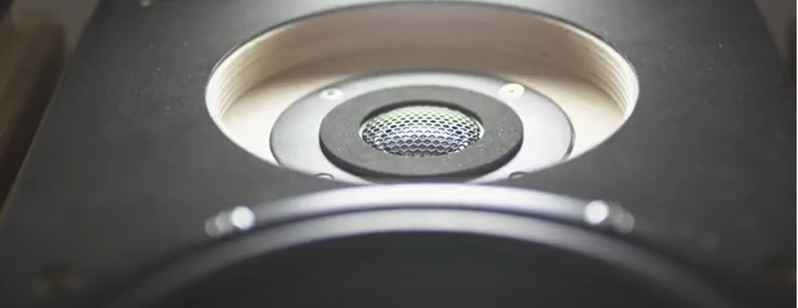

My images are of the D2608, I am interested in looking at tweeters where a waveguide can be fit to the existing driver without having to take it apart and risk what happened to you.
The Elsinore waveguide mounts over the D2608 and Dutch and Dutch do it without any obvious issue in the response
