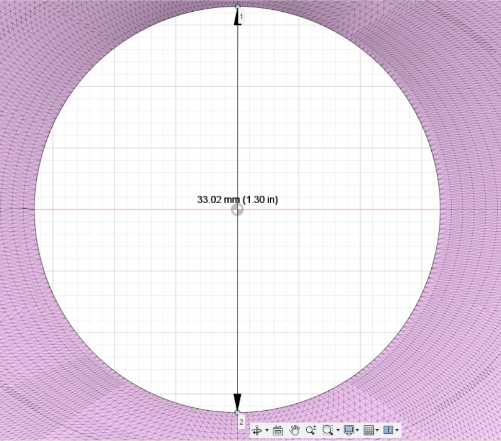

OK, can anyone help me and tell the exact size in millimeters for the throat on the SB26 waveguides?
I spent an entire afternoon with my poor Sketchup knowledge to resize the waveguide so the throat is 25,4mm
mga2009 - I can tell you later today.
I think some people may be having trouble with the unit size for the waveguides, it must be set to inches in any STL viewer (and later converted to mm with a calculator) or if submitting for quotes for 3D printing. Anything else will physically change the size of the print.
For example, if you submit the 5" waveguide to quote at xometry and select mm in stead of inches, you are asking them to print a 5.8mmx 4~ishmm part, which is pretty much impossible.

If you use Ath to set the geometry that you want it can generate the required splines to loft into a shape in Fusion 360. There is some information from augerpro if you search his posts in the Ath thread that should get you very close. By measuring the tweeter that you intend to use physically you can model that as a source in Ath and see if the waveguide will work for that tweeter without even having to make anything.So I was hoping someone could help me with that?
I think it is easier to learn to use Ath than it is to make however many different prototypes are needed to get the desired result, but you are right easy is indeed relative, trivial is a word mathematicians like to use use when I usually find it anything but 🙂
