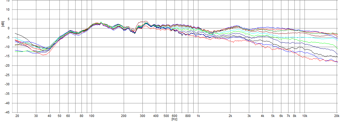

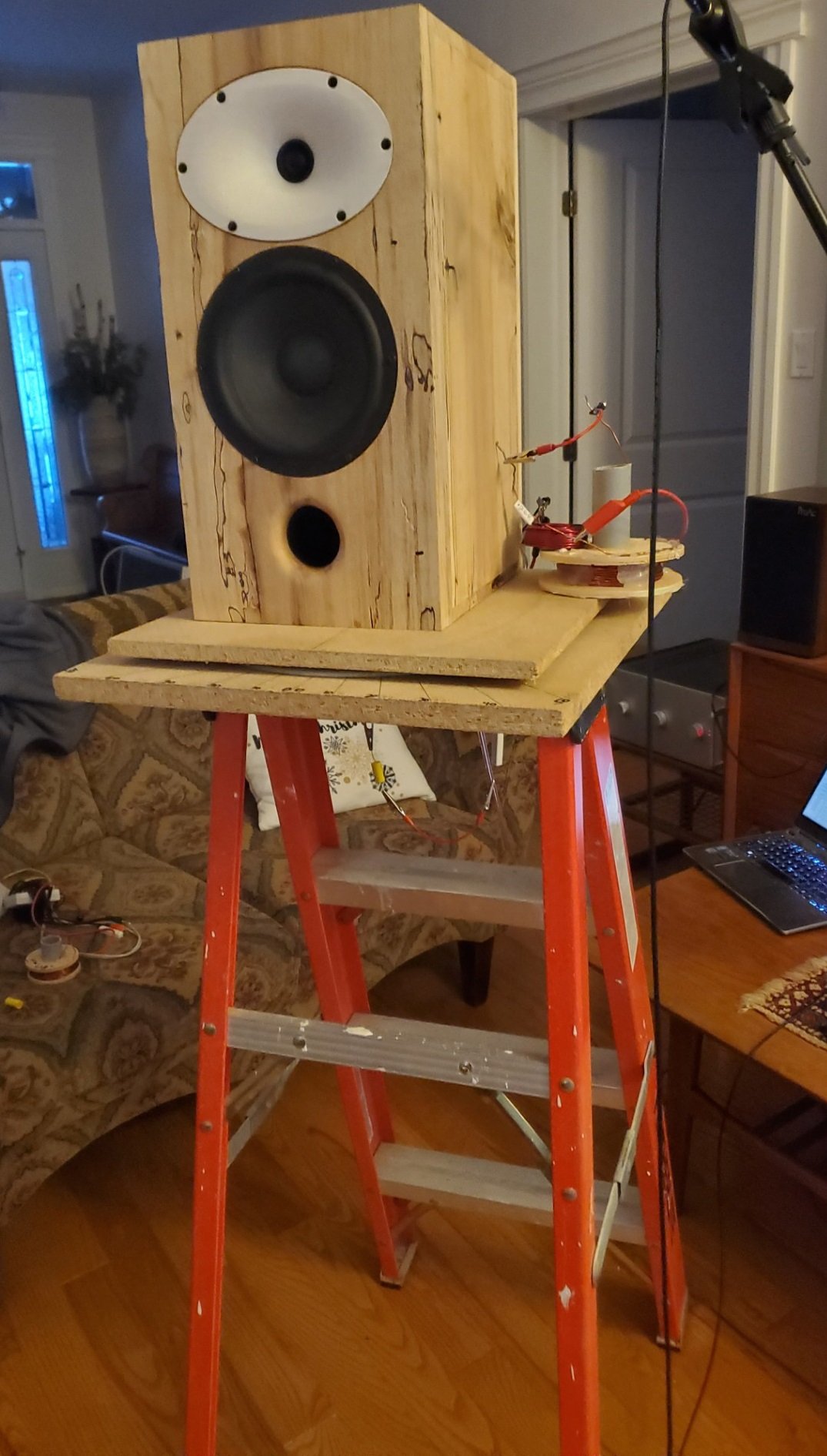

I'm working on an OB project with a miniDSP Flex 8 used as active crossover. To start I'm going to make the slightly improbable leap of going from the SB26CDC tweeter to the SB 15OB350 15" driver, crossing around 1500 Hz or thereabouts. I might add a mid later, but for now, that's what the funds are.
I was going to 3D print the 8" oval waveguide, but thought I'd at least ask the question--would a 10" or even 12" WG make the directivity matching better?
Also, is the phase shield recommended? I don't think I understand what it actually achieves.

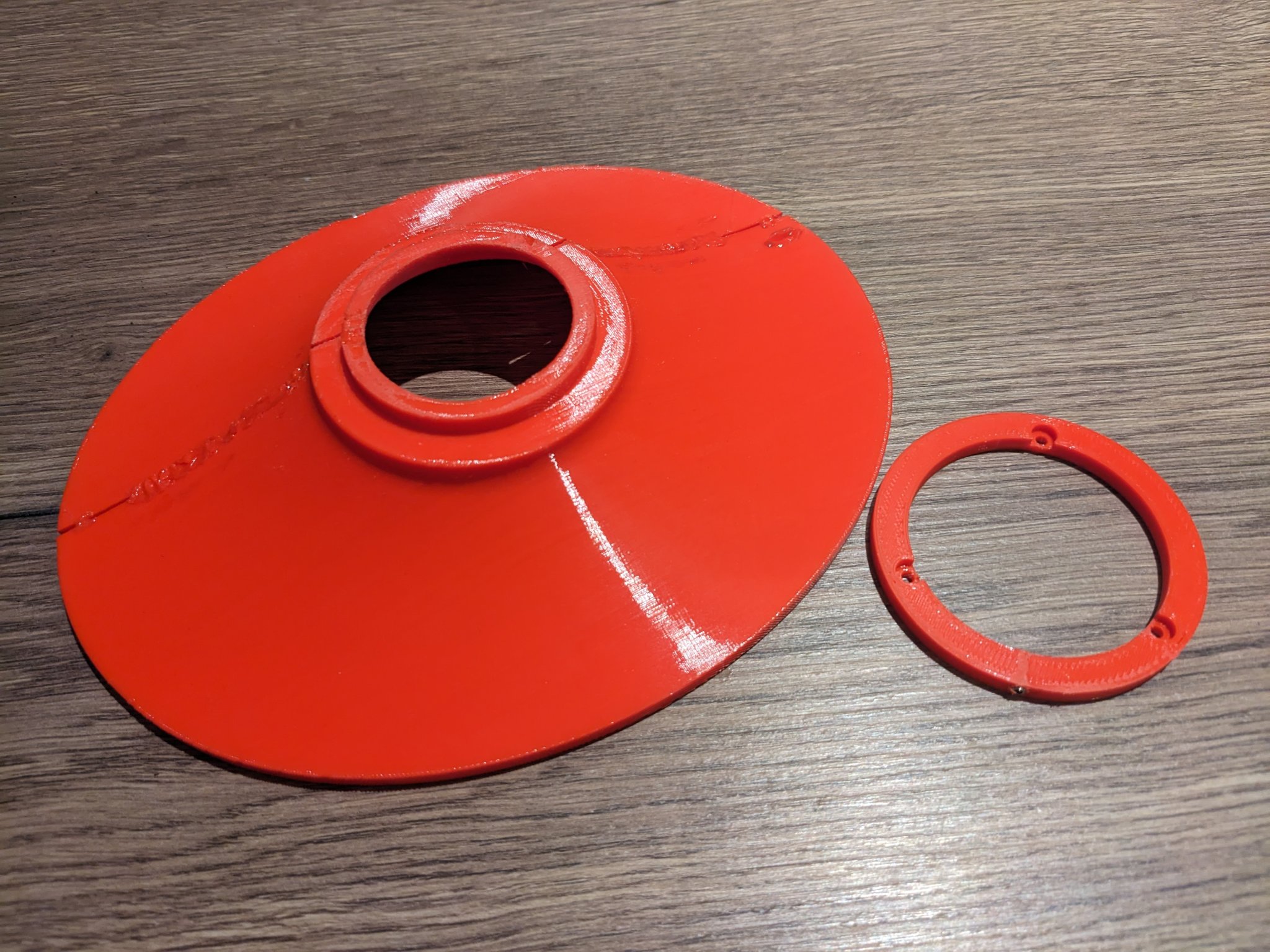

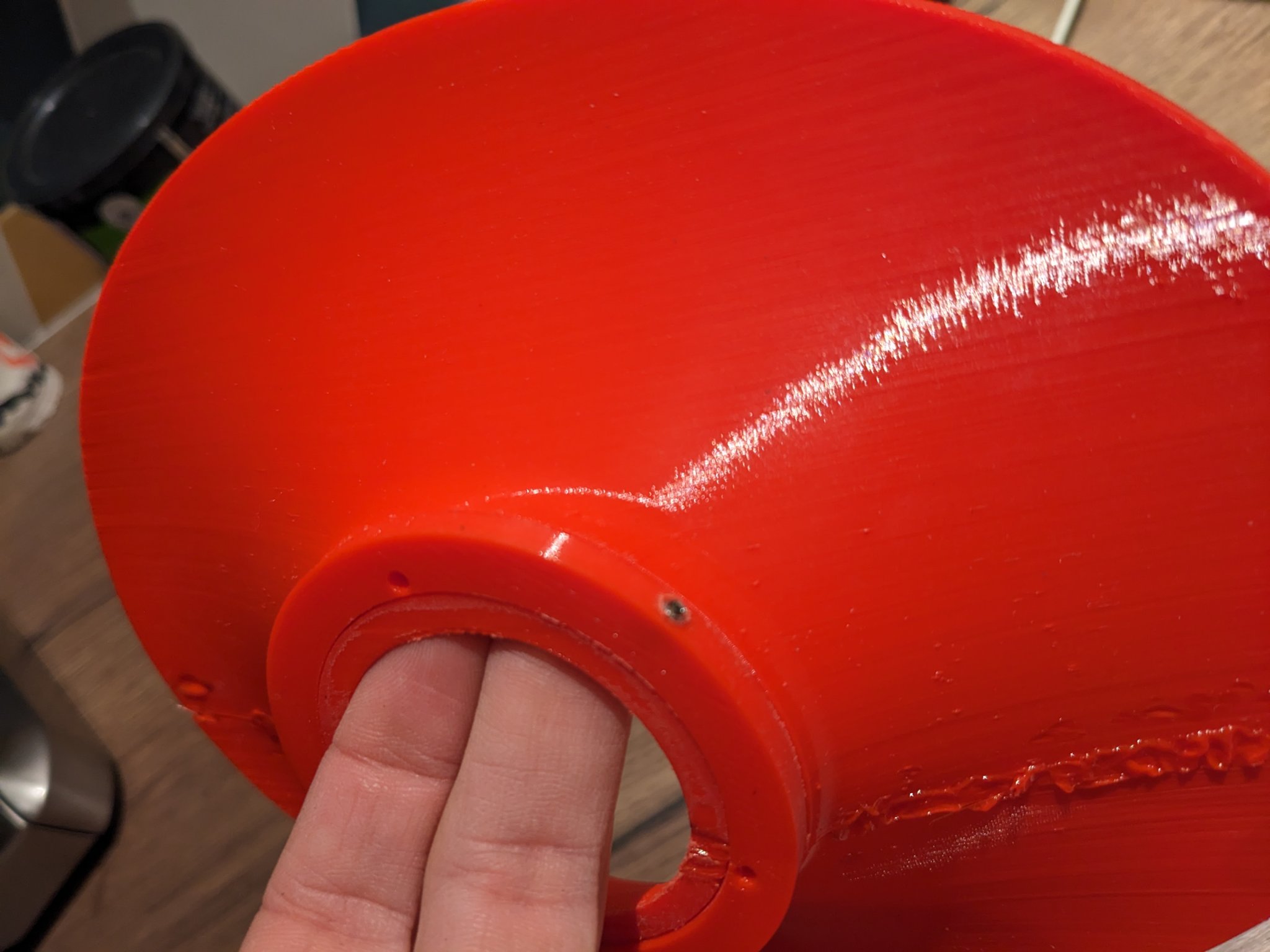

Here we go with a trial.
The 8 inch for the tw29txn-b-8
I had a failure on main power so I did it in two parts but it doesn't match exactly and I had to solder both parts. Any way it is for prototyping.
I have change the back part and included a mounting ring. 3 little screws on the side are fixing the ring on the waveguide and the ring is fixed on tweeter with similarl screws than original.
Seing pics I am pretty sure SB acoustics is doing like that.
Now i have to dismantle a more than 250€ tweeter !

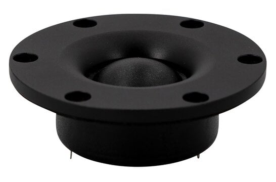

Greetings community!
Glad to join.
Have couple projects to try, but both needs waveguides.

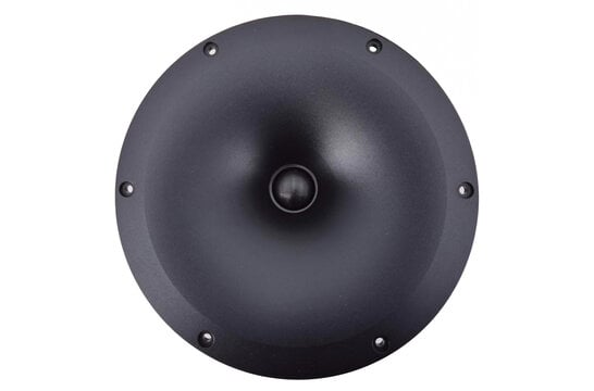

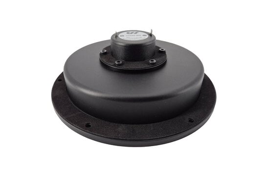

Tweeters: SB Acoustics SB19ST-C000-4 and CSS LD25X Silk Dome XBL2. Is there any chance to get stl for them or any info/drawings?
There's waveguided version of CSS LD25X, but ridiculously expensive. I'd like to make them somehow.
Monacor WG-300 not available anymore, unfortunately...
Here's pictures of those waveguided CSS tweeters.
