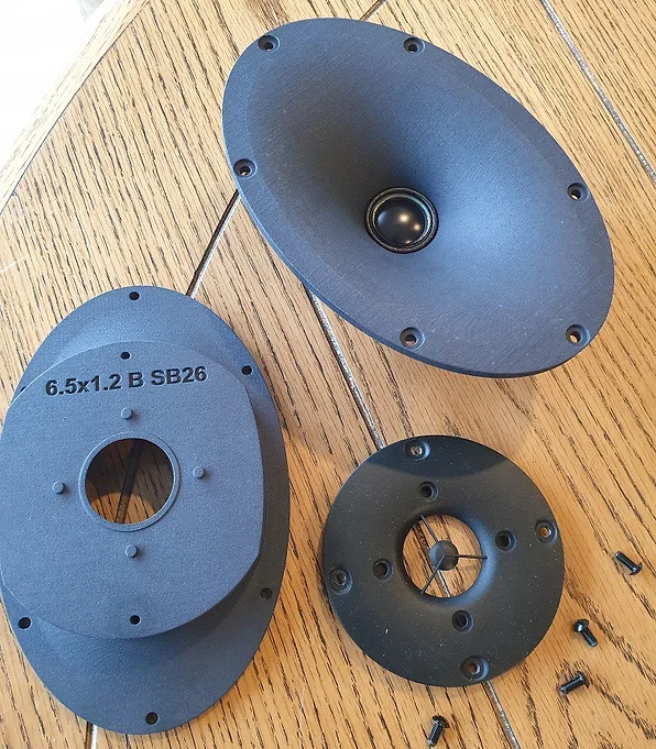

Do you mean on the backside where the mounting flange meets the actual waveguide wall? Yes, some models have this but most don't. Sometimes the loft function in F360 doesn't cooperate and I have to make the waveguide a bit thinner than the mounting flange, hence the ridge.

The waveguide wall! Thanks, I'll print a few other models as well..Do you mean on the backside where the mounting flange meets the actual waveguide wall? Yes, some models have this but most don't. Sometimes the loft function in F360 doesn't cooperate and I have to make the waveguide a bit thinner than the mounting flange, hence the ridge.

There's a horizontal ridge on top and bottom from the transition from radius to the mounting flange.
This appears in the stl file. Is the ridge on this model only? We might try to smooth that out for next print..
How do you get this special support structures?
Tree supports from the slicer.How do you get this special support structures?
For printing flat on the bed variable layer height from Bambu Studio or Orcaslicer can do a lot to help the straight off the printer appearance.
Also the print is white and that really helps to make the layers look smooth to the eye.
@Joel Wesseling I'd question your slicer's decision to use some of those supports.
The mounting face would carry the same need for support over the entire plane (unless there's an overall toppling issue, which some slicers might not consider). The middle supports shown are to hold the locating pins, important as they may be and the upper ones are only to support the engraved lettering detail.

Its the first color that I've printed but yes layers are visible as show with this outdoor photo. Acetone might be worth a try on these ones.Also the print is white and that really helps to make the layers look smooth to the eye.
I'm also curious about what is the absolute smoothest surface possible with the proper 3D printer and providing the operator has all the necessary experience
Mine were printed with a 0.4mm "Hotend" - There is a 0.2mm hotend option and it will take even longer(no problem if I own the printer) but how much better of a surface finish?
I've messed with Acetone smoothing of ASA and it really doesn't work all that well. Much easier to spray with primer and sand with 220 grit between every coat.
