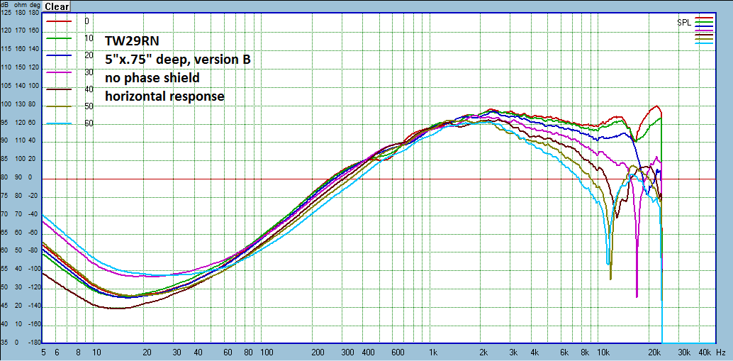

You think your will work on a TW29RN waveguide ?
I did work with that early on, but the response was kind of wacky in the top octave:

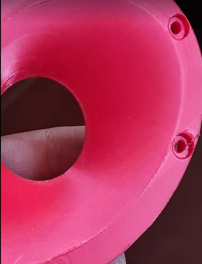

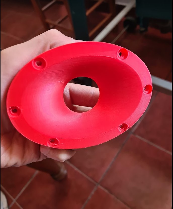

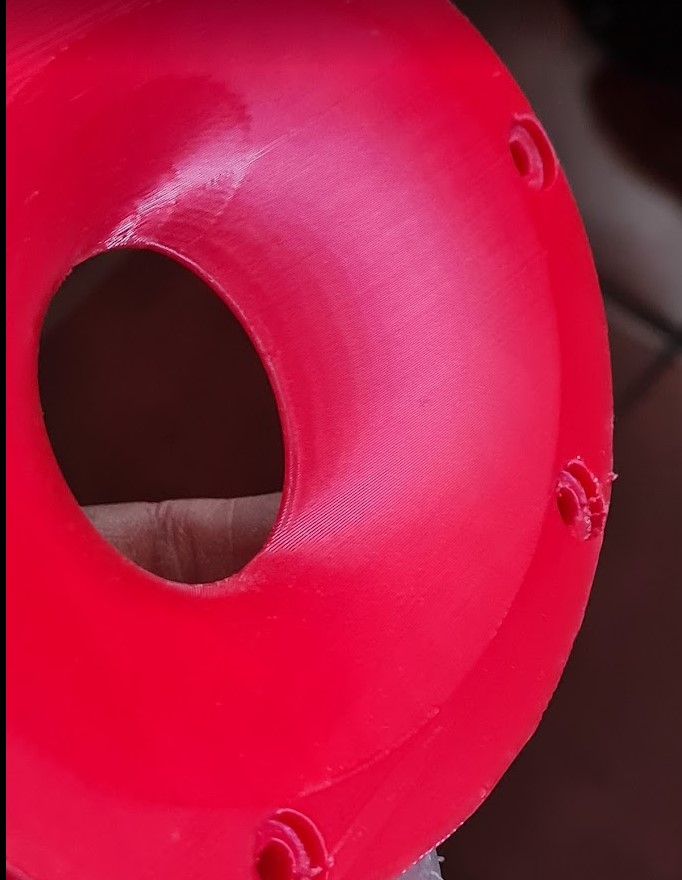

Here are some pictures of the WG I printed in my Bambulab A1 with a generic PLA and without any optimization in the printer. It looks quite good. I am new to 3d printing, but I assume a better filament and with some optimization on the speed and temperature you could have a very nice finish.

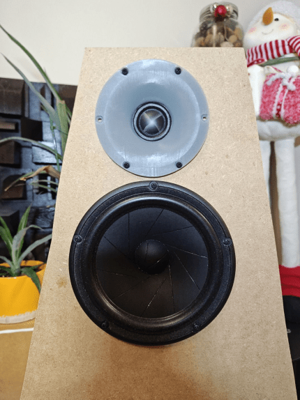

I printed 4"x.65 waveguide for my SB Textreme but results I am getting on top octave are warring me

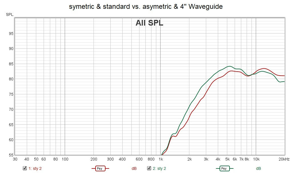

Measurements from ca. 1m. One is without waveguide and one line with the waveguide. There is visible and clearly audible drop in energy on high frequencies.
Any idea why I am losing so much SPL? The driver suspension doesn't looks like is touched by waveguide.

mga2009> Looks like the important part printed nicely, but you should be able to get cleaner holes. I would like to make smaller waveguides for the little Vifa, but I just don't have time at the moment. Maybe next fall I will. I use Fusion 360. You might have better luck using the .step file and modify that. What you are trying to do should possible I think, but I don't modify .stl ever so I'm not sure how you go about it.
rafabro> yes that is problem when designing waveguides for domes that were not designed with waveguides in mind. Given the sensitivity, this should not be a problem. I hope you are going to flush mount it? That dip in both measurements is likely due to the surface mounting.
Absolutely in the final baffle it will be flushedrafabro> yes that is problem when designing waveguides for domes that were not designed with waveguides in mind. Given the sensitivity, this should not be a problem. I hope you are going to flush mount it? That dip in both measurements is likely due to the surface mounting.
