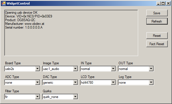

With new firmware and WidgetControl.exe installed on your Windows computer it is possible to set the different parameters. I have attached a screenshot of what things look like here. After "Save" you must press "Reset" for the changes to apply. Reset takes 5-6 seconds.
To change between USB Audio Class 1 & 2, hold Prog until the front LED changes color and then goes dark. After that release Prog and press Reset. The opposite Audio Class should then kick in. This procedure you can do on any OS.
