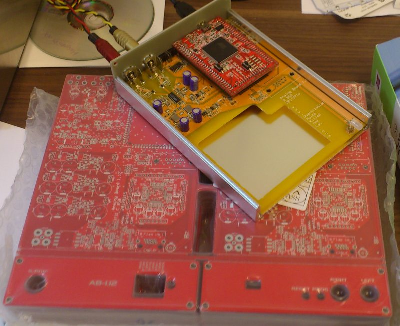

New HW batch arrived
Here is the first picture of the AB-1.12/1.13 prototype boards and the next module!
I'm already playing music on this setup, but it looks like some debugging is needed. The boards look OK, and I hope to start shipping them out soon. I'll keep you posted.
