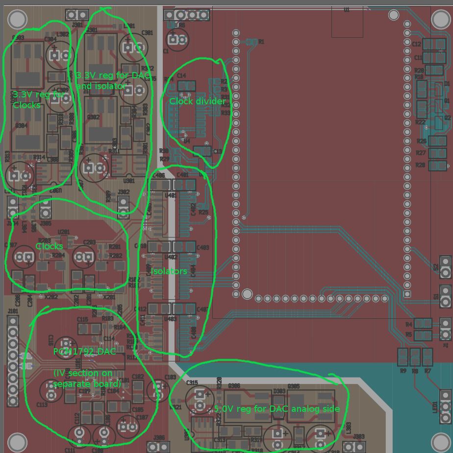

I have been working on an AB board based on the PCM1792 chip and Borge's USB-I2S module. I would like to experiment with different I/V stages, so my output is the balanced current out with reference voltages. (I have the Nelson Pass D1 I/V section already and I will also build this: http://www.diyaudio.com/forums/diyaudio-com-articles/172983-zen-i-v-converter.html )

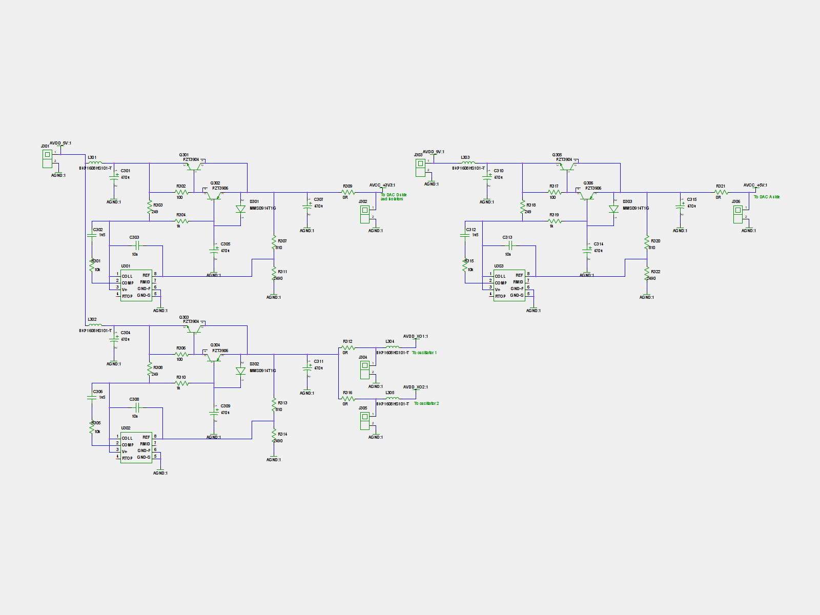

For the voltage regulators on the non-USB side, I have decided to use Demian's series-regulator section instead of the shunt version. I might play around with the shunt version later.

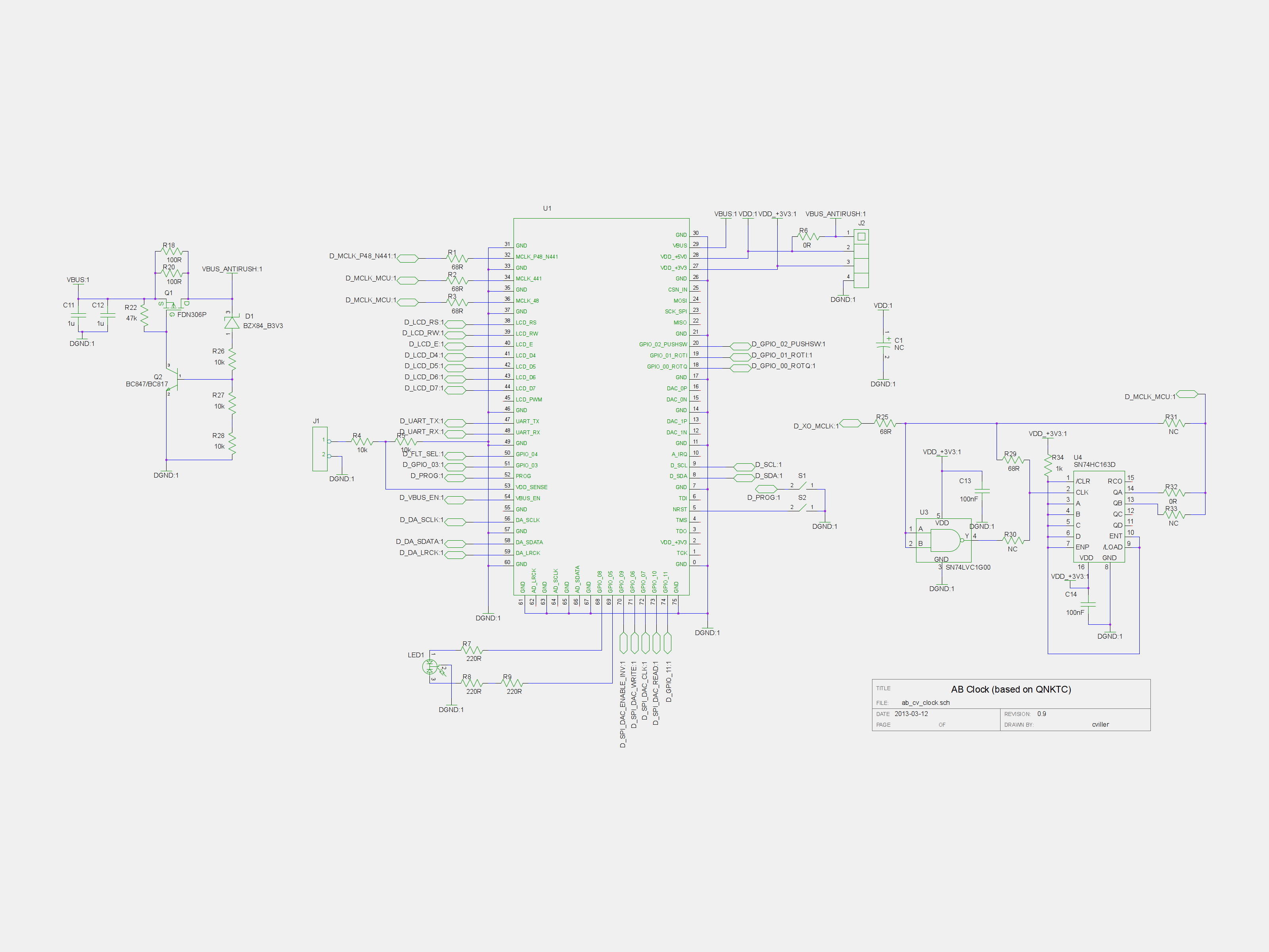

GPIO for SPI The PCM1792 DAC chip needs to be controlled through SPI, so I am planning on modifying the widget code to send SPI initialisation codes. However, I have not yet spent any quality time with the widget code - does anyone know if it is a poor choice to use GPIO 6,7,9 and 10 for the SPI?
Attached it is the schematics and my layout - please comment, if you have any suggestions. The size is 10x10 cm so that I can use one of the batch pcb-manufactures.

I think that board is really interesting. Would it be possible to bring the ADC lines out to a header (62,64,66, clocks and grounds)? There is a lot of interest in a capture variant. Perhaps Borge can comment.

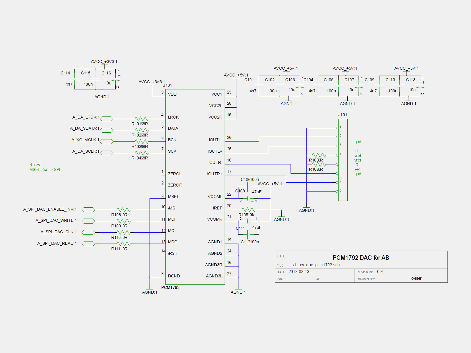

One thing to be very careful of is the loop around a current output DAC. That link is very sensitive to external magnetic fields. it cannot tell a different between internal currents and induced currents. If the peak current is 10 mA then -120 dB is 10 nA, not very much. I would make that extremely small and using an airplane board would be a good idea (to keep the currents at orthogonal to any others in the system).
1. I think that board is really interesting. Would it be possible to bring the ADC lines out to a header (62,64,66, clocks and grounds)? There is a lot of interest in a capture variant. Perhaps Borge can comment.
2. One thing to be very careful of is the loop around a current output DAC. That link is very sensitive to external magnetic fields. it cannot tell a different between internal currents and induced currents. If the peak current is 10 mA then -120 dB is 10 nA, not very much. I would make that extremely small and using an airplane board would be a good idea (to keep the currents at orthogonal to any others in the system).
Thanks for your comments! 😀

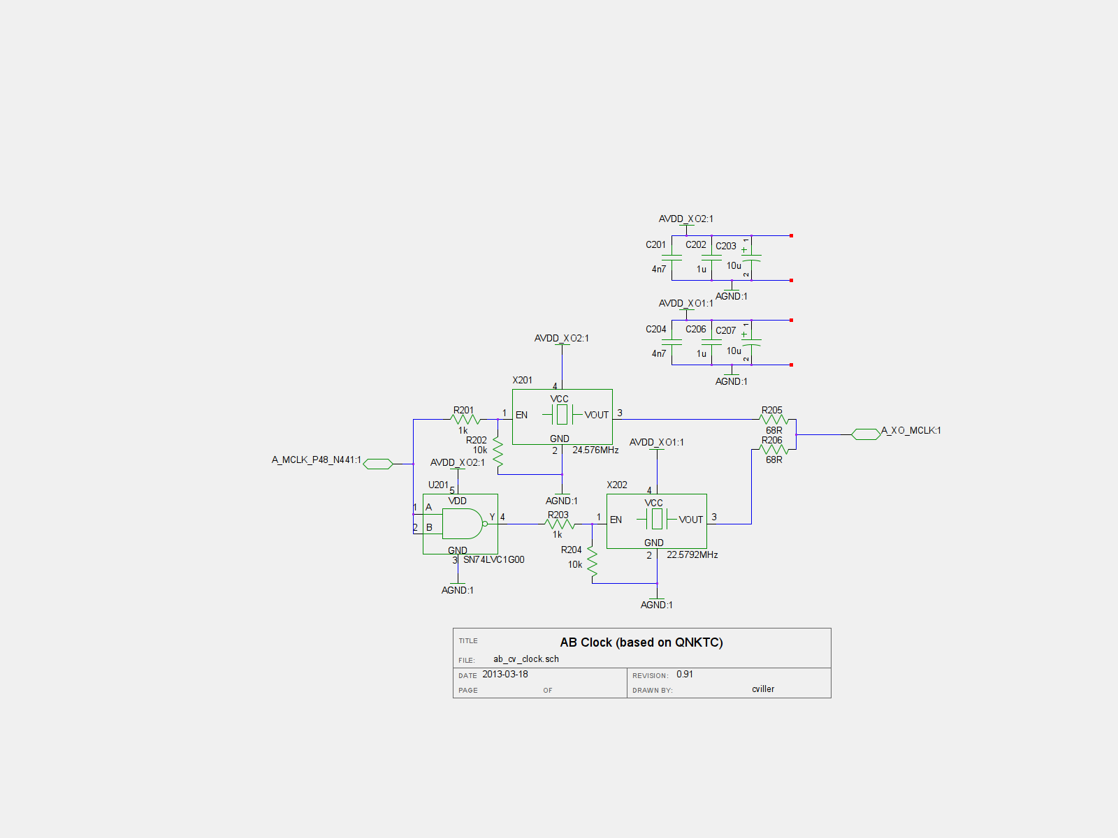

1. A header to capture sounds easy, especially if it can be handled in the digital part - I am just reluctant to put too much stuff on the clock in the analog section.
2. Good point about the currents. Sorry for my ignorance, but what is an "airplane board"?
Airplane board- a board "floating" above the main board on a connector. If its perpendicular to the main board its even better.
The capture part of this board would need the master clock to be in sync. The capture card could be a slave to the host and the clocks would come from the digital section.
I have been thinking a lot about this - but not reached a conclusion. Perpendicular airplane board is probably not going to fly, because some of the components I was thinking about putting on the IV stage are bulky... how is the common mode rejection typically on current out dacs? Couldn't the issue be solved by routing the diff pair close and ensure nearby gnd return path?
Nonexistant. . .
The common mode rejection comes from the next stage. For a current out DAC the next stage needs to create a virtual ground at the output node. A reference would come from the dac as well. The area inside that loop will be sensitive to interference. Also keep in mind how fast the current needs to slew. That calculation which needs to include the out of band energy at the output pins is the biggest challenge. If yopu ignore it the current will go somewhere, possibly charging caps and active device nodes waiting to discharge. This is all before the image rejection filter. You could add a passive filter at the DAC output but that would adversely impact the VI stage if its source Z is increasing. Lots of interesting experiments possible.

Regarding current loop on the layout I posted, is it correct to focus on the pink or green loops (drawn for only one channel)?
If these are the loops, I feel that it is fairly straight forward to keep them close with no tracks inside - or am I missing something? :scratch:
Not sure if I see pink and green loops, could you link to the actual layout again?

I haven't really separated DAC and IVC like that in any of my designs. At least have ground on either side of the track pair (in the plane) and below them on the board. Make sure that ground is well connected to the ground underneath the IC (ref.prev.msg.)
Now I understand Demian's point a lot better. Anything induced into a loop between A+ and A- will appear amplified on your output. High-frequency noise may be demodulated by non-linearities in following stages.
