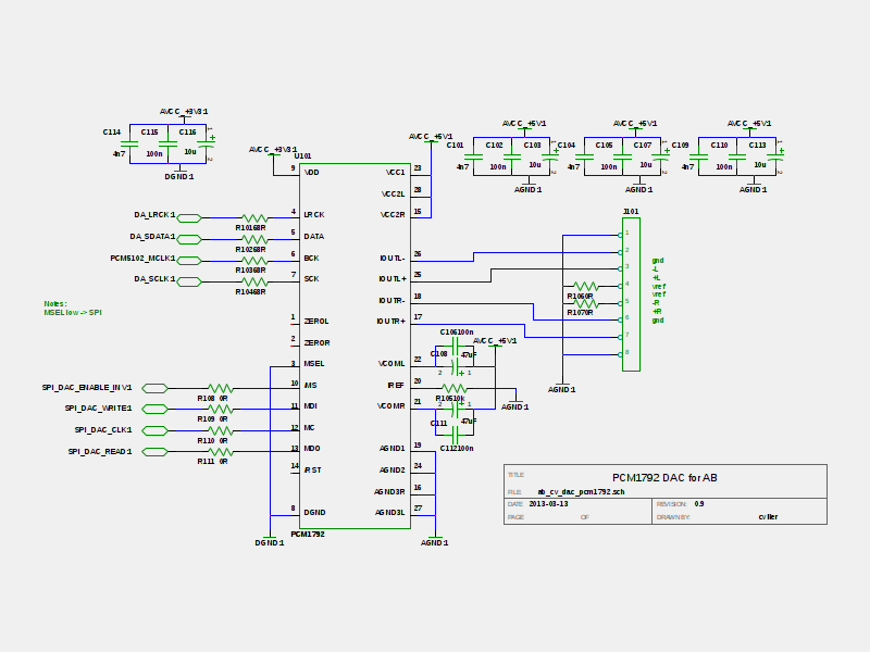

I am currently working on a AB based on pcm1792 (slow progress). The plan is to expose the current out, so that I can do the I/V conversion on a separate board (I'll be using Pass Labs D1 stage and the newer JFET version).

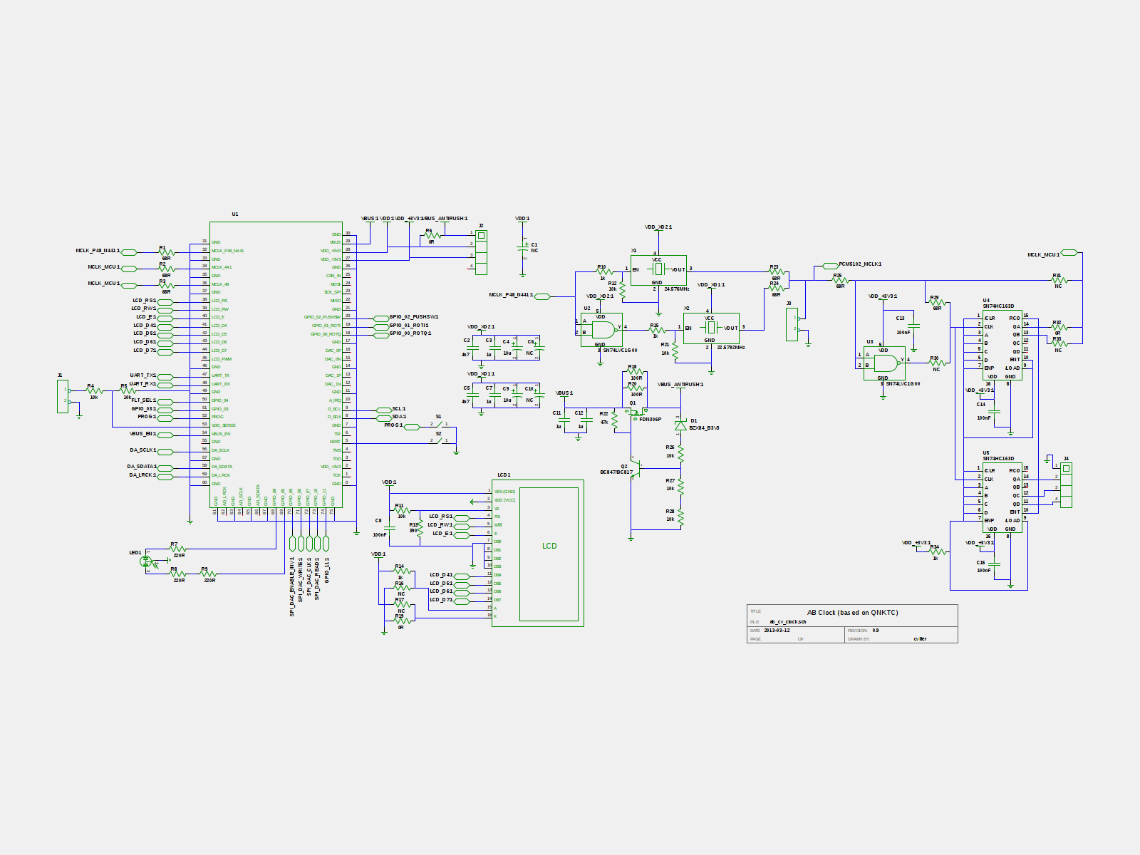

I really like the clock setup on the original AB-1.2, so I have basically copied the whole thing. 😀
However, I have a couple of things around the SN74HC163D counters which I am bit unsure about.
1. It halves the clock frequency from the crystals, right? Does it provide any other benefits, or could it be omitted (adjusting the circuit to either the high freq or find another crystal)?
2. Why is the VDD_+3V3 used, wouldn't it be better to use the regulated VDD_XO1 or 2?

The clock dividers must divide MCLK down to 16MHz or less for the AVR32 serial interface. It is clocked from the digital domain because it only feeds signals to the digital module. So no power and minimal ground paths are shared with analog 3.3V.
A while ago we briefly considered synchronous charge pumps or switch mode power. That's not used, though. One chip is needed, the other is a nice-to-have.
