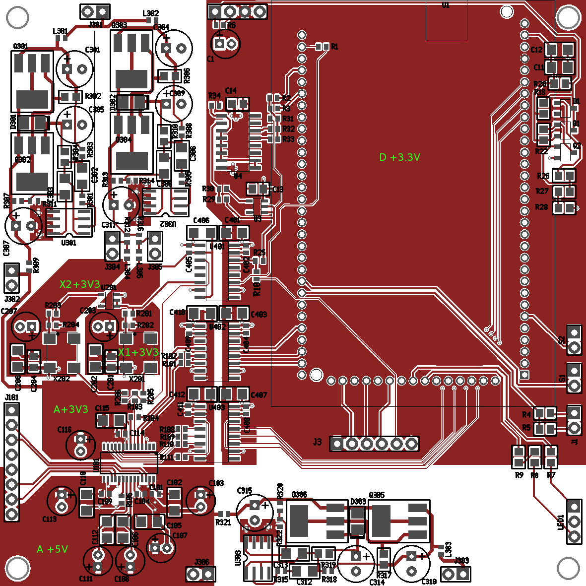

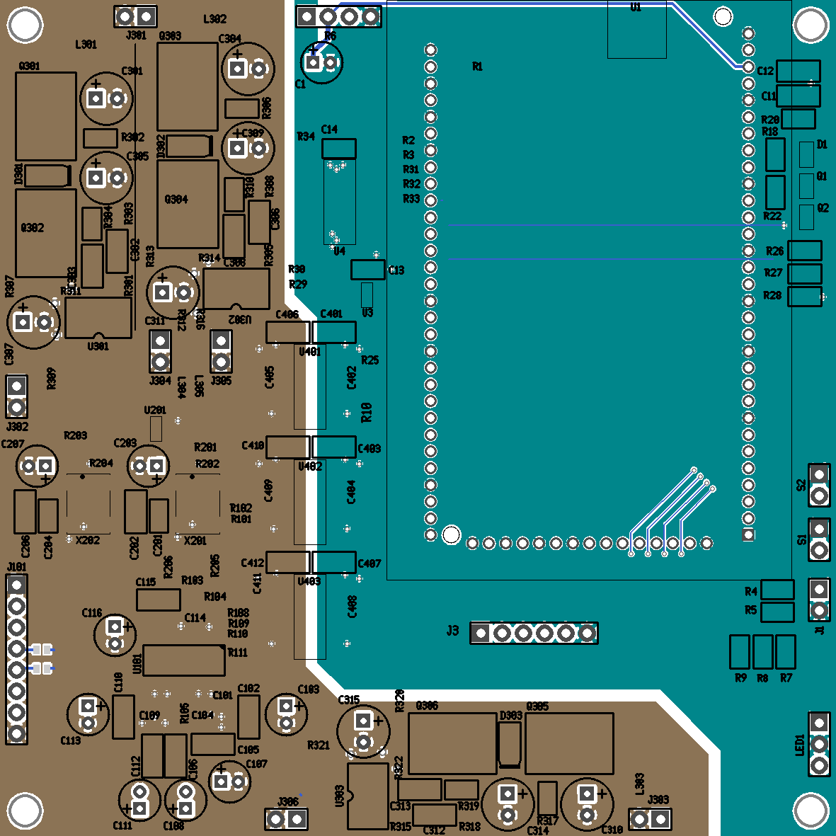

The gnd plane on solder layer (brown polygon http://www.diyaudio.com/forums/digi...b-interface-audio-widget-217.html#post3444877) is unbroken all the way from DAC chip to connector and Iout+/Iout- are routed closely together from chip to connector - where is the dipole antenna?
It can be hard to see details on an image like this, especially when you can't be sure of what you can't see. You also do have what seems to be a ground adjacent to one of the traces. If its too close it could unbalance the network, otherwise it seems pretty good.
I have made a few changes: ADC connector added, correct SPI pins used, 3.3 V regulators swapped and better clearing of the current out traces.
The polygons on component side are actually psu - is that bad approach in practice? One of the few things I remember from high speed subjects at university was the importance of short signal path for supplies&gnd, as well as the coolness of using the layers to make ultrafast plate capacitors in the pico range... 😀
The first image show gnd layer - brown is AGND and cyan is DGND. Second image show the signal traces and small sections of supplies. Any comments are welcome.

It looks like you have done an excellent job of pulling it together. I probably would have given up and gone to a 4 layer PCB but I get lazy.
Regarding the ADC connector, I have taken the master clock directly from the isolator, so it is the same ~22MHz (of course with a small delay) used for the DAC master clock. Is that the most optimal clock for the ADC?
