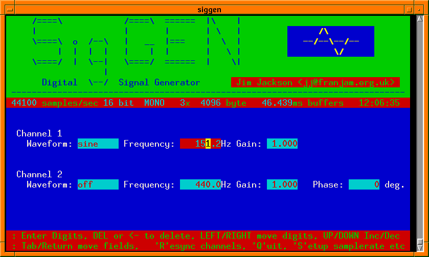

fwiw, I just learned about a neat little linux app, siggen.
at any debian system, you should be able to: 'apt-get install siggen'
it will look like the attached screen-cap (its console based, ncurses to be precise). use the arrows to move around and the values change immediately.
it works over the aw or any sound card on linux/alsa. stop any other audio apps first, though.
...I think this is still better than enya.
