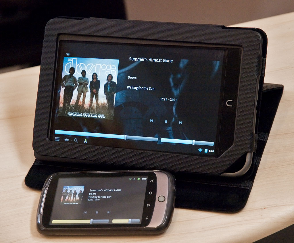

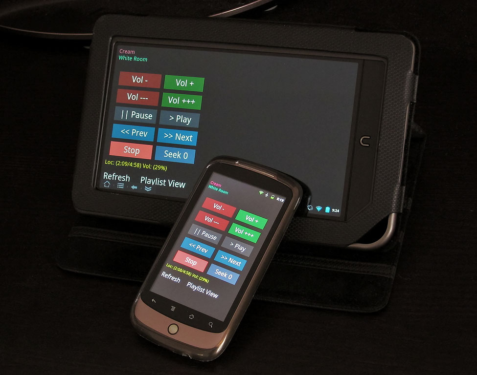

using an android phone (for example) you can control the playlist, shuttle and volume of mpd systems.
I used a cheap $100 nook color tablet and put cyanogen mod on it (trivially easy and reversable) and that sits literally ON my stereo shelf and gives a graphical (album art, too) display. touch screen for volume and even swipe left/right to skip back/forward. with that config, I have not found the -need- to have an attached lcd display (and I happen to love the 16x2 hitachi style 'easy' lcd displays).
tablets are getting so cheap, you can have one sit on your stereo shelf, one near the coffee table, etc etc. they all use wifi and all sync with each other (move the vol slider on one and the others update). pick it up from the stereo shelf, carry it to another room, use it there. freedom! 😉
