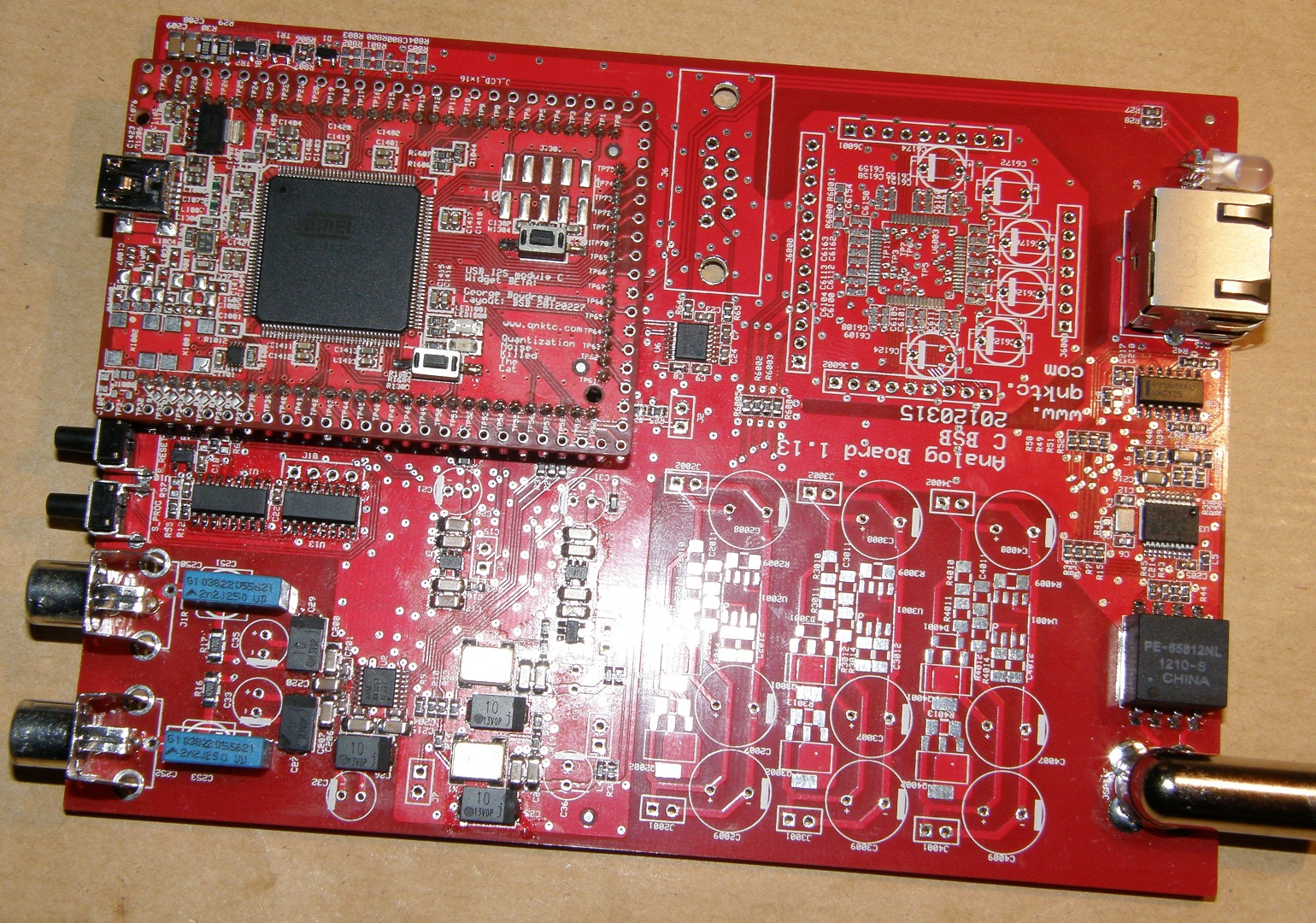

My board. This week will have a new enclosure. I use UAC2 on Windows 7-64 (No problems).

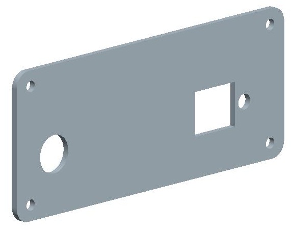

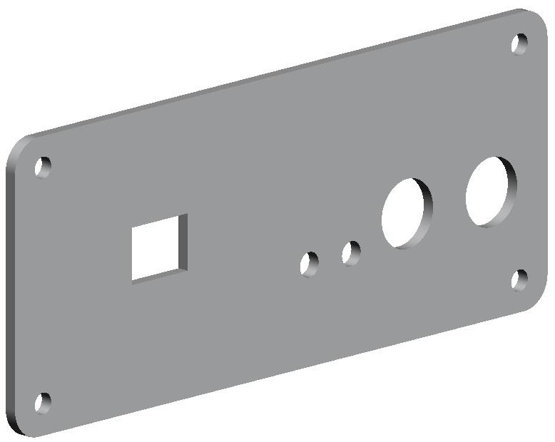

Now the plan is to use as USB-SPDIF converter, and from time to time as USB DAC. Next, new module, I will add to my Buffalo, I do not know. Other plans, maybe after X-mas.
My new panels will be, water cutting, tomorrow.
