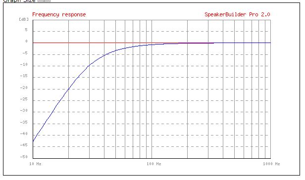

ok back to thread, any suggestion on woofer anybody ? i went through some and couldn't find anything better than that B&C 15BG100, it would be nice if it was cheaper and also more sensitive 😀 , we can always go half space , BMS 12N630 is such a interesting woofer but not gonna get close to 90+db fullspace, unless experts have some tricks up their sleeves 😀

Take a look at Faital PRO 15Pr400.
Tony Gee used those in his Calpanos
I have heard those speakers and think they are quite excellent.
I believe he is working on a 3 way but with using an 18" for bass. Perhaps a bit too large and expensive for this project.
very interesting. I did a quick cal, and it shows it can be tuned to 42Hz in a 130-150 liter (-3db f3) , but that Calpamos is tuned to 33, didn't have time to do a simulation but a cheap online simulation (speakerbuilderpro) in a 120 liter box tuned to 33Hz shows a smooth roll off and not a peak 🙂 will do a simulation later 😉
704504d1537416397-source-speaker-project-ii-asfasf-jpg
The Calpamos is 200 litres. Works for sure. There are a couple of reviews by users and they are very impressed.
