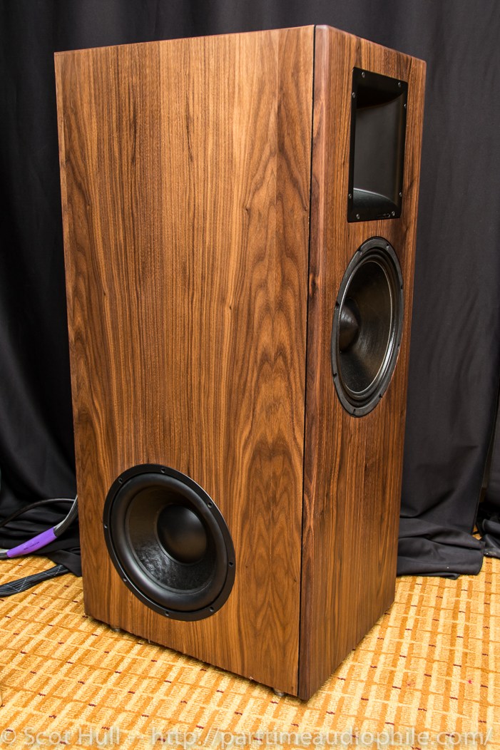

this remind me of what LineSource suggest in other thread: Tweek Geek BMF1 speakers - if memory serves me right, this matches what have been voted for. a freakin BEAST 😀
attachment.php

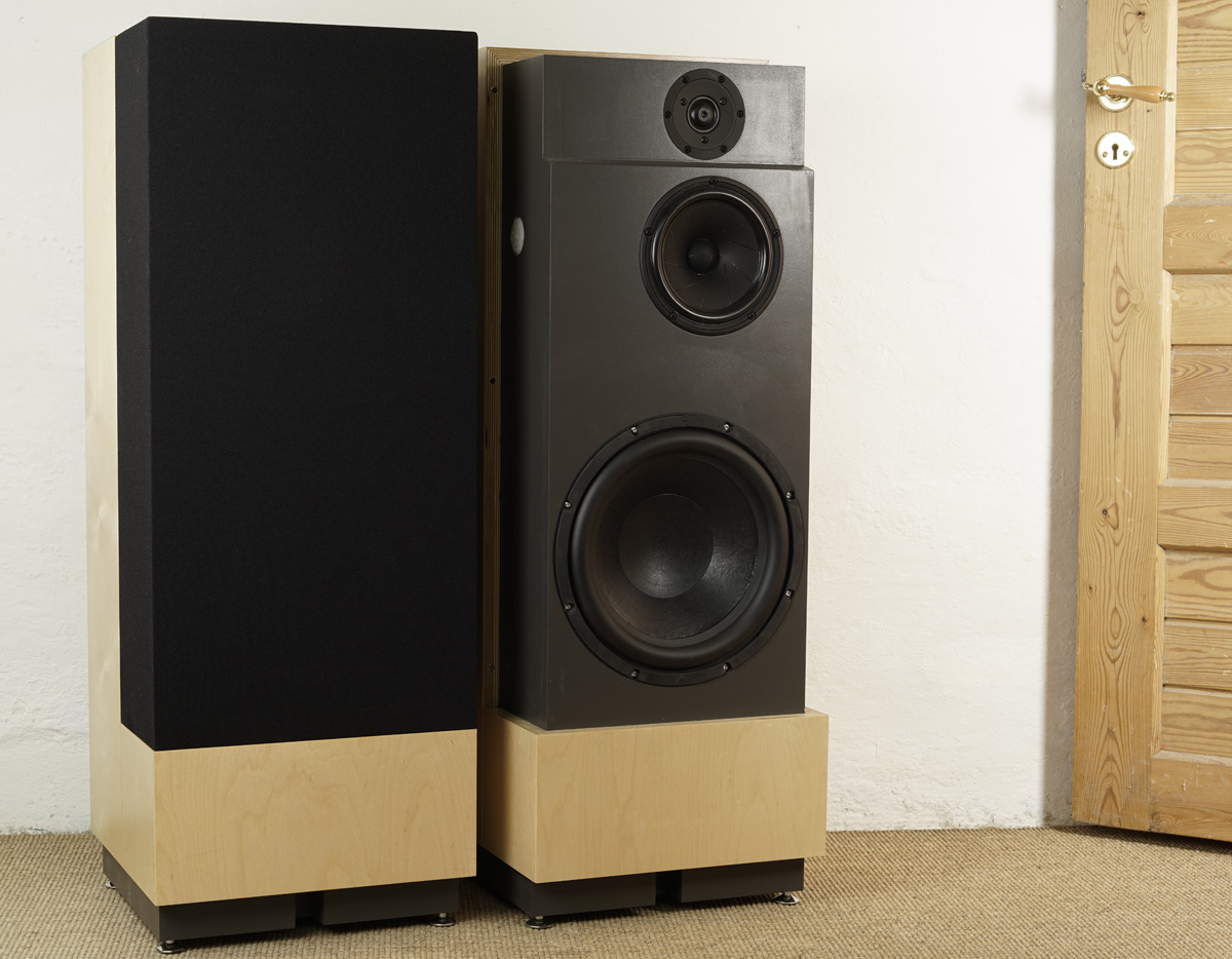

Is this a tower? Floor standing, tweeter at ear level, front mount 15" woofer.
There is a rational for using the large woofer on the front baffle because it usually means the woofer can handle all the baffle step.
ATC SCM150 Active Floorstanding Speakers - Igloo Audio
I actually like this a lot, Troel also has a design like this, the dimensions and foot print and of course the look is between a Classic 3 way and a tower with leaning more toward a classic design tho (Cabinet Dimensions (HxWxD) : 1104x495x635mm).Troel's Fusion looks more like a tower:
