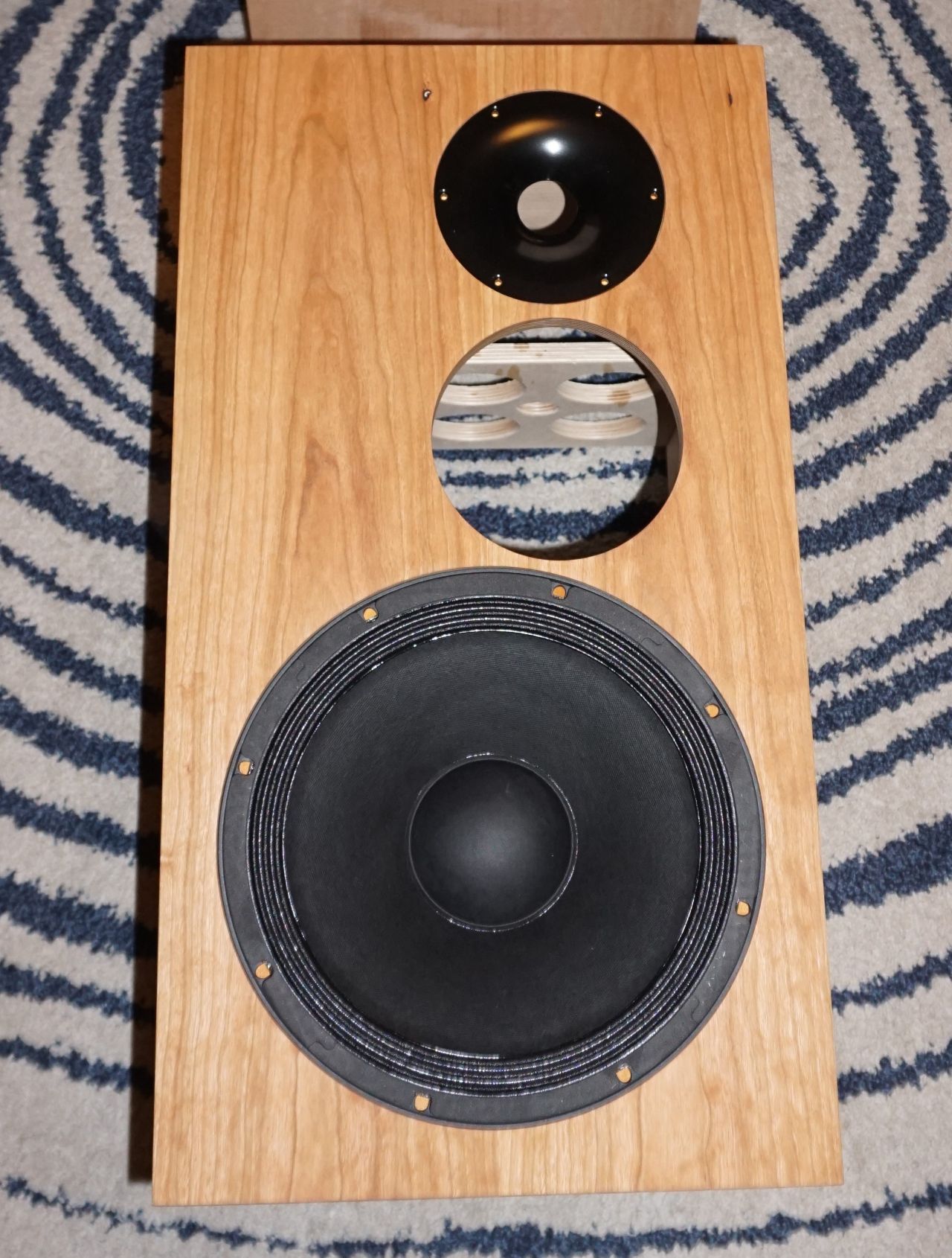

Did you leave further details on this speaker at another thread or would you mind to give your comparative impression somewhere? It does look like a 10-inch econowave. I find it interesting to learn more about the differences.These other DIY speaks are totally worth building (see pic). Have some unique attributes, but don't even come close the OSMC! I kinda expected this...but now I KNOW! Too fun.

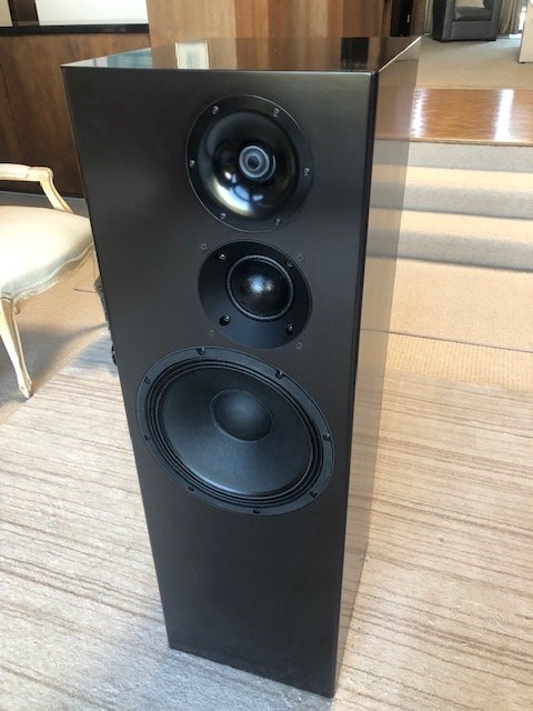

Oh YES!!!!! Fantastic! Great job! Enjoy. Love the white. 😀😀
On a side note...I recently built a second pair of pseudo-DIY speaks—a modified 2 way based on the JBL 328c which is designed for in wall applications, it has an on board Xover... you can separate the back loaded tweeter and put it in a horn lens JBL makes with an L-pad to control it on top of a front ported box ~16.5Hx14Wx12.5"D box... This is part of my "2 system dream"...and it's been awesome to run these next to the OSMC for an A/B frame of reference. Makes me wonder all over how great the OSMC are. To be fair the JBLs are actually totally competent in a standalone world, punchy and fun—but they really are not comparable to the OSMCs "proper 3-way" in terms of details, mid-range, and bass extension (I didn't think they would be, 8" and all...but had to make stuff, and the project crossed my path—and contrast is always good IMO).

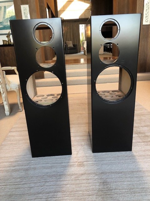

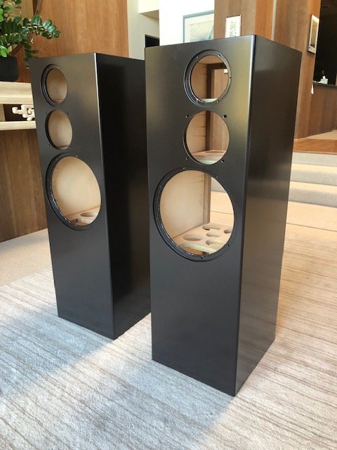

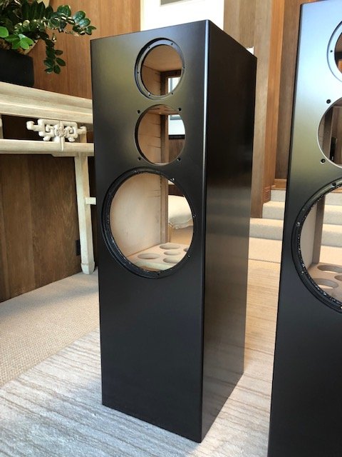

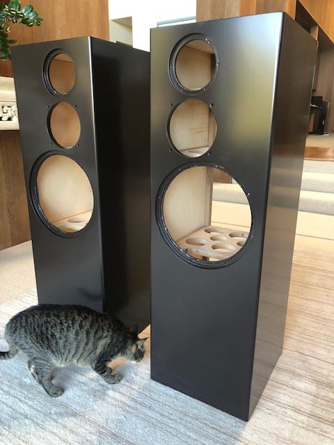

It's taken a long time but here are some pics of my Monkey tower speaker cabinets. Now for the fun part.
My apologies for the amateur quality pics. Background, lighting, and iPhone camera are certainly not the best.

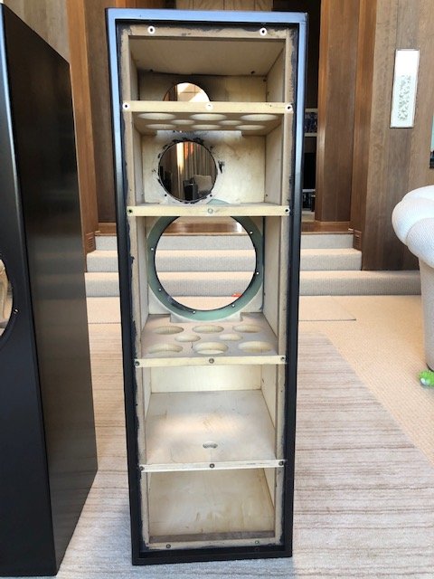

The backside view shows the position of the bottom of the speaker volume and the xover space below. The hole at center back is for the speakOn connector.
A 1000 thanks to M and P and the others for answers and guidance to a lot of questions.
Don

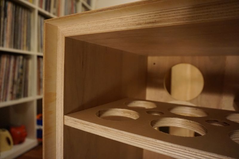

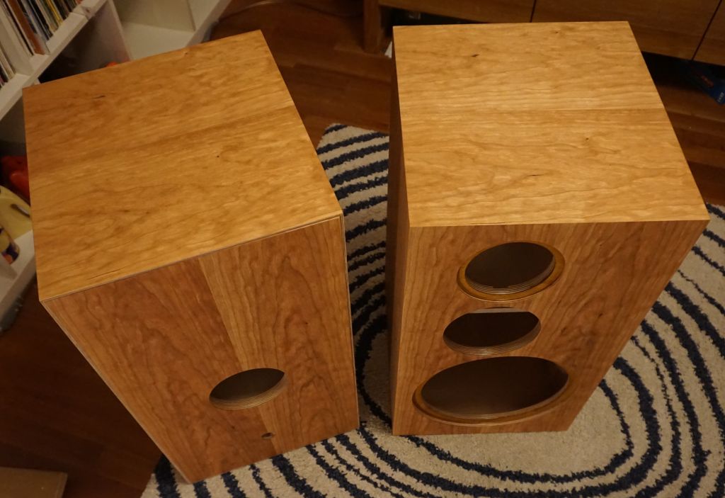

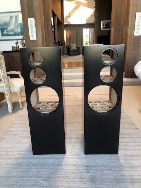

Received my housings yesterday and I’m very pleased with the result.
24mm multi-ply with 1,5mm maple veneer, oiled.
The front is CNC milled from both sides (on the inside to get the midrange aligned with the front).
Unfortunately the orientation of the veneer on the top is not as I wanted it, but I can easy live with that.
Sorry for the bad quality: give me a mobile phone or a top range camera- the pictures I take are always trash…

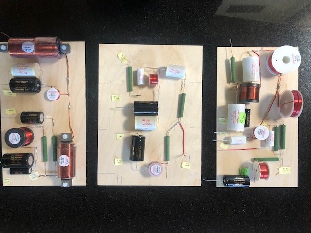

Attached are pics of one of my speakers with the drivers installed and my xover project. Getting closer to sound - slowly. I would appreciate a second set of eyes on the xover wiring. Are they ok? Don't want to blow up my new speaker. The speakers are way cool and I can hardly wait to drop the needle and hear the result.
I ran into a hiccup with the melamine pyramid tile. Acoustic Solutions will only sell it in a full box right now. 14 tiles, $477. Twice what I need. Maybe I'll just have to bite the bullitt.
Thanks,
Don
