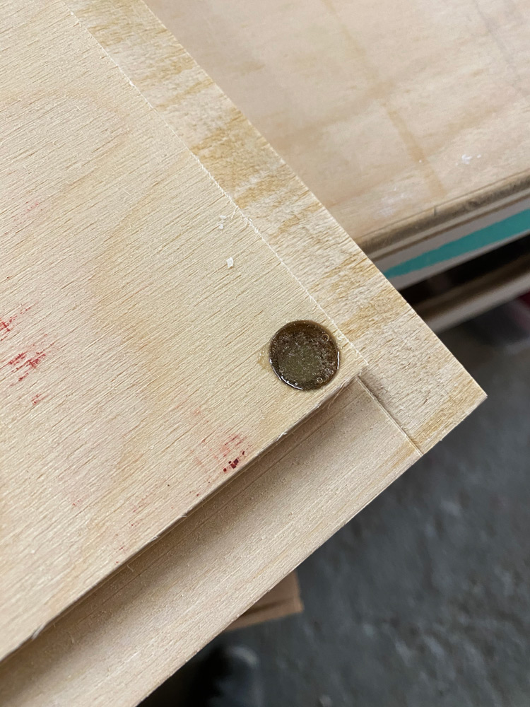

I did some tests to find a magnet that would hold well through the wood. Then yes, drilled a hole from the back of the baffle within a few mm of the front surface and embedded the magnets in epoxy.

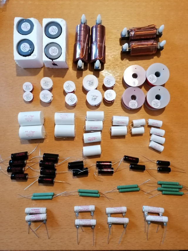

Incoming inspection of a delivery from TLHP today...
Although Mundorf is from the same city as were I live, I bought them in France, because they had the best prices.
Manufactured in Cologne/Ger, send to Rennes/F, unpacked/packed, send to Cologne again :whazzat:

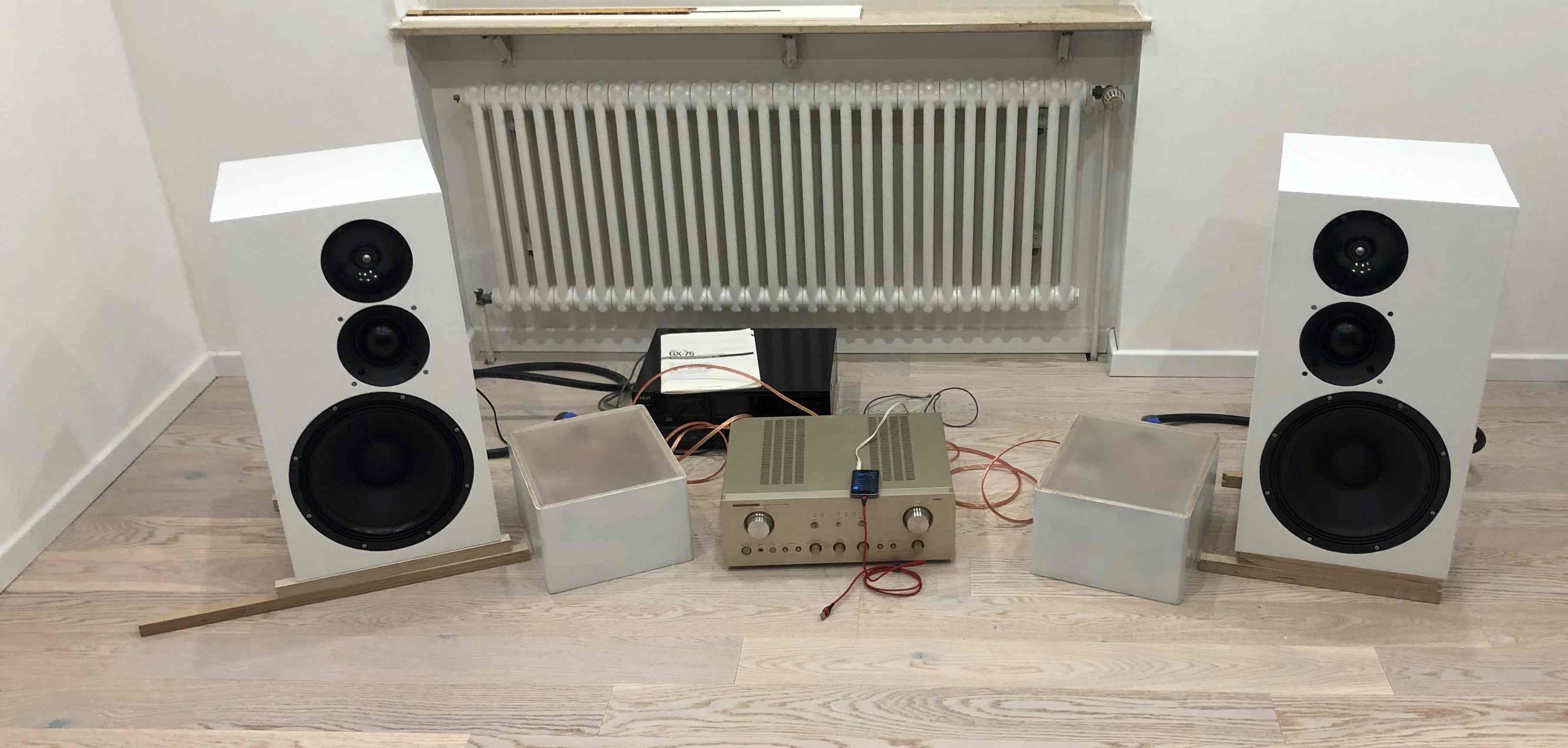

Here you can see my speakers. Finished last week. Playing at the moment with my Marantz and Fiio Player.
Open points:
- black screws
- chassis colour for the crossover
- loudspeaker stands - houpfuly I will finshed the stands next month - than I can move to living room🙂
Sound is realy impessive.
Oh YES!!!!! Fantastic! Great job! Enjoy. Love the white. 😀😀
