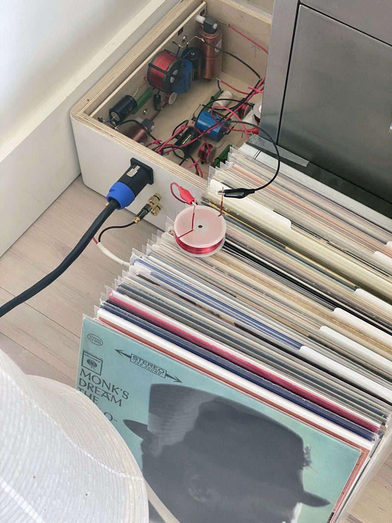

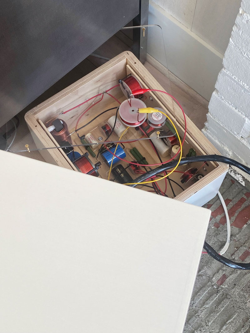

Alright Matthias!! What in the world?
This is NOT so subtle a tweak! Not in my system anyway... It's instantly "more" in the upper mids....I love it. MORE = more details, something new that wasn't there before? I'll know more when I go back to previous at some point..."Balance" could be the word? as opposed to "more"?
Is that what tracks with your intent? Is this backed by charts? Just curious.
...So, THANKS for continuing to play. Haha.
