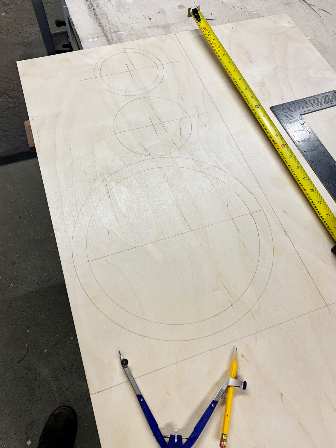

....beginnings....
Wohooo!!! Cool!!! For the front panel routing, I like to wait until I have the drivers at hand. Then I take a piece of scrap wood and adjust my router circle jig until I get a perfect fit for the drivers. Then I use this jig setting for the routing of the front panel.
I just started a list of shops / retailers. Take a look at the first post of this thread and let me know if/what I need to add.
Oh yes, No cutting until parts in hand. Already I can see I will be changing the specs a bit to fit the woofers perfectly—yes—circle jig and scrap—and the right rabbet bit—or plunge cut the rabbet w/ a straight bit before cutting the hole—not sure I have a 3/4" rabbet bit. I will make notes on dimension adjustments and am aiming to keep the interior dimensions exact to your drawing and also the center points of the drivers(?). I'm sure I will have questions—like is the back panel sealed? Did you leave it removable? (maybe I missed this in the thread...apologies).
Also—in terms of general construction. perfect perfect 45 degree cabinet joints are A LOT of work. I'll be using dados with 15-ply, or maybe a combo of cabinet grade 15 and 5-ply. I don't have enough 15-ply in the shop (turntable builds!!) at the moment, and I'm not entirely sure what means what in terms of cabinet construction (all this ply is 18mm thick nominally). AND I could always build another set of boxes—so I'm inclined to be a bit rogue—and use what is sitting here. I can get 15-ply locally (cabinet shop—not the dreck they sell at Lowe's in the US), and probably will pick up some sheets...Also have pro woodworker friends who order from the commercial places and I occasionally tack on to their orders.
I'll be veneering the whole shebang with birch in prep for paint—maybe trying to avoid veneering the fronts since the spacing between the woofer and mid is tight—though that's about to get bigger now that I can measure the actual woofer.
