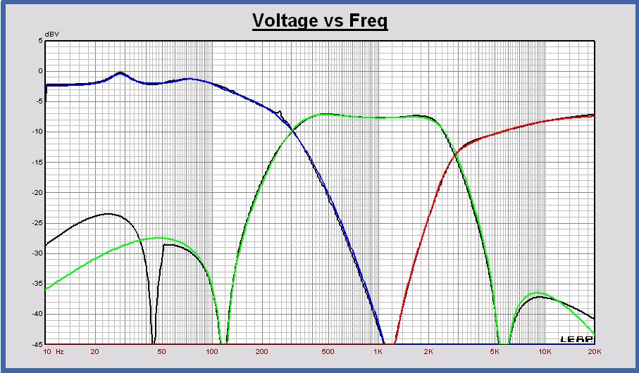

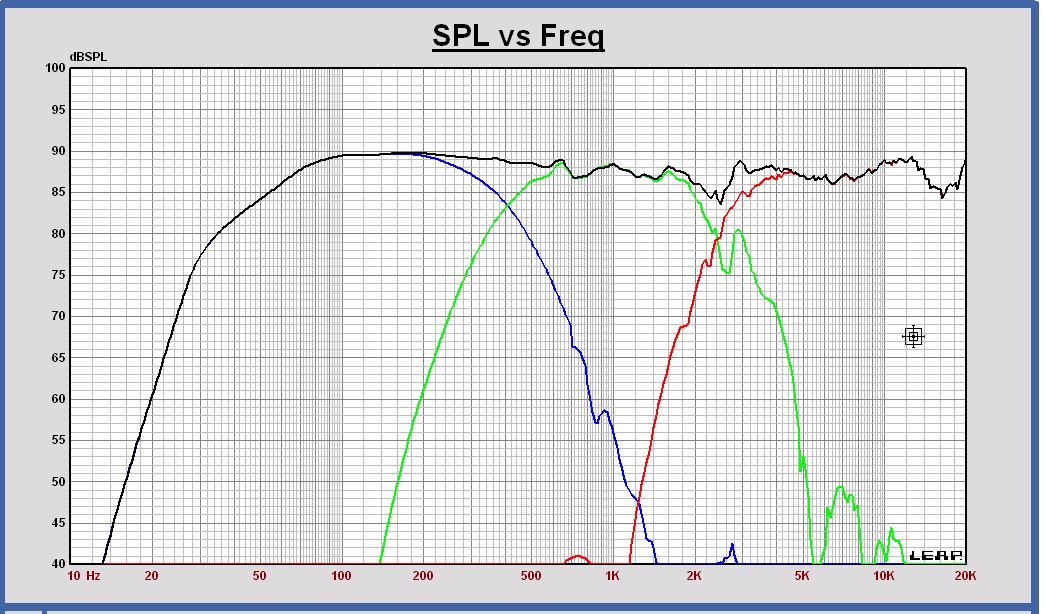

Here are the minidsp configs again that I made for this project around 22/01/2019. The voltage xo transfers of the digital design did fit perfectly on the analog voltage transfer of the analog elliptical filter design at that time. See plot xo transfers (black curves are the analog transfers).
- It is possible to make a new miniDSP version which fits on the last version of the analog filter.
- also possible to make a new infinite baffle design for this speaker (flush mounting for studio), analog or digital.
But it takes some time to make these new designs.
My experience with miniDSP (4x10HD) audio performance is very well. I could make several desings successfully.
