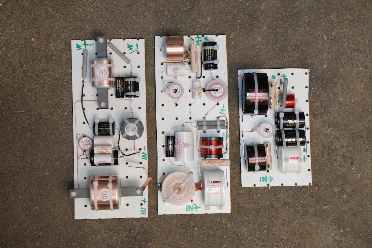

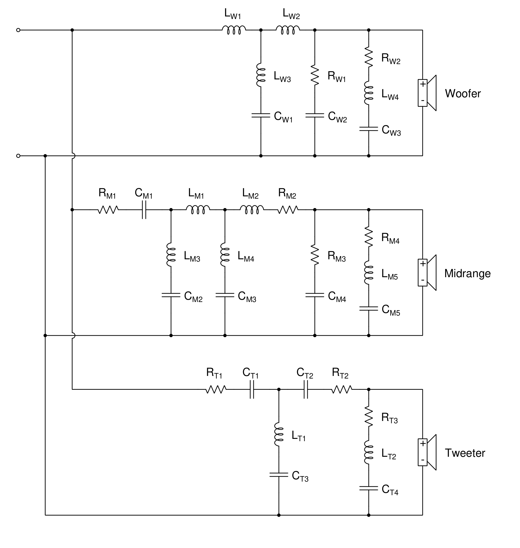

2. Wrong capacitor value in x-over schematic
There was a mistake in the BOM for the x-over in the OSMC docs (wrong: C_M3 = 6.8 uF / correct: C_M3 = 5.6 uF). This error happened because I used the wrong notes when I did the BOM. I found this error in the docs when I re-built the x-over according to the docs, and when I double checked the new x-overs relative to the prototypes there was a different part...

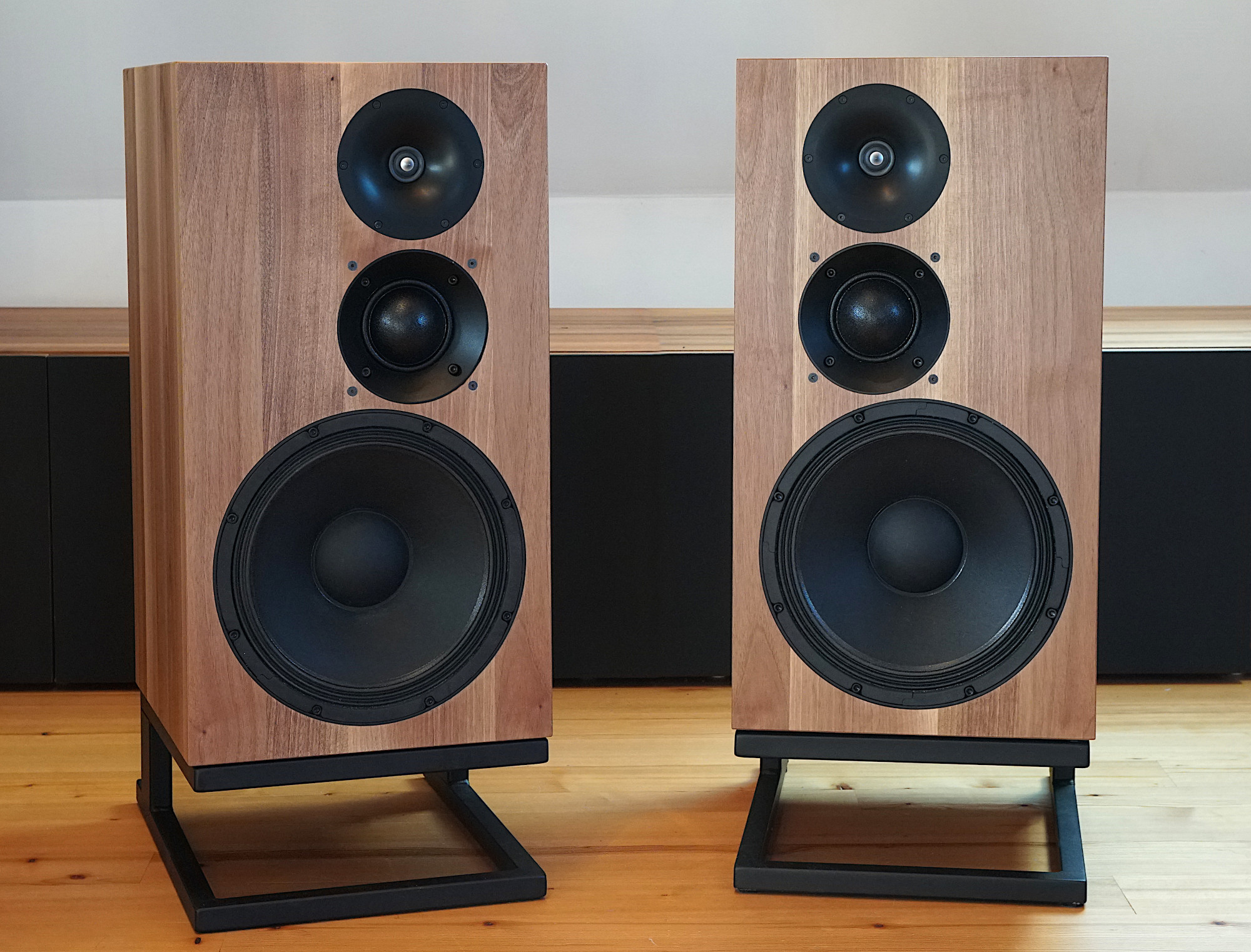

OSMC in the Hobby HiFi magazine!View attachment 811432
Care to translate what they said?
Aehm, well, here's my attempt of a translation:
Open-Source Loudspeakers
Matthias Brennwald and his colleagues of the English internet forum "diyAudio.com" developed a loudspeaker with the aim that it should be easy to build, work well with "simple" amplifiers, and still satisfy high-end requirements. These and other features of the "Open Source Monkey Coffin" (OSMC) were determined by a poll.
A 12-inch FaitalPRO PA driver, a three-inch Volt midrange dome and a ScanSpeak ring radiator with a project-specific waveguide are used in an classic-format enclosure.
Interested readers may find all details about the development of the loudspeaker web address given below. This thread is very long and sometimes confusing (966 posts at the editorial deadline). The documentation available from the second link is clearer, but has not been completely finalized at editorial deadline.
[links to this thread and the OSMC documentation at GitHub]

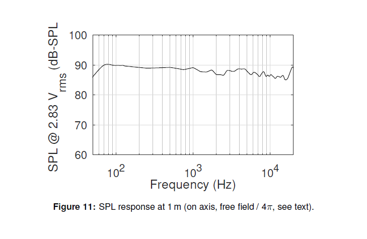

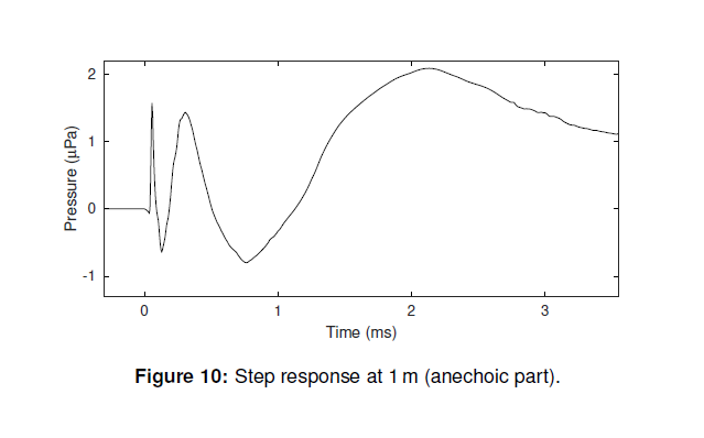

Congratulations on a superb design! I seem to be having a hard time finding a frequency response graph, a distortion graph, both vs frequency on X axis. Also, a step response function measurement would be great to see too. Your speaker reminds me of the $25k ATC SM’s I have always wanted but taken to a whole new level.

795936d1574108687-source-monkey-box-osmc_xover_schem-png
And a XO from Mt Olympus!
769705d1563714025-source-monkey-box-dsc09278-jpg

Frequency response, step response and lots of other graphs and data are available in the docs: GitHub - mbrennwa/osmcdoc: Documentation for the Open Source Monkey Coffin
I measured the woofer distortion early on during the process of choosing the best woofer (the results are somewhere in this thread). I have also done a quick'n'dirty distortion sweep of the whole speaker sometime during the x-over development. However, I never made a proper distortion measurement of the whole speaker. I might do that sometime, but it won't be anytime soon. The speakers are upstairs, where I need them for music listening 😀
Ok, that was a lot of work to get the graph. It wasn’t obvious that the documents would be under “See Code” for Github. I see a single black and white total system response curve which looks very nice. I was hoping to see the usual individual 4 curves overlaid on same plot (woofer, mid, tweeter, combined). This would be similar to your crossover development plots as generated by the XO software. I’ll make a PNG image of the frequency response and step response from your pdf document and post here - maybe you can link it to Post #1. That’s something that should be instantly viewable under a description of a speaker from within DIYA’s servers. It prevents it from accidentally becoming orphaned should a third party server ever goes extinct.
Your document is very nice and thank you for taking the time to write it. Great one point resource.
...Edit
So here, extracted from the pdf and put into PNG file format and now stored on DIYA servers in perpetuity...
Measured Frequency Response - very nice (it would be nice to see the response in finer detail semi-log plot showing small tick within the 10dB major divisions, generally, a speaker of this quality would have plots with 5dB major divisions and 1 small tick per dB, and for the bass, the Hz scale could go lower to show where the -10dB point is):
attachment.php
Measured Step Response:
attachment.php

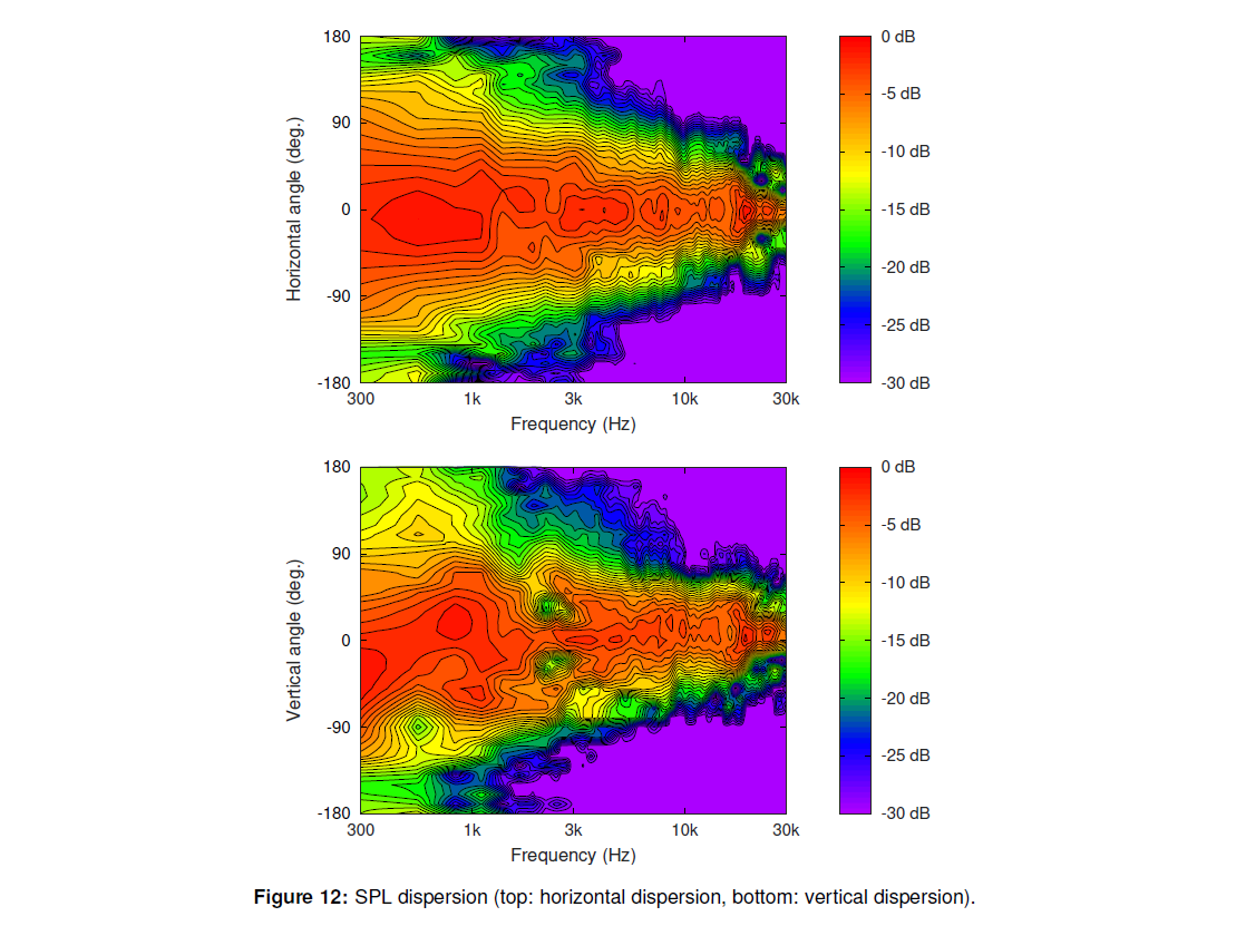

Measured Polar Response:
attachment.php

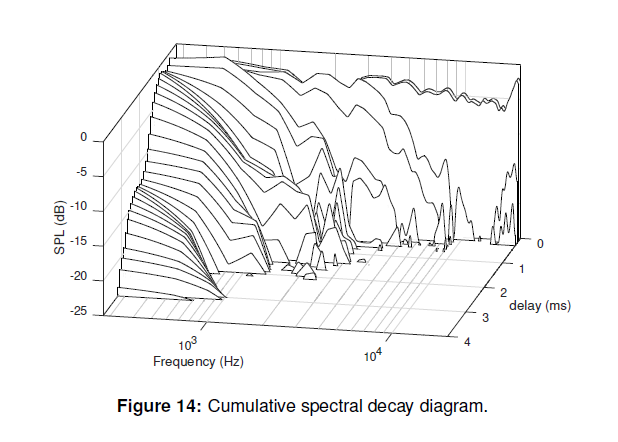

Measured CSD:
attachment.php
