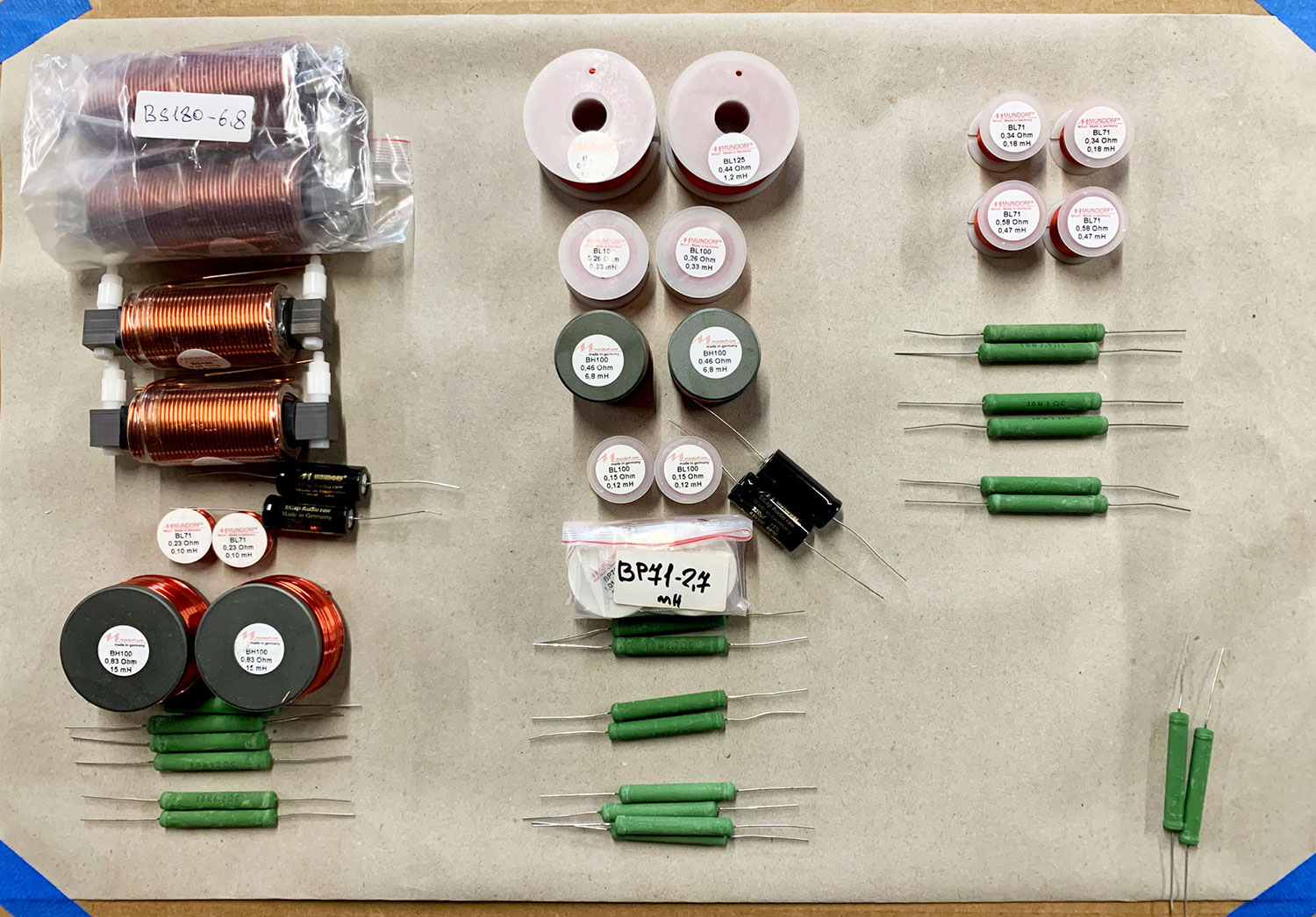

So....have tweeters finally... will cut some baffle holes.
Not very exciting...yet...
But—here you are. You can see some variances in the part values vs BOM—not sure if I didn't understand the ordering/listing...Mundorf's site shows the same values as I received—but for instance, the mid range BL125—BOM shows .39R, part is .44R—when I actually measure it it reads .5R, and most of theses parts are listed as ~+/-20%? My question is how much do these variances matter in the final crossover? Should I unwind some wire to tweak values? I think I understand how that would change R, not sure what that means for mH. And, still missing a whole load of electrolytics—All the other parts are coming from Canada...

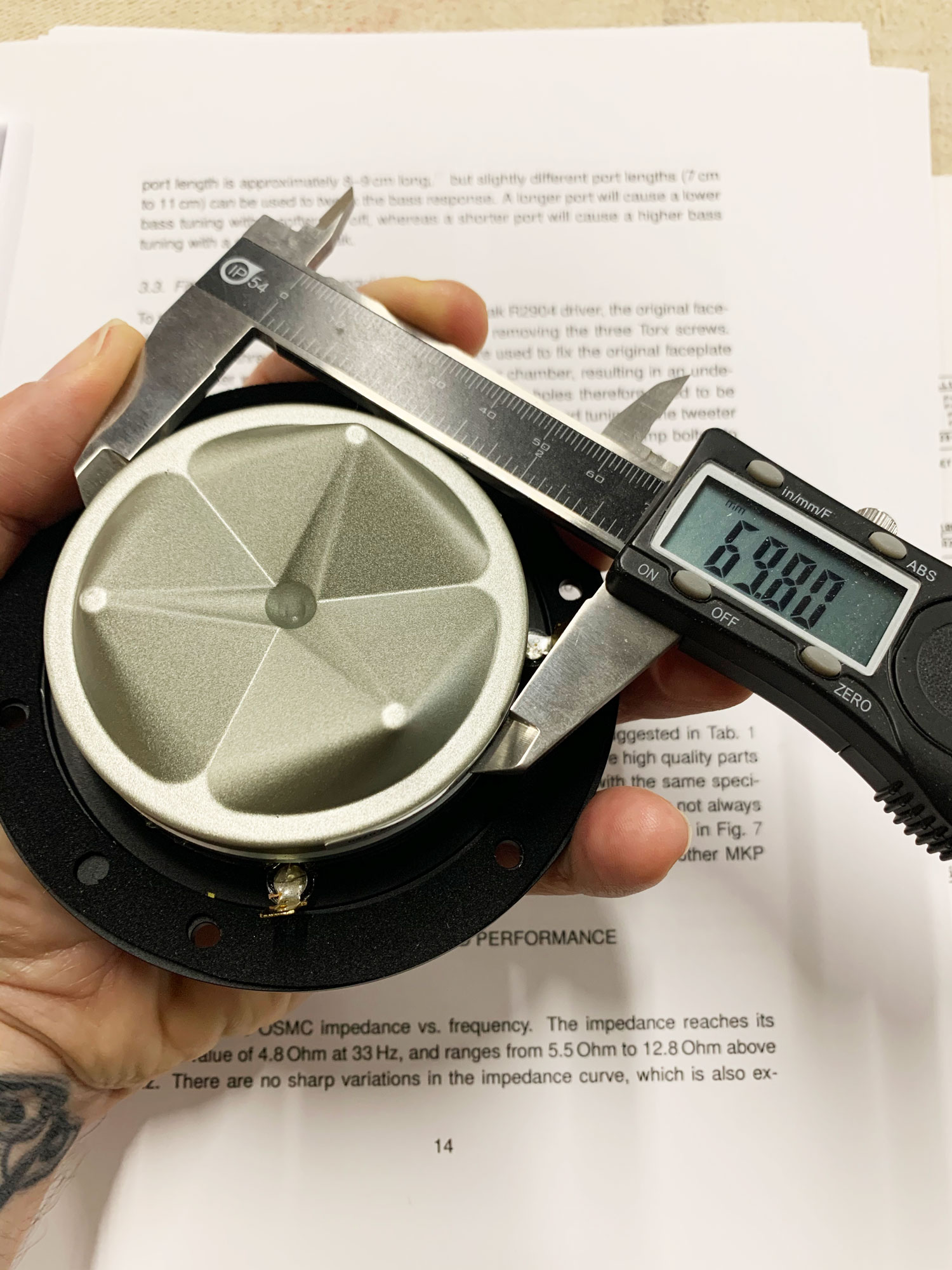

I am going to wait for the waveguides before cutting baffle holes. Need to see what's up in person with the attachment there. The stock tweeter is way smaller than the hole in the cut diagram—it's obviously the waveguide that actually attaches to the baffle? Does that mean that the tweeter isn't bolted to the waveguide? I'm sure it will be clear when in hand... But you mention clamp or glue in the waveguide section. Not sure how I feel about gluing the tweeter? Any details here? Is silicone really enough to hold it and fill the bolt holes as well?

Looking good!
Do not unwind those inductors! The 0.05 Ohm difference is entirely insignificant, and well within tolerance. Unwinding would reduce the inductance (the mH number), which would be wrong.
Yes, the tweeter attaches to the waveguide. You will essentially replace the stock faceplate of the tweeter with the waveguide. There are two ways to fix the tweeter to the waveguide: either use a bar to clamp the tweeter to the waveguide, using the two screw holes on the rear of the waveguide (I had a photo of this, but can't find it at the moment); or use a bit of glue (silicone worked fine for me) to fix the tweeter to the waveguide. This will be a lot easier to understand once you have the waveguides in your hands, and when you removed the stock faceplate of the tweeter.

Roger that! I knew there was a relationship between wire gauge, length, and both values—and I wouldn't just go rogue and start messing about cutting wire etc.

Actually, I was thinking of doing a bunch of aluminium clamps that would fit on the Scan R2904 tweeter. However, since mine are glued into the waveguide and inside the Monkey Coffin, I can't easily access the rear of the tweeters. Could you measure the diameter of the magnet of the R2904? That would be useful to design a nice clamp for the waveguides.
...Could you measure the diameter of the magnet of the R2904? That would be useful to design a nice clamp for the waveguides.
Attached. I may just do the silicone route. No mechanical interferences....
