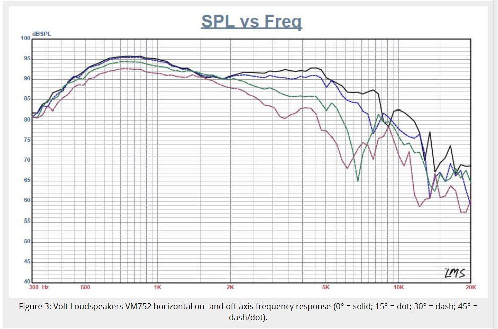

Have you thought of doing a simulation with the mid and tweeter offset also? Here is a review of the Volt that may give some info.
Test Bench: Volt Loudspeakers VM752 3” Midrange Dome Driver | audioXpress
Strange in the Audio Express measurement of the Volt VM752, that there is also SPL fall off below 1 kHz off axis...
Maybe because it is measured in an enclosure and not on a large IEC baffle.

^^ Yes it looks strange. ATC and PMC use similar dome that is no longer available for diy. It has been measured by many others

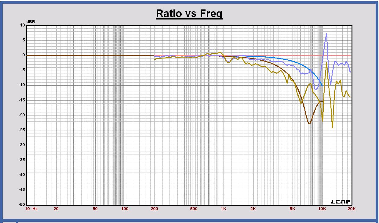

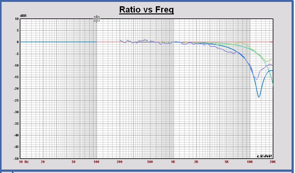

As an information, the horizontal off axis responses on infinite baffle of the tweeter Satori TW29BN and the ATC SM75 3 inch midrange. The responses are normalized to the on axis response.
In both plots the measured data and the Leap simulations to compare. The datasheet curves for the Satori and Troels' measurements of the ATC (post #85). The Leap curves are the more solid curves.
For the Satori tweeter the 30 and 60 deg data is shown and for the ATC midrange the 20 and 40 deg responses.
You can see that for the tweeter the Leap model is matching, for the ATC there is some difference with the Leap 3 inch model, maybe because of the missing waveguide in the Leap model.
We will see what we can be done about it, also with own Volt measurements. To do a first study now, I will use these current Leap models.

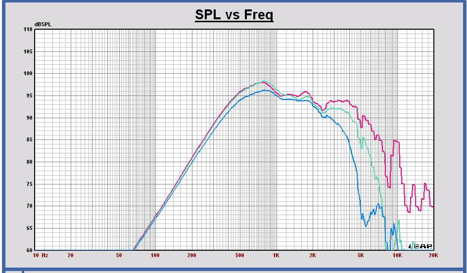

I attached a plot of my own measurements of the ATC SM75-150 (centered on a 23cm wide baffle, and also with 13cm baffle extensions on both sides). The measurements were made with an electronic high pass filter (24 dB/oct, 360 Hz). Looks like the waveguide achieves constant directivity up to about 3 kHz. Maybe that's useful.

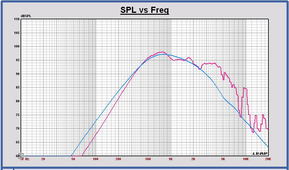

Yes it is constant directivity up to 3 kHz, I also see in Leap by comparing the SPL on axis and power response of the Volt VM752 in the Monkey Box. In attach the plot, SPL in red and power in blue. Technically this is a real top driver.
Looking to your ATC measurements, I understand now why the SPL off axis is lower below 1 kHz in the AudioXpress measurements. It is because it is placed in an enclosure and not on a large baffle. I see the same in the Leap simulation.

AudioXpress mounted the driver in an enclosure with a baflle of 28 x 43 cm, I suppose 28 cm wide.Matthias used 23cm baffle, this project will be something like 43cm...
In attach, the SPL on and off axis 0 30 60 degrees of the Volt VM752 in the Monkey Box simulated in Leap.
Looking at your plot I'd say that an x-over to the tweeter at about 2.5 kHz would make sense -- what do you guys think?

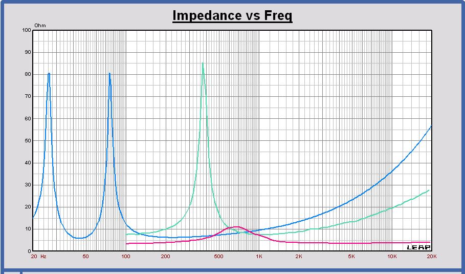

In general I'd suggest to apply full impedance compensation so that the filters see a flatish impedance. For sure, the huge impedance peak of the Volt dome will need compensation to make the high-pass for the Volt dome work. But I guess going all the way by compensating also the tweeter resonance peak and the (upper) woofer resonance peak is a good thing. Same goes for the impedance rise due to the voice coil impedance. This means a bunch of extra parts, but they are a good investment in my experience (and they don't need to be expensive super-duper parts).

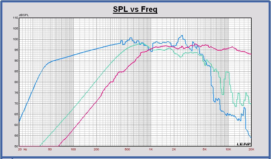

Here are the simulation results of the drivers in the cabinet.
I have added also the frd files for X-over experimenting.
As an information, to realize a F3 = 45 Hz the SPL should be designed at 91.2 dB (full space).
