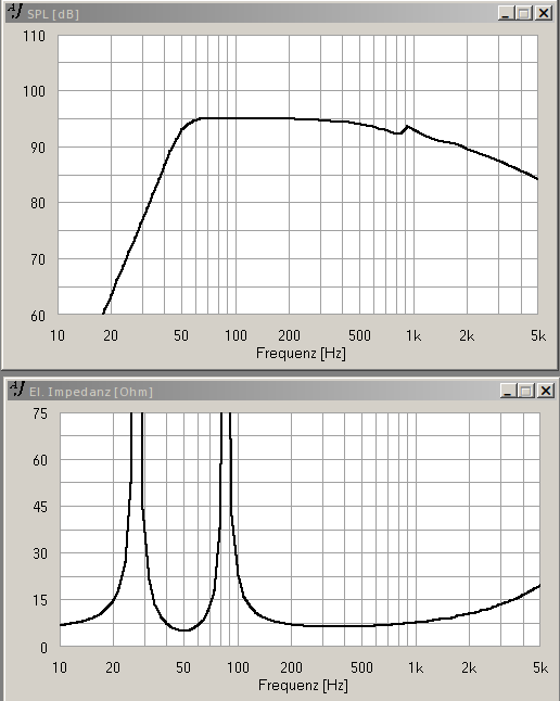

Cabinet = 80 L and tuned at 48 Hz, F3 = 47.5 Hz and sensitivity = 96.3 dB half space.
Qts is too low and Vas too high for a B4 alignment in a smaller cabinet with a F3 lower than 45 Hz.
For a 100 L volume, F3 becomes 43 Hz.

Cabinet = 75 L and tuned at 42 Hz, F3 = 45 Hz and sensitivity = 97 dB half space
Qms=7.8, Xmax=±7.37 mm, Le=0.67 mH

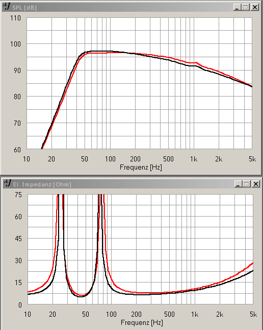

Ok, here's a quick comparison using AJ Horn (black is the Faital 12PR320, red is the D.A.S. 12P). Box tuning as given in the list of the first post. AJ Horn models the effect of the voice coil impedance using the impedance values at 1kHz and 10kHz (taken from the curve charts). I'd say forget about the Le spec values. The D.A.S. actually seems to extend a bit higher than the Faital...

Then you see it's out of spec, less than 92dbw/45hz.
Edit:
I seriously doubt you'll hear any 40-45hz sounds at all from that design, such a sharp roll off often has the by-product of lots of phase issues at port resonance, efficiently nulling sounds under a certain point. Even if you can measure the sound, I doubt you'll hear much of it. I doubt there's much sound anyone can hear under 47hz looking at that response chart.
Edit2:
Or maybe it's me who misunderstood, I thought we where going for 45hz 92dbw or more. If the goal is something different please tell me.
