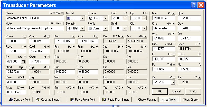

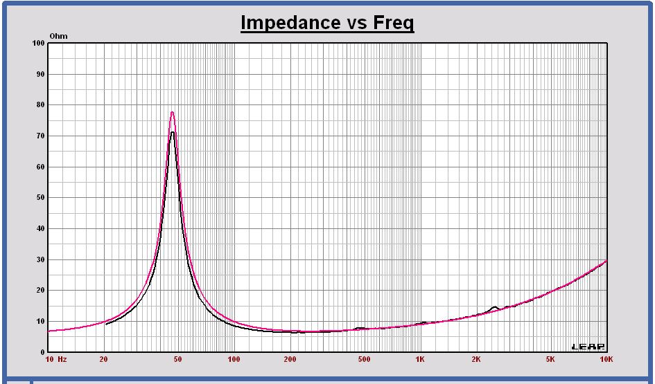

Changing BL in a model for the best fit on a measured curve goes very hard w.r.t. TSP values.
If I use the fit like in the plot with BL=13.5 N/A and Qms = 5.9, the calculated Qes becomes 0.43, conform your results
That is the reason I am asking for the measurement conditions, because a TSP calculation is so sensitive.
The Leap TSP calculation is correct. It is conform the Clio TSP calculation too, I have checked that earlier.

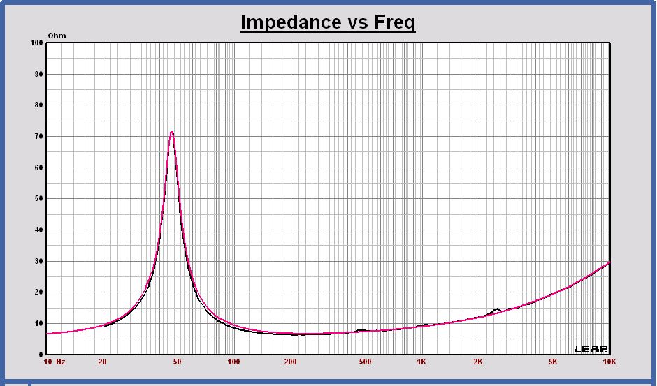

Hmm, the LEAP screenshot says Qes = 0.463 (not 0.43), and the peak of the model curve is a bit wider than the measured peak. Can you try Qes = 0.43 and Qms = 5.7 to see if our calculations are consistent?
A mistake from my side sorry.
If I force Qes to be 0.43, the BL becomes 14 N/A and the impedance peak becomes wider. For the best fitting not the right direction (in Leap).
  • Faital 12PR320 Imp meas vs. Leap model measurement Qes=0.43  Qms=5.9 BL=13.5.JPG

In attach the adapted Faital Leap model with your last mean values.
