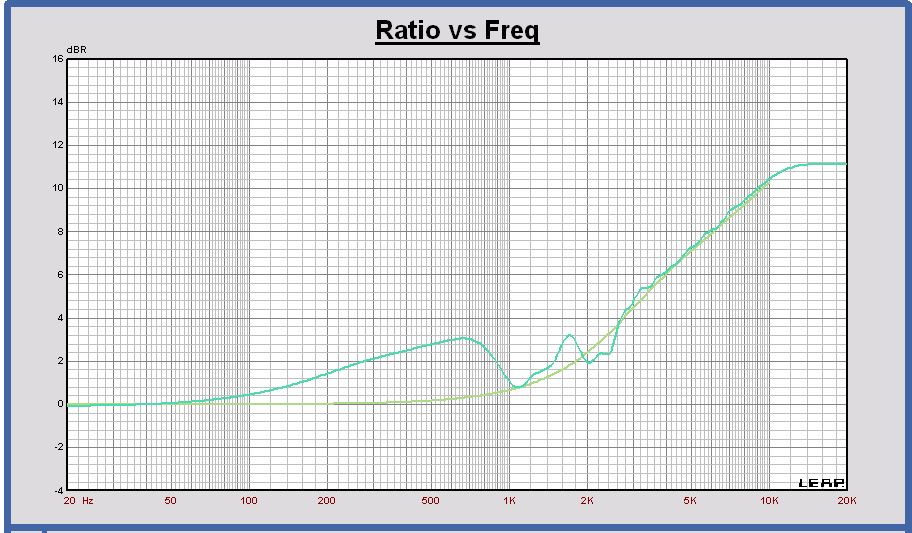

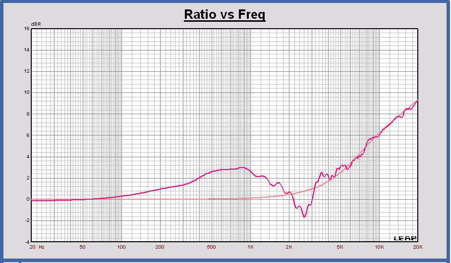

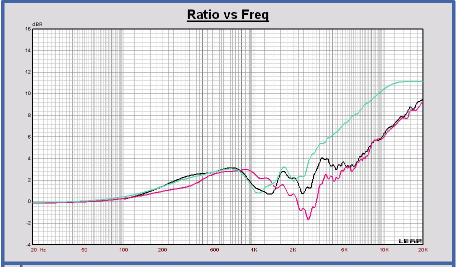

I am looking to the Directivity Index (DI) of the Monkey box. I started a tweeter waveguide study using the Leap simulator, I think it is possible to simulate it.
I used the measurements of the Monacor DT300, with and without the Monacor WG300 waveguide, to define a transfer of that waveguide as a function of frequency and of the horizontal on and off axis angle. I have a waveguide transfer now of the WG300 at 0, 15, 30, 45 and 60 degrees horizontal on and off axis.
At first I have simulated the single-half-plane (horizontal) DI of the Monkey Box design with the LR4 X-over and the current driver models, without a waveguide for both.
See these results in the plot of the DI of the Volt VM752 (green color), the Satori TW29BN (red color) and the LR4 filtered sum of all drivers (black color) in the Monkey Box.
The large dips at 1 kHz for the midrange and the 2.5 kHz for the tweeter are not good. Waveguides are needed (the midrange already has).
Remark that these dips are not seen on infinite baffle, they are mainly caused by bafflestep and diffractions.
Look to the DI of midrange and tweeter in cabinet and on infinite baffle in the plot. Infinite baffle curves in light color.

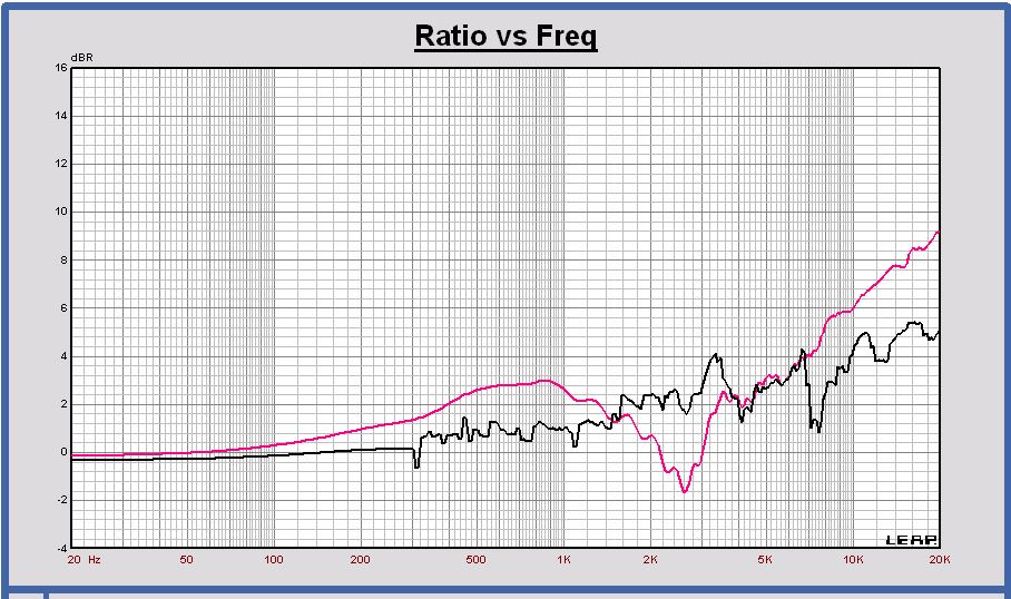

Applying the WG300 waveguide on the tweeter in the cabinet in the following plot. The DI improvement for the tweeter can be seen.

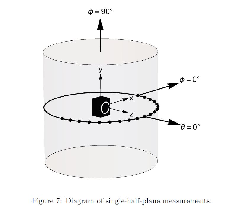

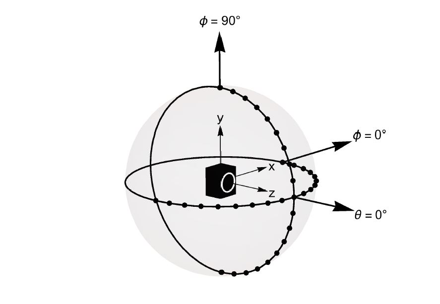

As an information, in attach the diagrams of the single-half-plane measurements and the single-hemisphere measurements, that are used for the DI calculation.
At this time the single-half-plane measurements are used for the DI calculation. Later single-hemisphere measurements can be used to see the impact of the X-over filter on the vertical dispersion also.

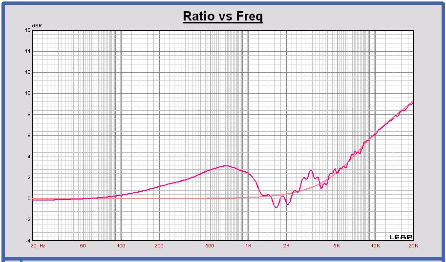

Again a long story, I did some analysis of the DI of both midrange and tweeter in the Monkey Box, both drivers without waveguide.
At first the comparison the DI of both drivers on infinite baffle and in the Monkey cabinet.
In the plots the most smooth DI is on infinite baffle.
midrange
tweeter
For the midrange the DI in the cabinet is mapping on the infinite baffle DI (= no impact of cabinet) down to 1kHz and below 1 kHz the DI in the cabinet becomes higher due to the bafflestep of the cabinet. Applying a waveguide to it (like with the Volt VM752), probably the irregularity around 1.8 kHz will become better, and the DI will become a little higher above 1kHz. But the bafflestep boost below 1 kHz will not be changed by a waveguide.
For the tweeter the DI in the cabinet is mapping on the infinite baffle DI down to 3kHz. Below 3 kHz the DI in the cabinet has a dip at 2.5 kHz. This dip is related to the tweeter distance from the top of the cabinet, which is now 9 cm. Below 1 kHz the DI becomes higher also due to the bafflestep, just like the midrange. Applying a waveguide to the tweeter, probably the dip around 2.5 kHz will disappear. The bafflestep boost below 1 kHz also will not change. Above 3 kHz the DI will become higher.
By increasing the tweeter distance from top to 15 cm, the DI dip appears at a lower frequency, see in the plot below. Maybe a better match with the midrange can be obtained for a more flat combined DI with X-over.
tweeter 15 cm from top
Looking to the combined DI with LR4 filter at 2500 Hz without waveguides.
Adding a waveguide to the tweeter the dip at 2500Hz will be better. The dip around 1 kHz, I am afraid it will not disappear by a midrange waveguide like implemented in the Volt VM752, we have to check that with measurements on the Volt driver.
Applying the tweeter waveguide will increase the DI above a few kHz and decreasing the global power of the tweeter. I am afraid that maybe that power loss is not so good in combination with a 3 inch midrange. In combination with a larger midrange, it is different, now I have some doubts about the tweeter waveguide. I think we can evaluate that with IEC tests and simulating the global power of the design.

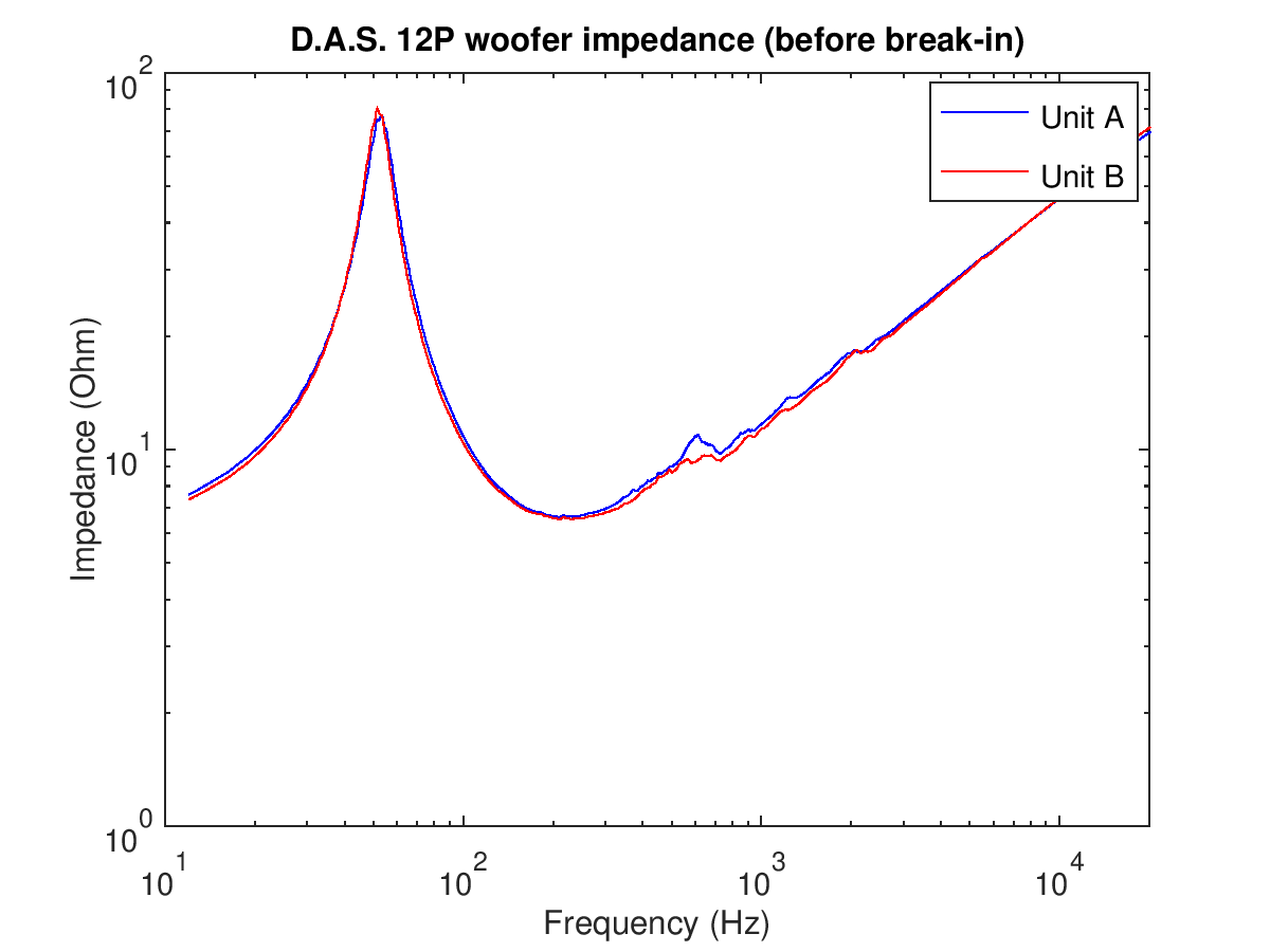

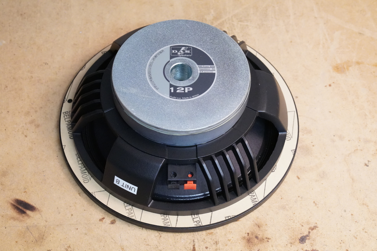

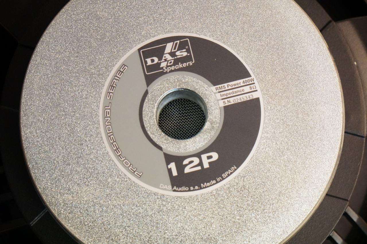

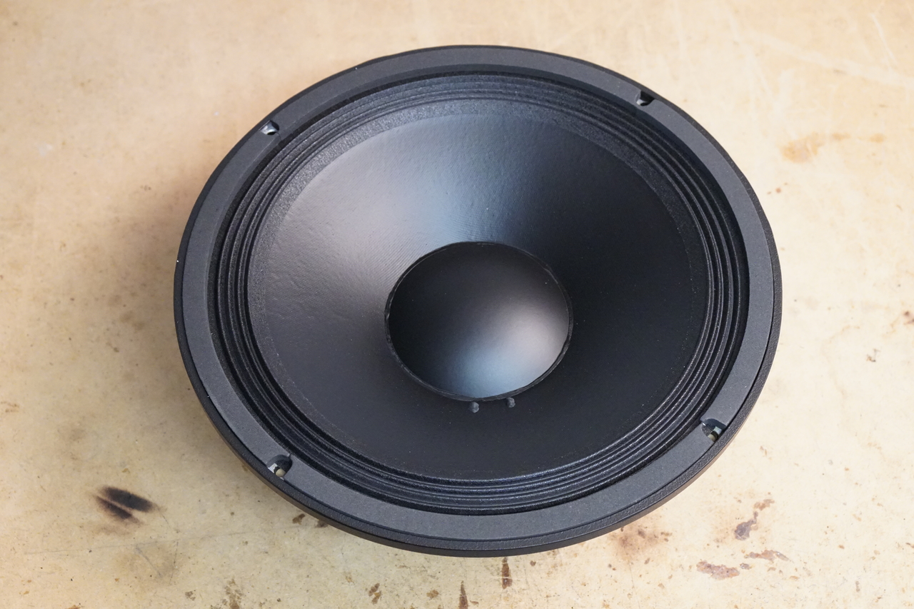

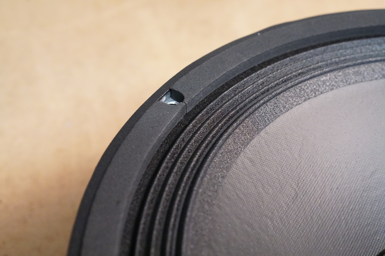

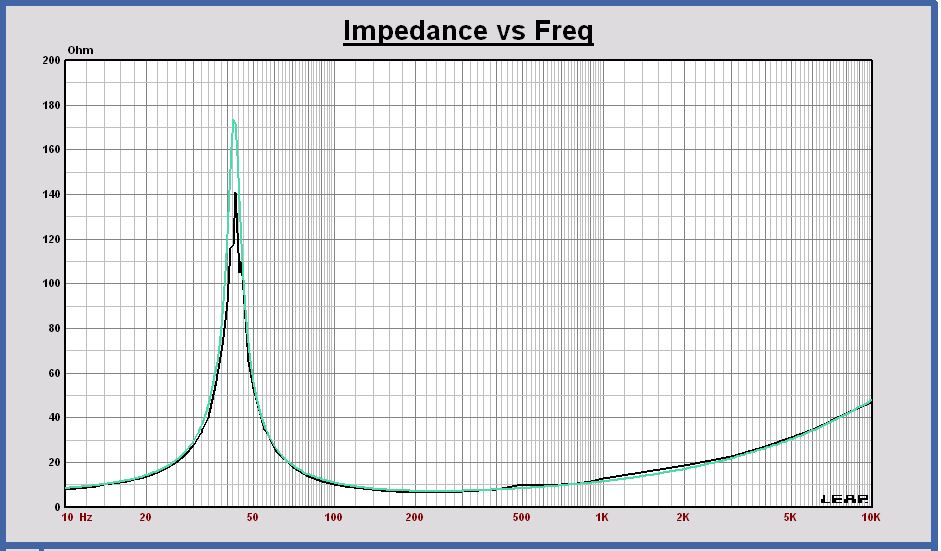

The D.A.S. 12P woofers arrived today. I made a few photos and some first impedance measurements (attached). The build quality of the drivers looks good to me, and the impedance curves match nicely. The woofers are now breaking in (15 Hz sine at 10 Vrms over night). I will take proper impedance measurements after break in.
We can already start with TSP check 🙂.
If you have the frd's of impedance responses, they are welcome.
The drivers first need some break-in to loosen the suspension parts. After a few hours of 15 Hz sine @ 10 Vrms this night, the resonance frequency decreased a bit from 52 to 48 Hz, and the impedance peak max. increased from 77 to 93 Ohm. This is not yet consistent with the datasheet says (42 Hz, 200 Ohm max.). I'll continue with the break in and see what happens.
After another 24h with 15 Hz at 20 Vrms, the impedance curve does not change anymore. These PA woofers take quite some beating to break in!

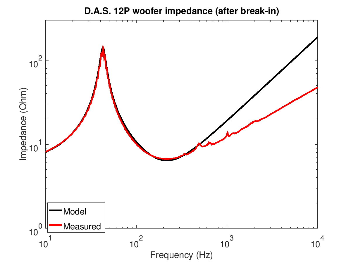

I let the driver cool down from the break-in and then measured the impedance curve. I did a quick and dirty calculation of the Thielle-Small parameters from the impedance peak (black curve in attached plot):
Rdc = 6.3 Ohm
f0 = 42.8
Qes = 0.33
Qms = 7.1
These values are consistent with the manufacturer specs, except Qms is a bit lower. I could not get the Le part of the impedance curve right with my simple model (or maybe I didn't try hard enough).
Impedance data is attached (FRD file, had to add a ".txt" extension for the upload to diyAudio). Paul, can you check my TSP values?
I hope the Faital 12PR320 drivers show up soon, so that we can compare them. BlueAran used DPD for shipping, which means I might never get them...
I had to edit the frd, too many samples for Leap. I don't know exactly the limit.
I never take more samples than a few 100 in a frd for Leap import.

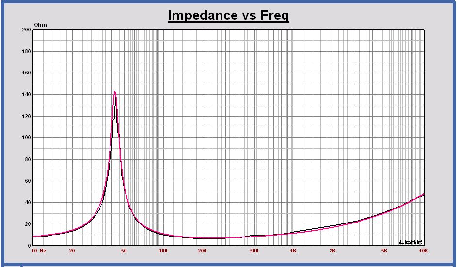

It looks very good. If I only change Qms to 8 in the Leap model made with datasheet TSP, your measurement fits perfect on the model.
In the plots your measurement in black, the Leap model made with datasheet TSP values in green, and the adapted Leap model that fits on your measurement in red.
So all TSP of your drivers are conform datasheet except the Qms is a little lower.
That's good to see.
Just out of curiosity, I wonder how LEAP models the impedance rise above the low-frequency peak. Do you know that? Does the manual say how the LEAP model works (formula, circuit model)?
