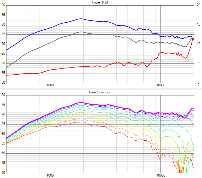

R 7000 in WG measurement is in the attachment, it is WG170mm, prototype, profile is not exactly what it should be as carpenter sanded too much. I should have new prototypes soon. Anyway, I hope it shows some potential for your application and development of your WG.
Measurement conditions:
- drive voltage not specified, I estimate ~2V
- mic distance 1m
- gatting window 3.6ms
- no smoothing
- measured in cabinet in the attachment, 220x460mm
To mount these scanspeaks to WG you have to remove the faceplate and make the saddle for tweeter which also centers it.
- mic distance 1m
- no smoothing

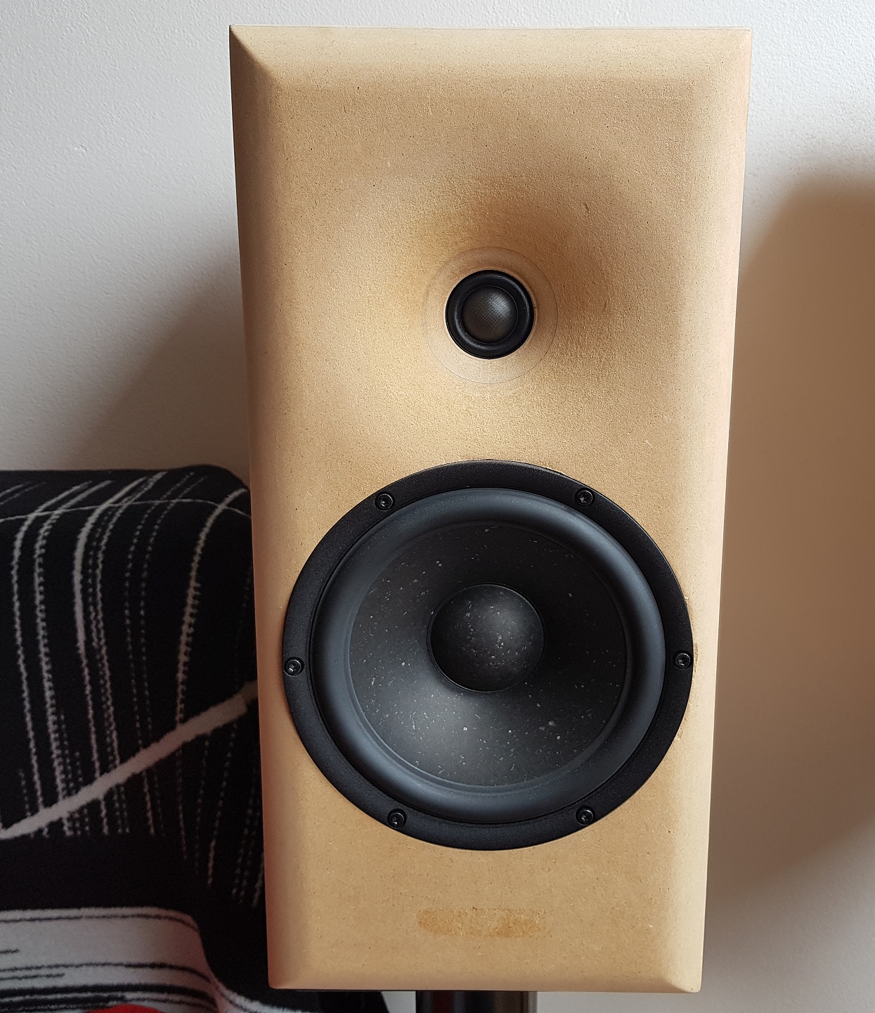

Ok, thats a bit more involved than the simple kitchen table approach that we have in mind to make the Monkey Coffin "novice friendly". But maybe the WG148 can be adapted to the Scan using easier tools, a bit like what I did here using the Monacor WG300. If a custom 3D printed waveguide is possible, that might be best.
How deep should the waveguide be? Would it make sense to align the voice coils of the tweeter and the midrange?
There are companies online providing different methods of 3D printing services (along w laser cutting, engraving ...) if one does not have direct access to a 3D printer.
I worked w Sculpteo before, very helpful and very affordable and also quick !
If the result of tweeter/WG combo is close to constant directivity, and dispersion is same for the midrange at crossover frequency, in that case I found LR4/LR4 more suitable. It results in almost perfect power response (based on horizontal measurement). Of course, when vertical response is included into equation, power response and DI have dip/bump at the crossover frequency.
For XT25 in WG300 + P17RCY I used LR2/LR2 which created smooth mid to tweeter transition, but for this combo DI is monotonically rising.
In both cases it is benefical to have tweeter acoustic center roughly aligned with midrange. It makes crossover modelling and obtaining good phase tracking easier.
