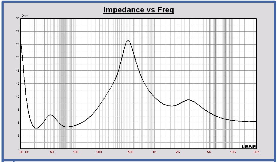

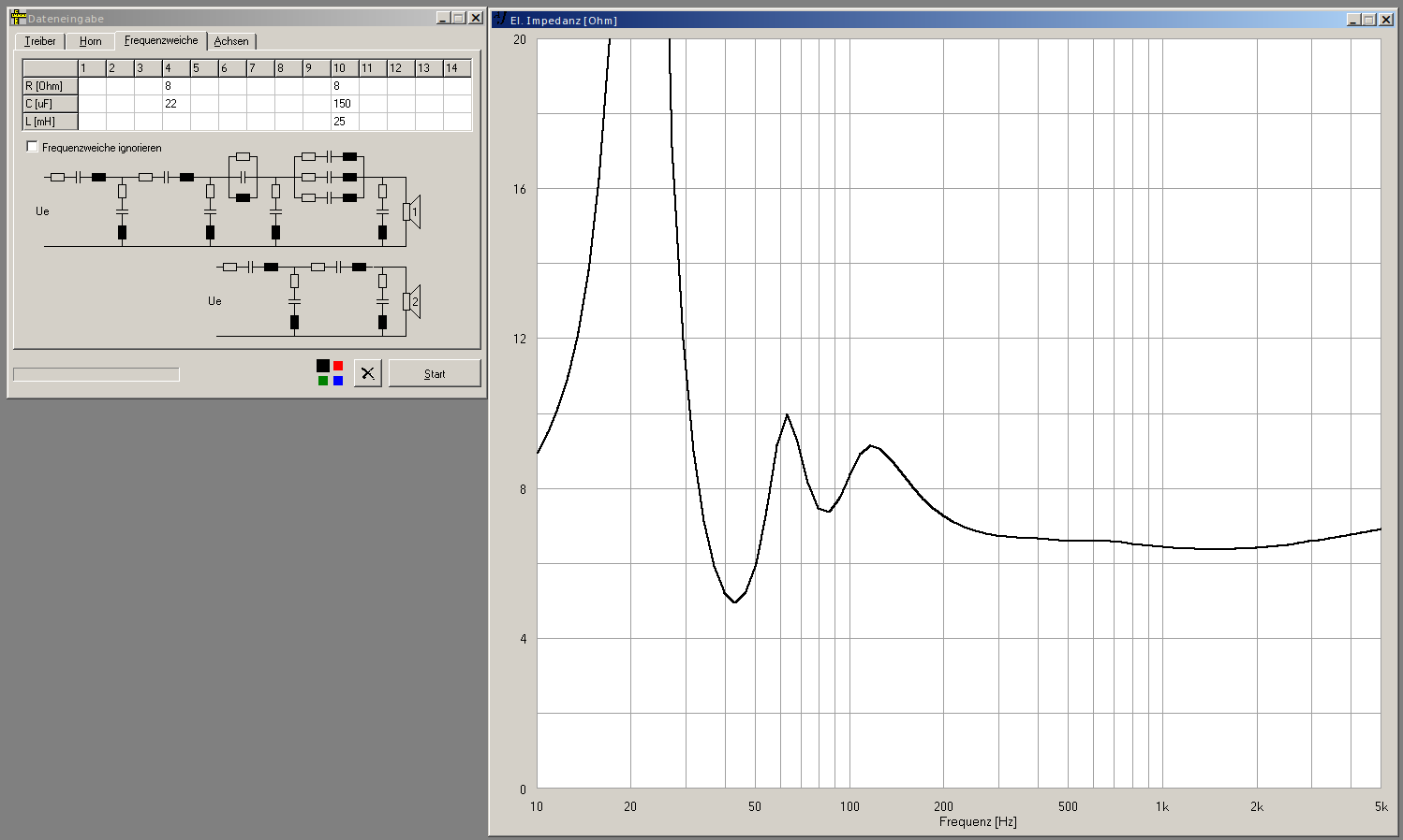

Yes it is about the LCR in the bass section.
To realize a smooth SPL response an LCR with this bandwidh is needed.
It is not possible with a smaller bandwith, then you get big ripple on the SPL, because the impedance is not flat anymore...
The lowest impedance peak is attenuated but not compensated.
The LCR is designed to compensate the highest impedance peak completely. It is optimized looking to the SPL mapping on the low frequency target.
The SPL is very sensitive to LCR value variation also. Again an argument to make the Q of the basreflex not too high.
Here's my attempt on the impedance peak compensation. The minimum is 5 Ohm at about 42 Hz (this is with the D.A.S. driver in a 65L box). Add a bit of series resistance for the series inductors and the dip will end up being slightly higher than 5 Ohm. Still not great, but there is hope.
Once the final woofer, basreflex and X-over concept are defined, we will solve it for sure. A minimum impedance of 5 Ohm is possible and adding some serial resistance even more.

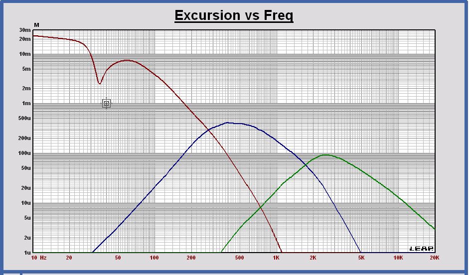

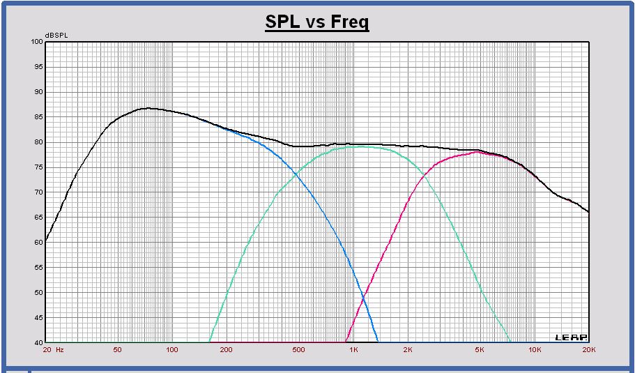

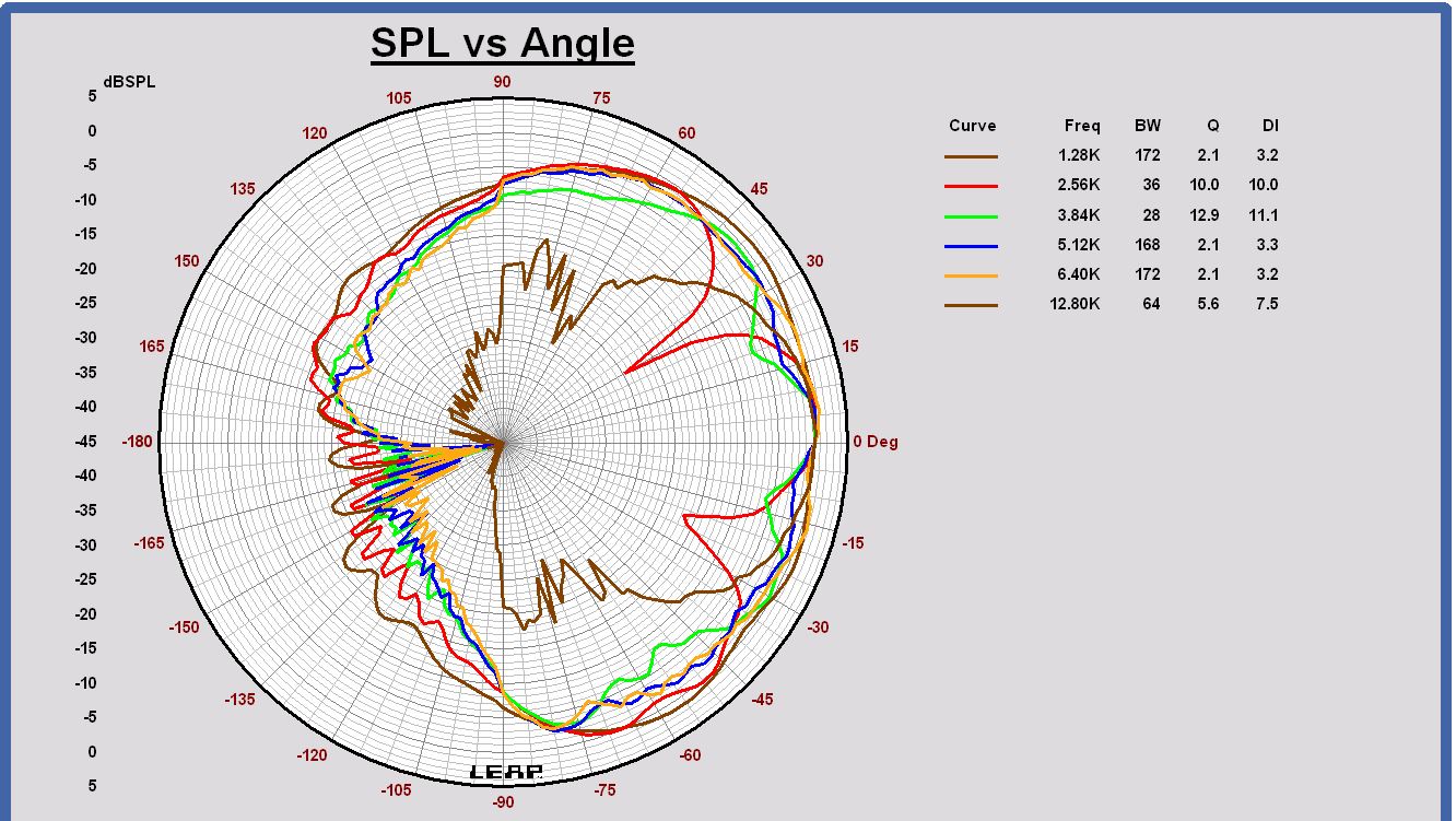

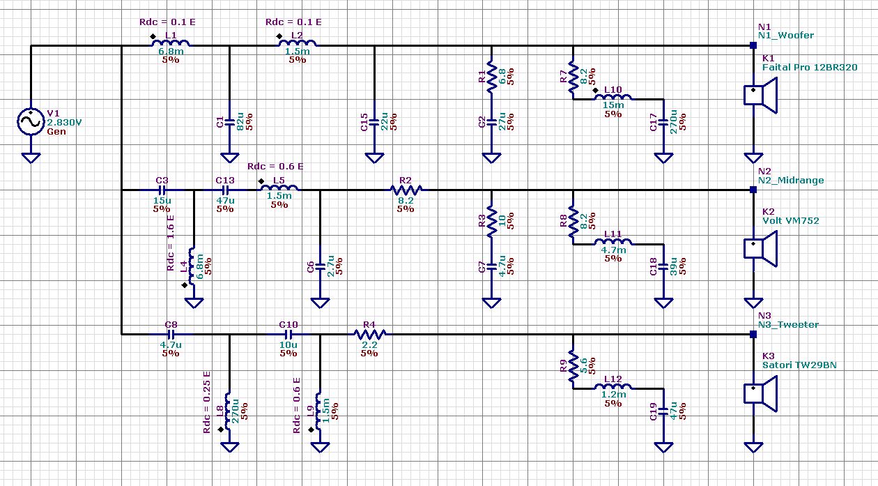

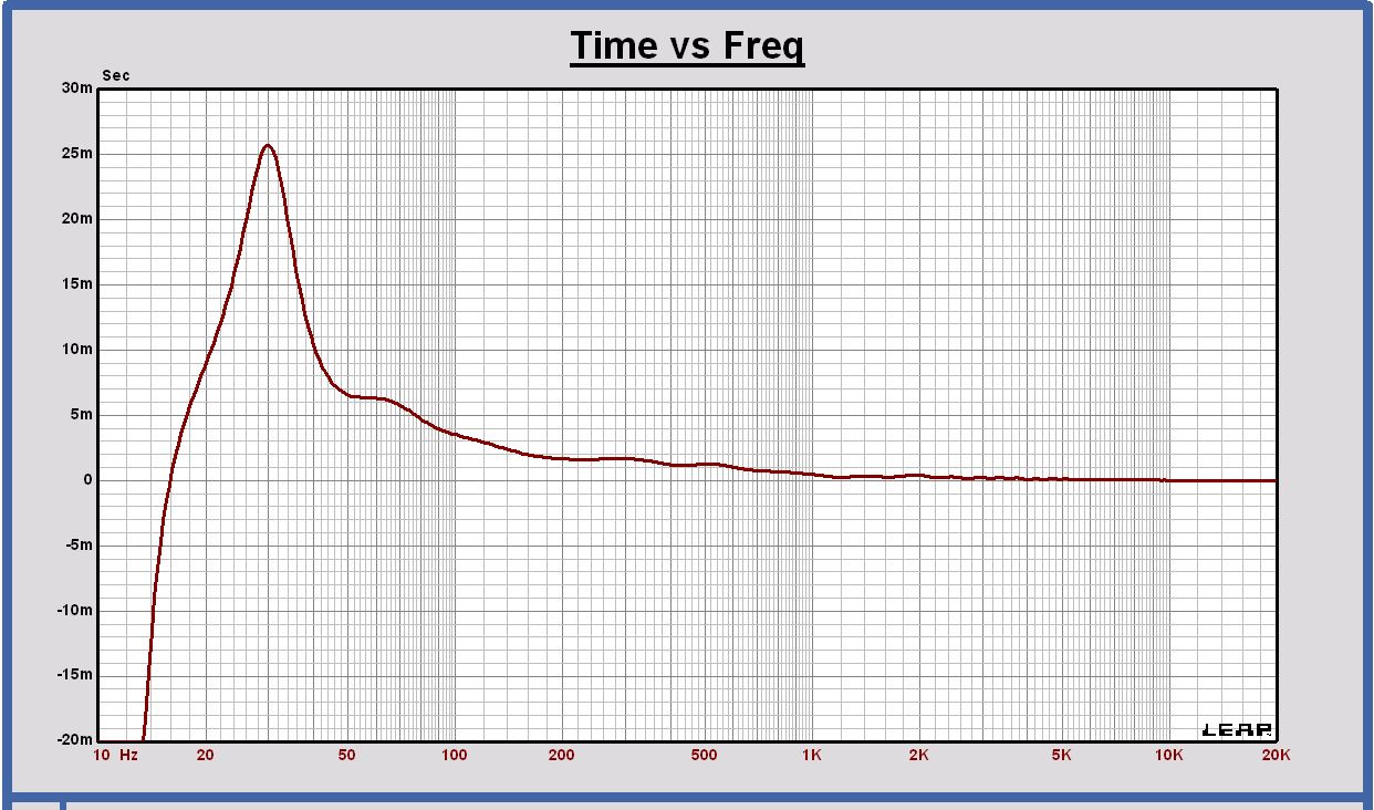

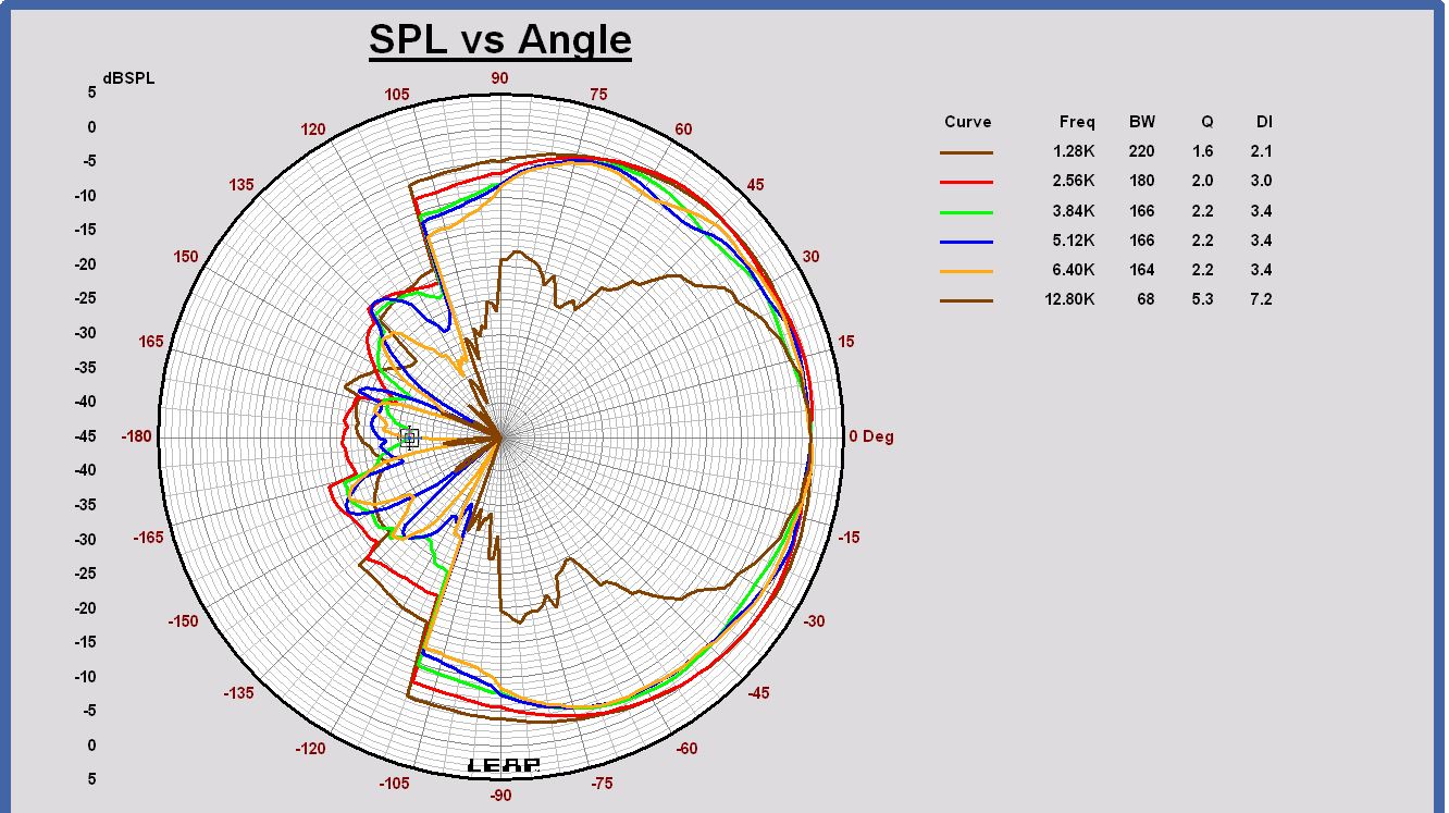

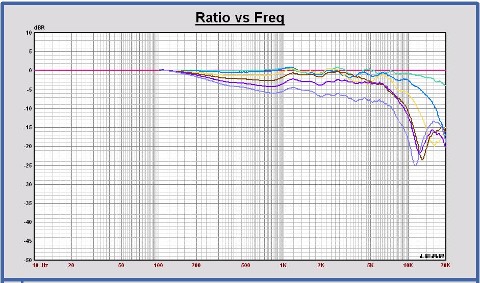

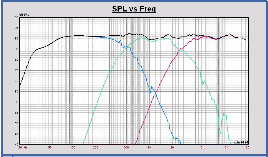

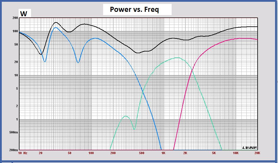

Some simulated plots for an overview of the Monkey Box with a LR4 filter at 500 and 2500 Hz.
Drivers are Faital Pro 12PR320, Volt VM752 and Satori TW29BN.
Woofer in a 80 L basreflex enclosure tuned at 35 Hz
Simulation is based on the driver data sheets.
In attach:
- Schematic X-over
- SPL vs. Freq on axis @ 1m, 2.83Vrms
- Power vs. Freq @ 3m, 2.83 Vrms
- Total Impedance
- Total group delay
- Excursion of the drivers at maximum SPL
- Amplifier power and power dissipated by the drivers at maximum SPL
- Horizontal off axis SPL 15 30 45 60 75 90 deg normalized to on axis SPL
- Horizontal polar diagrams above 1 kHz
- Vertical polar diagrams above 1 kHz
Some remarks:
- Maximum SPL at maximum excursion of the woofer is 110.6 DB @ 1m, 27 Vrms on the input.
- Minimum impedance is 4.65 Ohm using a 0.1 E serial resistance for each filter coil of the woofer filter. It can be improved by increasing the total serial resistance a little.
- At maximum excursion of the woofer at 59 Hz, the midrange excursion is maximum 409 um at 395 Hz and the tweeter excursion is maximum 91.8 um at 2460 Hz. Below 31 Hz the woofer excursion becomes higher.
- The horizontal off axis response is the best on the right side of the speaker if the midrange and the tweeter are positioned at the left side. The difference is low.
- Impact of internal cabinet resonances not included in this study
As a conclusion of this study, Monkey box with this concept is a feasible design. Choosing other woofer or tweeter with comparable characteristics will not change a lot.
Other X-over filter types will have comparable responses in the driver passbands.
Edit: The current horizontal off axis SPL simulations are done with the actual Volt VM752 Leap model without waveguide.
With waveguide the off axis responses will be different, but not that much. Now it will give already a first idea. See also post #88.
Horizontal off axis 15 30 45 60 75 90 normalized to 0 deg Monkey Box LR4.JPG155.3 KB · Views: 149
