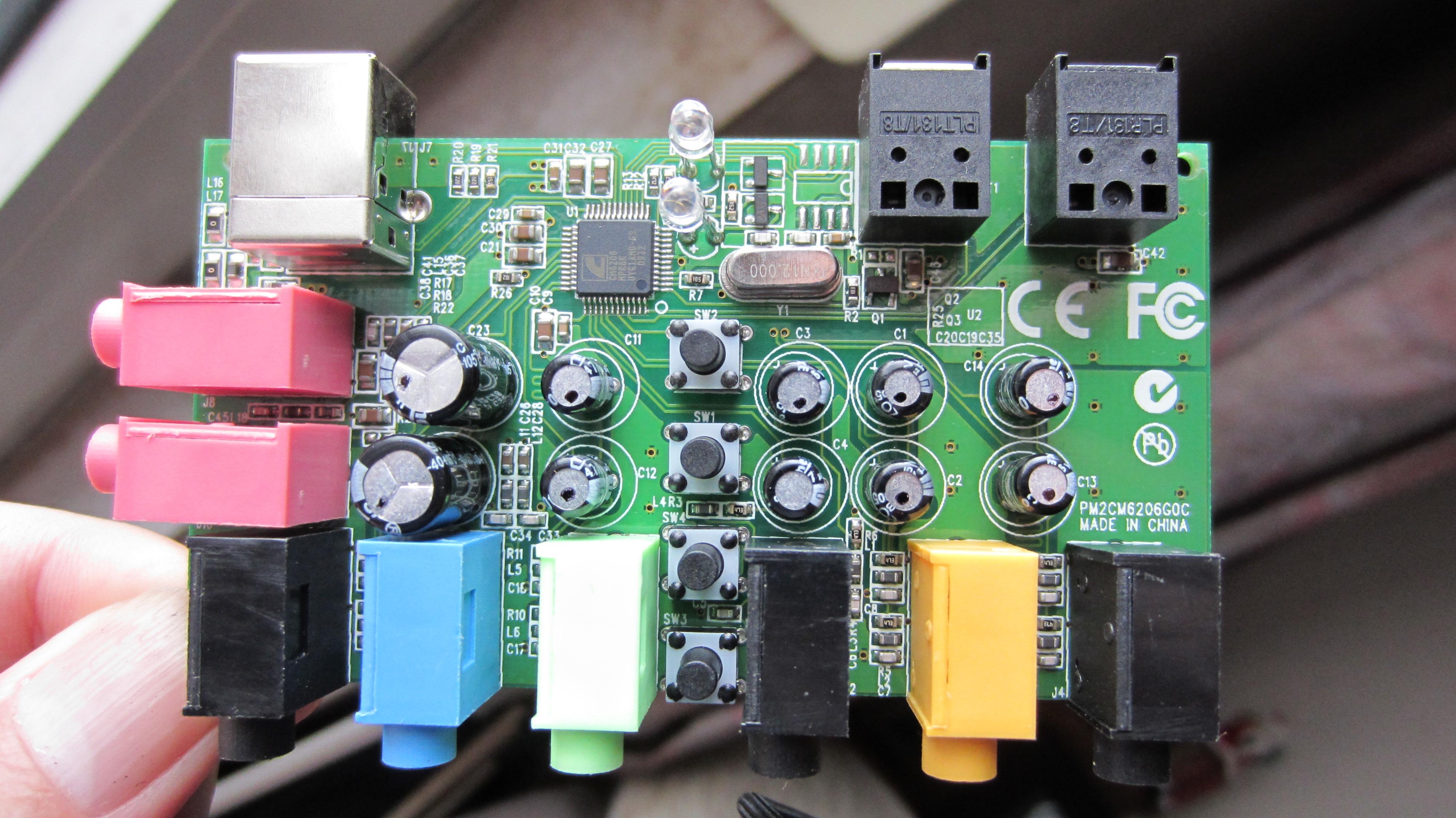

This is the mulitchannel xmos usb interface I referred to.

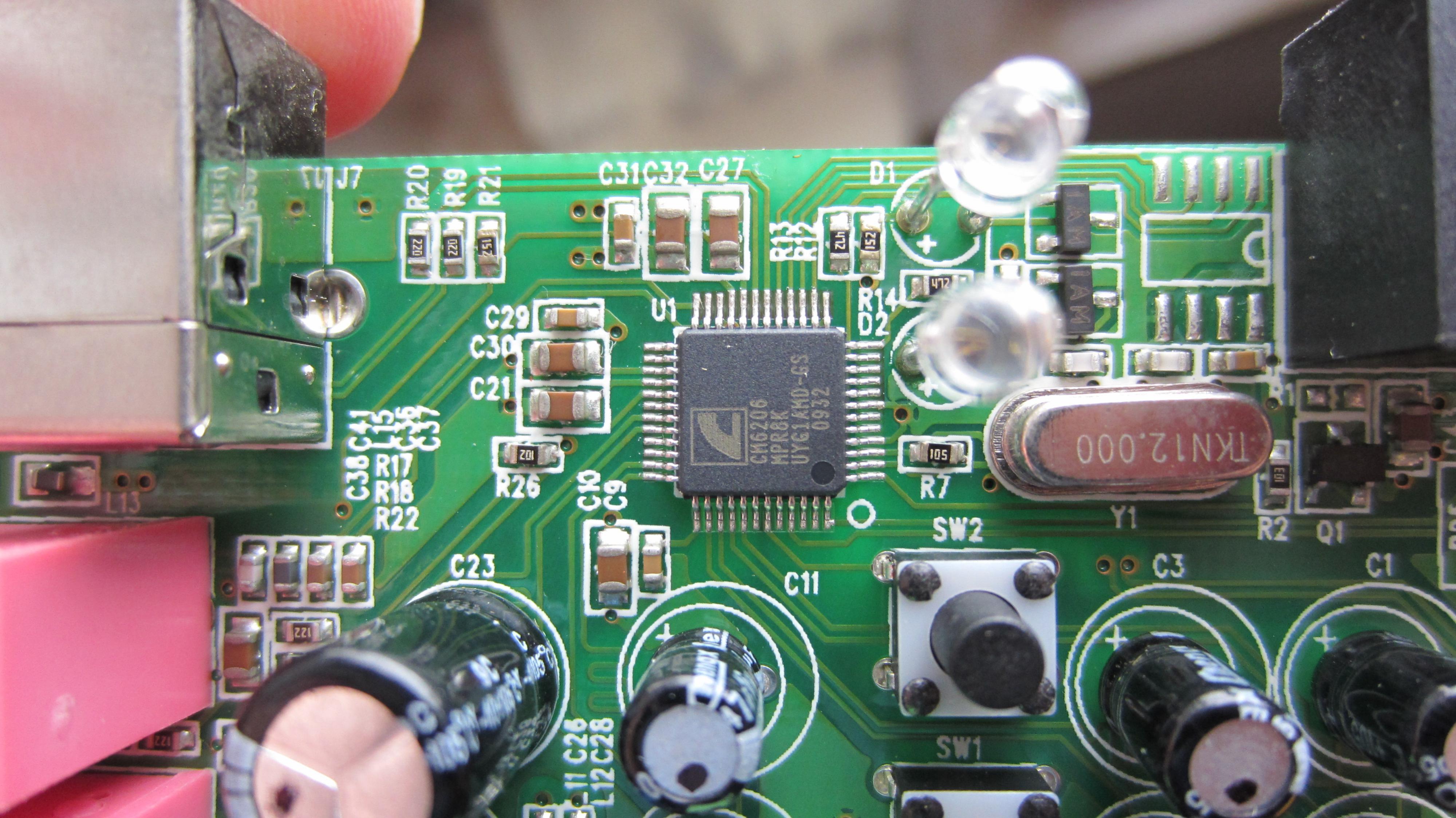

Looks like a joke, overkill. We don't need programmability here. Isn't there a 28-pin chip from Wolfson, T.I. or Cirrus specializing in "bit perfect USB 2.0 audio", a chip costing no more than 2 dollar, eating less than 20 milliwatt, delivering the required I2S and TDM lanes ? This is mass market. What kind of USB interfacing chip do we find in a 7.1 External USB Sound Card like the 7.1 External USB Sound Card - SC016 ? Reaching some "bit perfect" quality as advertized by XMOS doesn't justify a 50 x silicon cost increase.
the 48-pin SWEEX SC016 chip reads :
CM6206
MPR8K
UYG1AMD-GS
0932
It is 48-pin because it also contains all the ADCs, DACs and SPDIF-in and SPDIF-out.
This is the sole and only chip in the SWEEX SC16 box.
