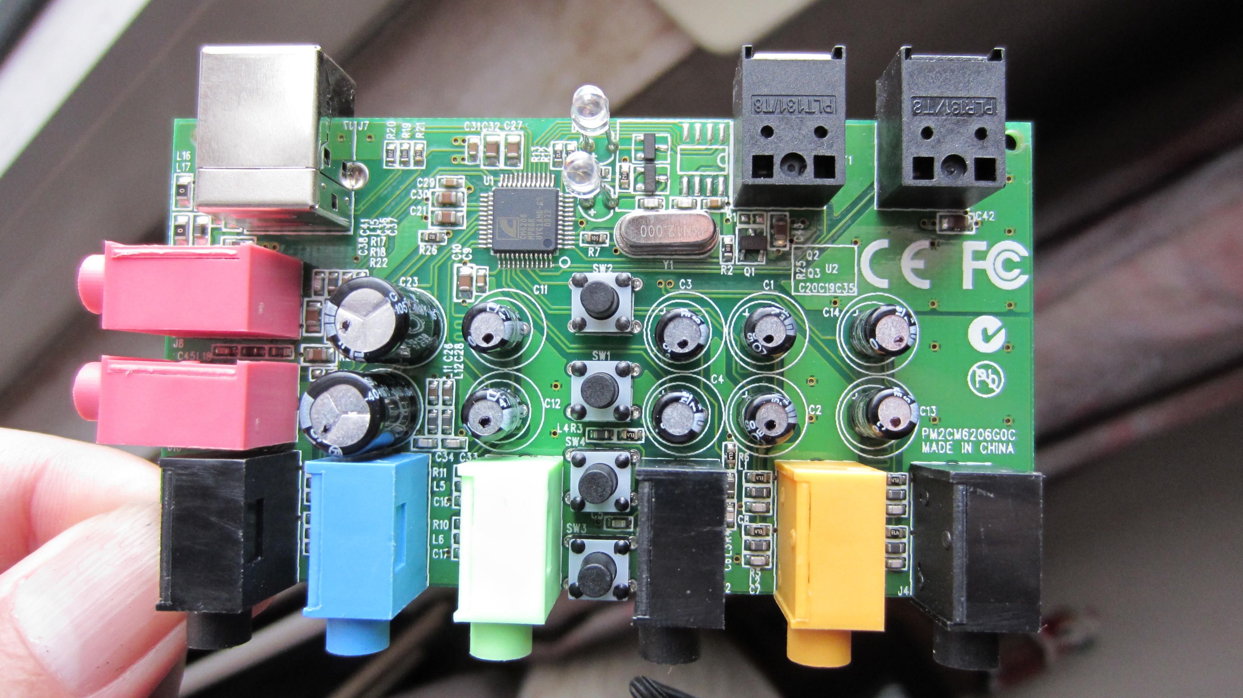

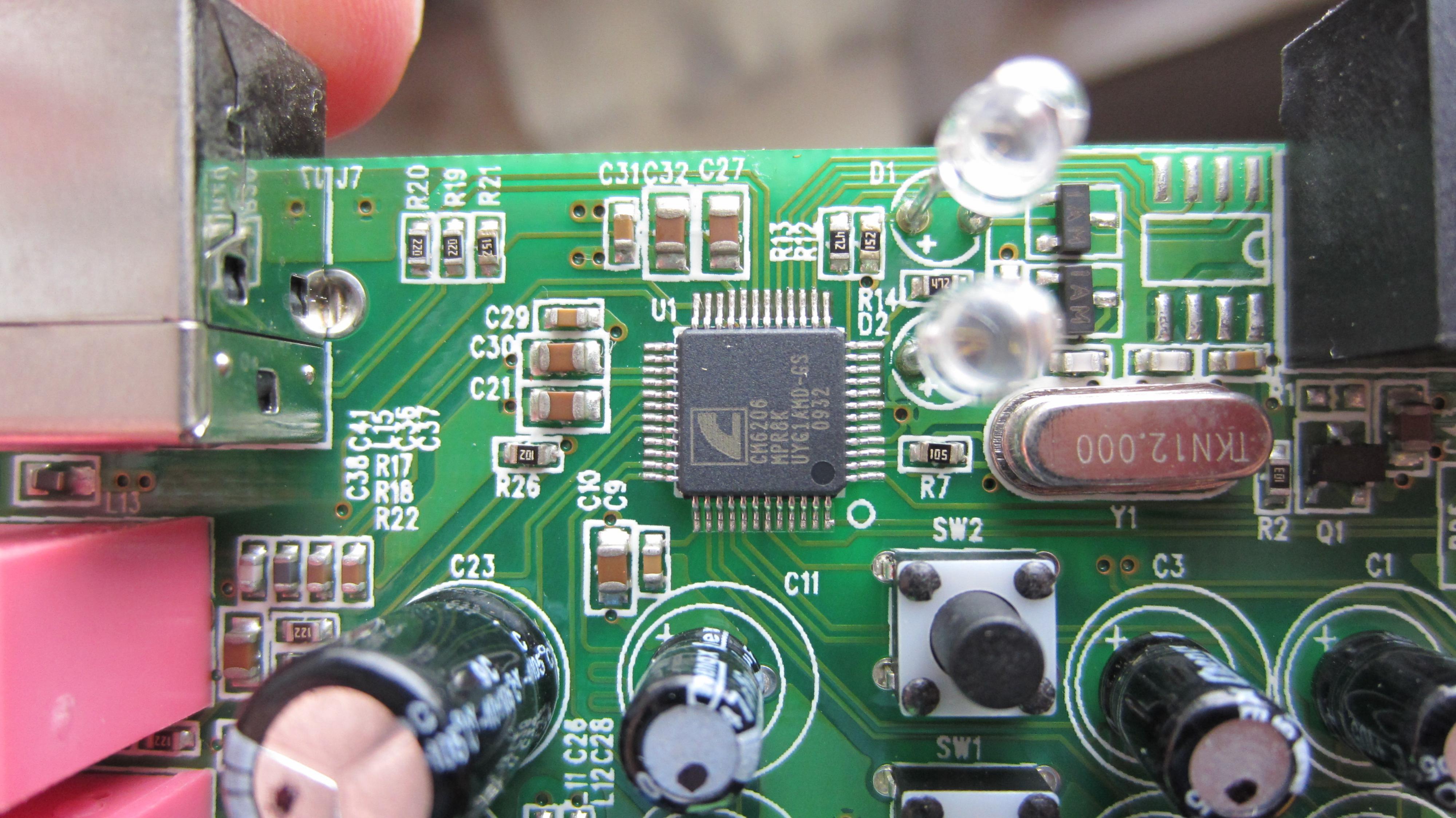

How they manage to get the 0.0us group delay variation with freq then is beyond me.

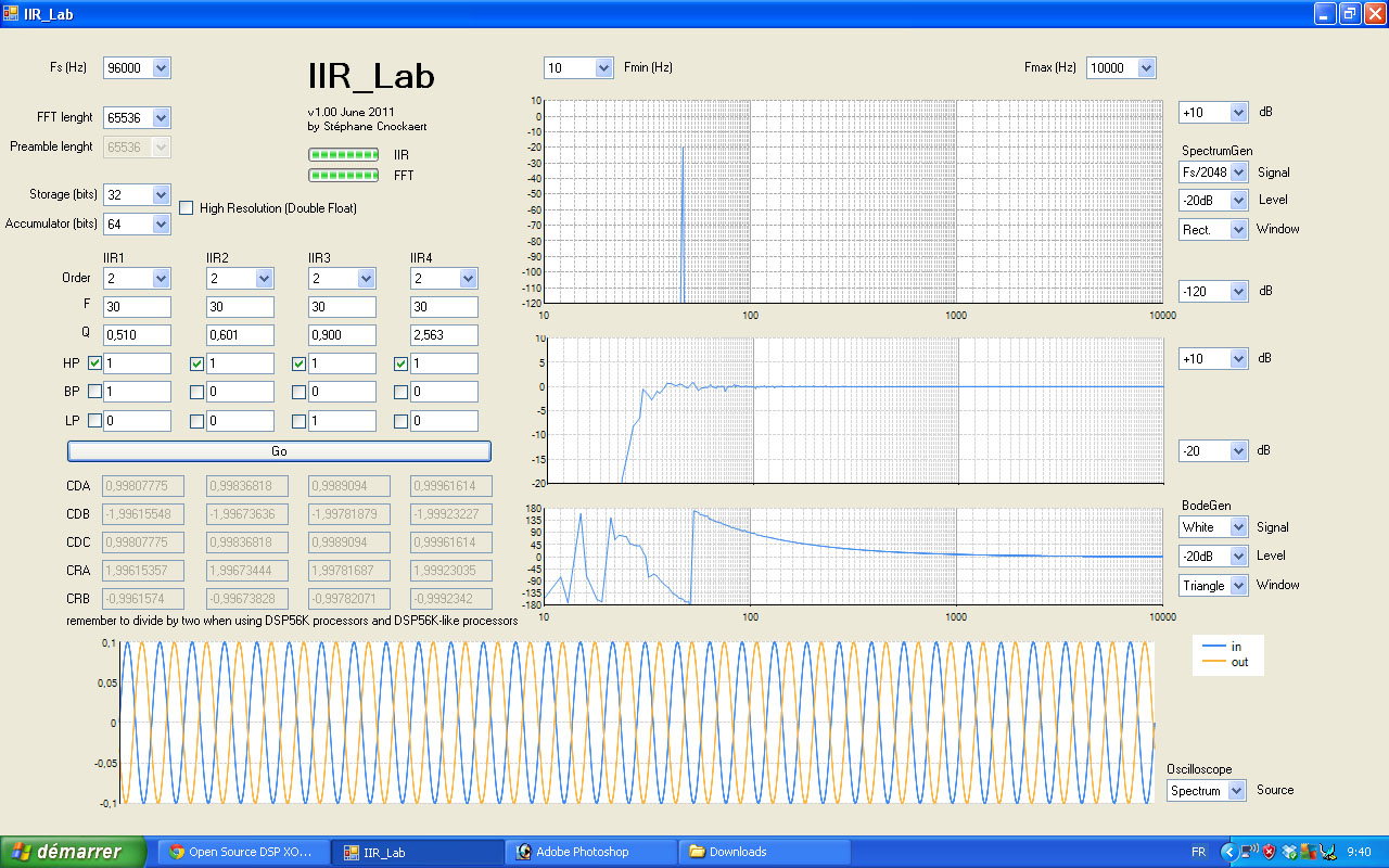

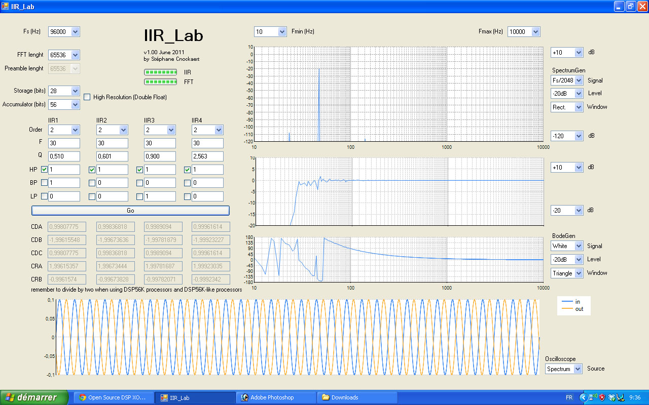

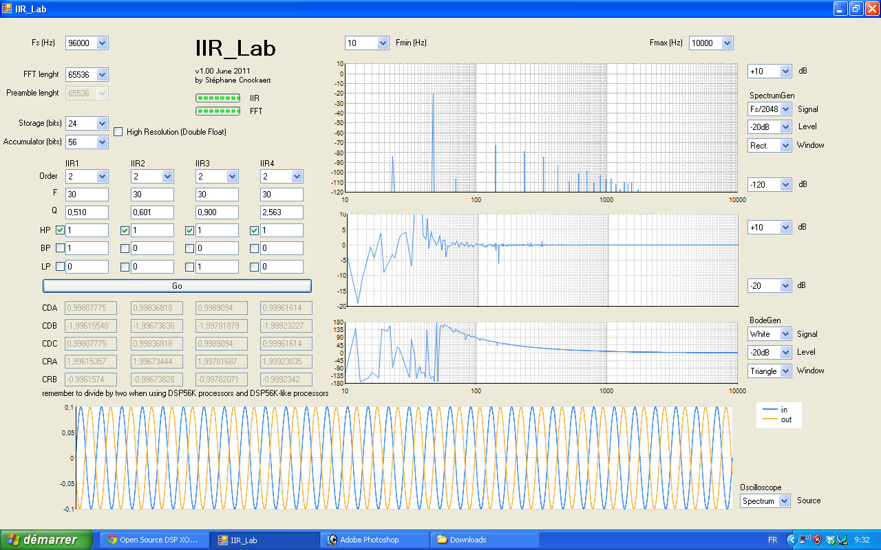

... The second detail is the 24-bit resolution. My little IIR_Lab application shows that you should not program a Linkwitz Transform with such resolution. An additive/substractive Parametric Equalizer may be more robust. MiniDSP opted for the SigmaDSP ADAU1701 from Analog Devices, featuring a 28-bit signal path and a 56-bit MACC result.
I don't understand your complaint. The "24-bit" DSP56K has the same 56-bit MACC result. The 28-bit signal path might prove an advantage, but both processors have the same size 56-bit accumulator registers.
I believe his point is 24-bits isn't enough in the signal path. 28-bits is better but why not go for 32 with the Cortex M4? See also the link in the first post of this thread - here's an abstract:
This data should dispel once and for all the myth that digital filters aren't noisy. With 'only' 24 bits of signal processing, the Direct Form filter is inferior to the analog filter at frequencies below around 300 Hz. At a 10 Hz cutoff frequency, the digital filter's noise level is worse by 34 dB than the analog filter.
I've asked IIR_Lab to graph the results on a Linkwitz Transform. Clearly, the 24-bit data 56-bit acc delivers more noise and distorsion than the 28-bit data 56-bit acc.

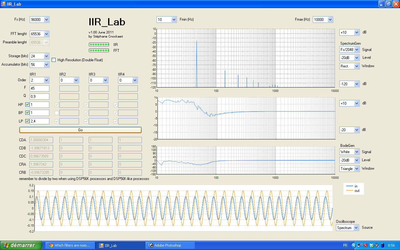

Same pattern for a 30 Hz Butterworth 8th-order Highpass (Fs = 96 kHz).

Well you don't need to stick to direct form...
There's a whole lot of alternatives available and very well documented: double precision, error feedback, state-space etc.
Also this 300 Hz your quote refers to is suspicious. Is there a context that goes with the quote?
Finally, 24 bits is 144 dB of dynamic range: that covers everything from ants walking to the heart of the space shuttle's engines. If you can't do proper audio processing on a 24-bit platform then maybe you should indeed stick to analogue filters and let dsp to dsp guys. This doesn't mean that Cortex is not suitable - just don't say that 24 bits are not enough because that's false information.

I agree. There are textbooks which show multiple different implementations of the same digital filter, and graph the different frequency precisions available in each. If 300 Hz or 10 Hz is working poorly with your implementation, then you need to change the code. There might not be a single piece of code that can sweep a single cutoff parameter from 10 Hz to 40 kHz, but that's generally not needed in a crossover. You have plenty of opportunity to optimize your filter for low frequency or high frequency or whatever is needed.
Interesting discussion. Let's focus on a Butterworth highpass 8th-order 30 Hz -3dB. Sampling frequency 96 kHz. What method would you advise, on a DSP56K, for getting rid of the noise & distorsion produced by the native (naïve ?) series IIR BiQuad implementation ? Keep in mind we need the exact same Bode plot. What would be most exact and efficient way ?
- Boosting the precision using more elaborate arithmetic routines for the multiply-accumulation (say, reaching a 32-bit data path inside the BiQuad, operating with 64-bit accumulator) ? What would be the computing time penalty ?
- Decimating the signal, applying a series IIR BiQuad in a lower sampling frequency context, upsampling the signal for getting back a 96 kHz sampling frequency ? What decimation factor to use ? Can we guarantee a Bode plot that's exact ?
- Any other method welcome
