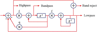

For low frequency filters I used state variable filters on an Analog Devices SHARC because the direct form and SIMD optimized library functions produced to much noise. I assume the state variable filters would work equally well for fixed point 32 bit and 24 bit DSP's.
Hi Trevor, would you dare saying that for the low frequencies (like a 2nd-order 30Hz highpass on a 96 kHz system with Q in the range of 0.3 to 3.0), that the output from a hand-coded Chamberlin Digital State Variable Filter will be cleaner than the output from a hand-coded Direct Form IIR BiQuad ?

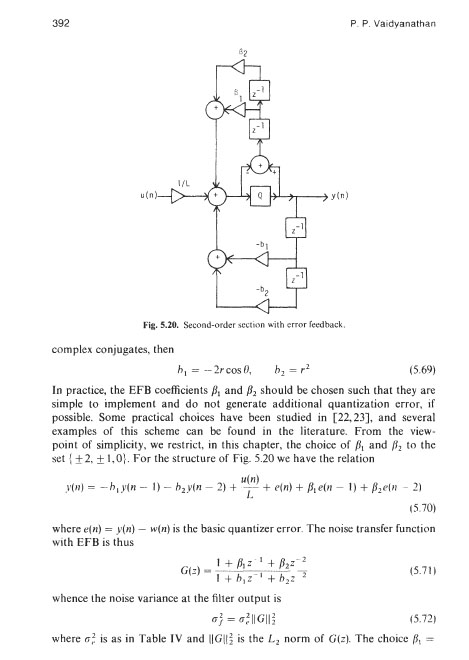

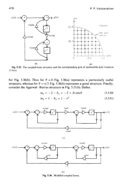

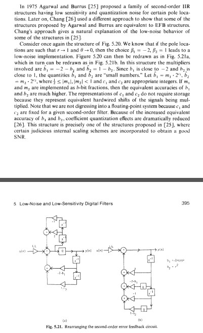

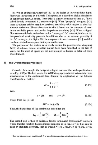

A friendly reply is to recommend the Handbook of Digital Signal Processing Engineering Applications (Elliott, Vaidynathan, Harris, Pasthoon, Silva, +)

  • Digital Signal Processing Handbook - Chapt. 5 - Page 392 - Error Feedback.jpg
  • Digital Signal Processing Handbook - Chapt. 5 - Page 395 - Agarwal & Burrus.jpg
  • Digital Signal Processing Handbook - Chapt. 5 - Page 418 - Coupled Form.jpg
  • Digital Signal Processing Handbook - Chapt. 5 - Page 420 - Fettweis Wave Digital Filter.jpg
