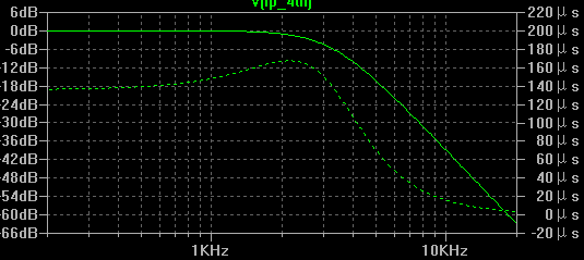

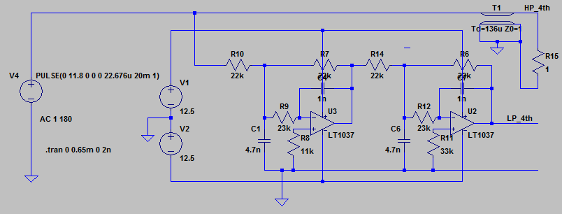

Here's a design flow I've played around with this week as a rather different way to design digital FIR filters than the traditional MATLAB and equiripple style approach. As Julian Dunn pointed out in a paper, there are some hidden pitfalls of using equiripple filters in digital audio. Bruno Putzeys has picked up on his paper too. In a word - time smearing.
So in an attempt to avoid time smearing I decided to explore how using an analog filter as a template for a digital one might work out. Here's a 4th order MFB lowpass that I'd like to have as a digital filter. Its the LP half of what I've been using (LR4) in my active speakers of late. But here you'll notice there's a delay line for the HP rather than the traditional two opamp Sallen-Key - the idea here is that with digital filters we can use delay elements for free (unlike with analog filters) so why not build a subtractive cross-over? Doug Self points out in his recent book on active XOs that subtractive XOs have the weakness in analog implementations that they depend on matching for their stop-band performance. Well in digital, matching doesn't need to be an issue.

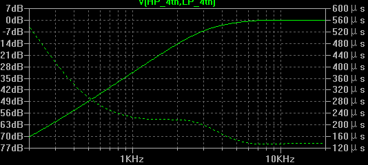

LTSpice allows us to set up both frequency response and time domain characterisations - I've done that here. First check the frequency domain performance is what we expect. Then do a time domain analysis with a single cycle impulse - given that this is to work at 44k1, a pulse 22.7uS wide is chosen. By trial and error I fiddled the group delay (integrator time constants) to match an integer number of samples (6 in this case) - the precise crossover point isn't as important as getting the right delay.
With the delay line matching the filter's asymptotic group delay, the HP subtracted output looks like the last plot.
OK, now getting back to the original purpose of this thread, which was to encourage people to try out LTSpice as a digital filter design tool and hence establish a base of 'open source' digital filter designs.

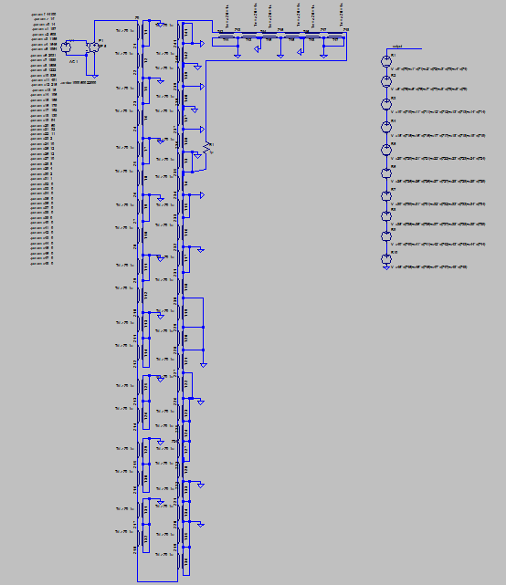

Turning an analog filter into a digital one
The next step is one I'd like eventually to automate - I'm sure its not hard to do that, but I did this manually to get a feel for what goes on. I tabulated the impulse response plot, having normalized it (by trial and error) to get 1LSB = 1mV. I decided to go for 12bit coefficients, which means 2.047V is the maximum representable amplitude. To do this, just scale the amplitude of the impulse to get the peak close to the maximum digital value. I needed 11.8V to achieve 2.031V as a peak value (the waveform goes slightly beyond this between samples).

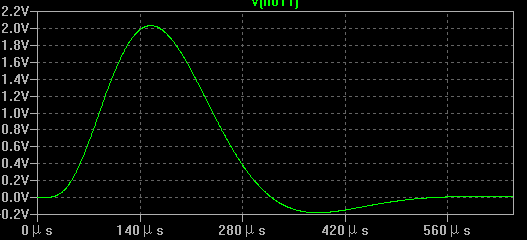

The values of the impulse function I wrote down at intervals of the sample rate (22.6uS approx). These values then become the coefficients for the FIR filter which we build using delay elements.
The pic is a little cramped owing to not having too much resolution on my screen, but down the left are the coefficients expressed as a column of .param's - the summation is done with the series voltage sources over at the right.

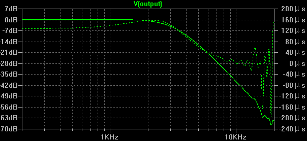

Here's what the synthesized FIR looks like in the frequency domain
The stop band has wiggles - these are the result of both quantizing the coefficients to 12bits and truncating the impulse response in time to a relatively small number of samples (31 in this case). I've not used any windowing function to smooth off the discontinuities just tweaked the final few coeffs by hand to see how the stop band wiggle shifts around.
