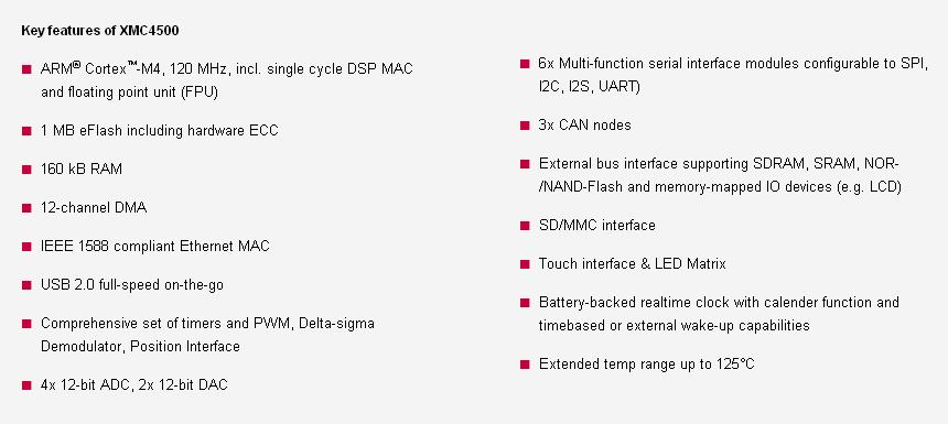

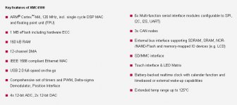

The Infineon XMC4500 will be easier to program than the NXP LPC4300 asymetric core (M4 + M0) and SGPIO.
The Infineon XMC4500 has 6x Multi-function serial interface modules configurable to SPI, I2C, I2S, UART. It might thus provide the required serial interfaces for a 3-way stereo crossover :
- 1 x I2S (left and right inputs)
- 3 x I2S (crossover outputs)
- 1 x SPI (SPDIF receiver mode, ADC mode, ASRC mode, DACs mode, volume control, display)
- 1 x I2C if some chips require one
USB for communicating with a PC, for setting up the crossover. Possibly, the same USB as asynchronous audio input ?
Memory-mapped LCD display using the bus interface.
