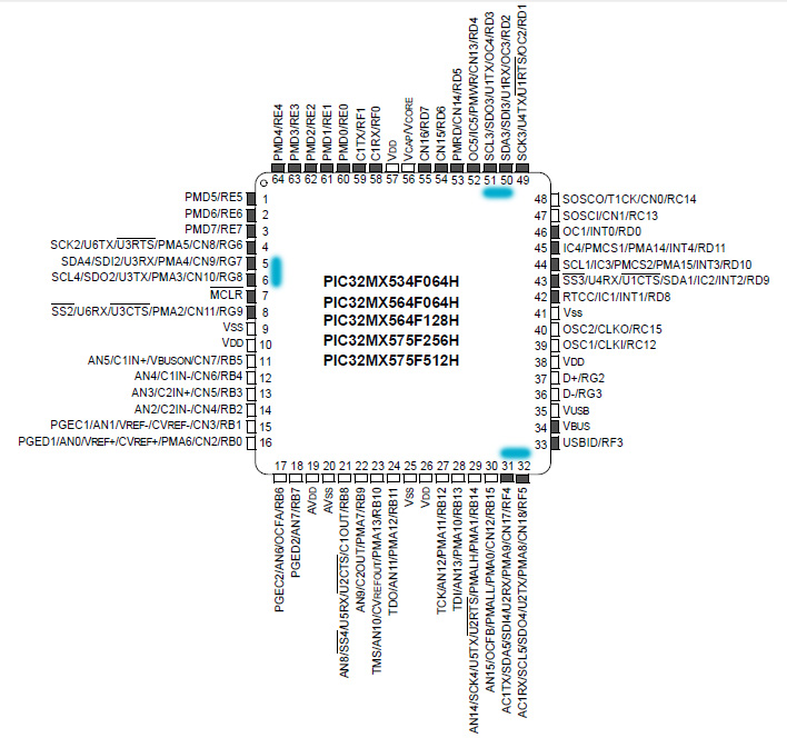

Seems that a chip like PIC32MX534F064H (5.06 eur from Mouser, 64-pin) also benefits from the SPI upgrade supporting I2S. There are three SPI. They could interface a WM8580A Codec for implementing a stereo 3-way crossover with SPDIF-in, Analog-in, and volume control. As all three SPI are taken by the audio lanes, one extra SPI needs to be implemented using bit-banging for controlling the volumes.
Seems that the PIC32MX534F064L (5.67 eur from Mouser, 100-pin) has four upgraded SPI. This way the fourth SPI can be used for controling the volumes, so no bit-banging anymore for controlling the volumes.

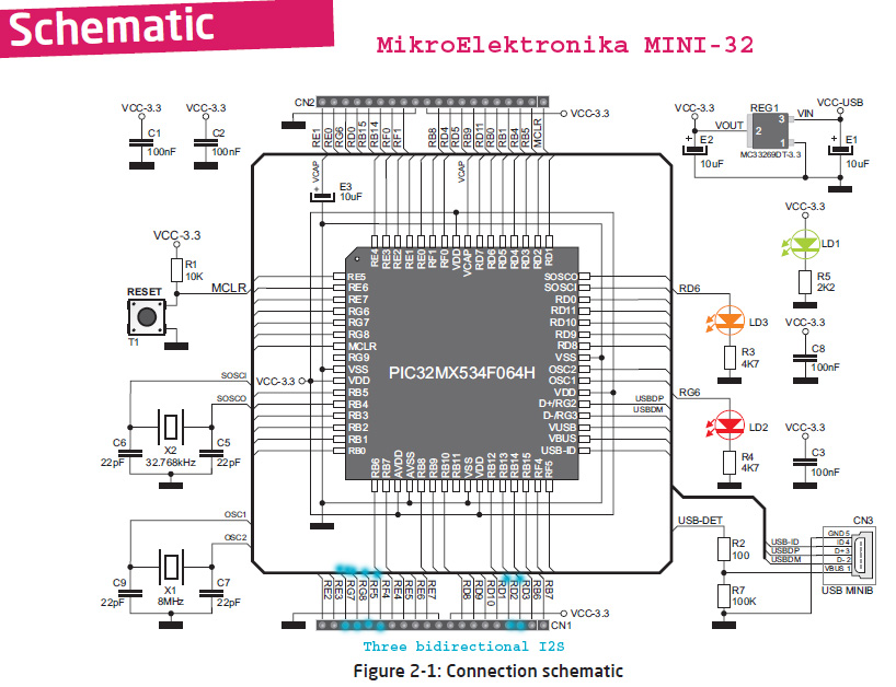

I'm tempted by a MikroElektronika MINI-32 board (25.00 usd), featuring a PIC32MX534F064H inside. Designing a MINI-32 "shield" hosting a WM8580A Codec (5.91 eur from Mouser) would lead to a stereo 3-way crossover with SPDIF-in, Analog-in, and volume control. Don't know if the built-in USB can be used as audio input.

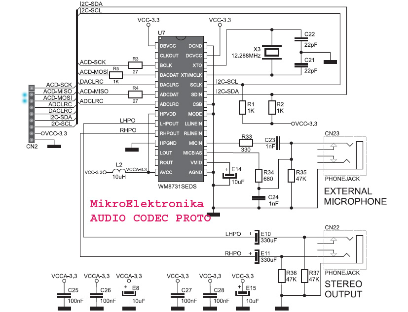

Quite interesting is the MikroElektronika AUDIO CODEC PROTO. This is a tiny board hosting a WM8731 Codec. During months, MikroE remained evasive about how to connect it on a PIC32 SPI. Now with the PIC32 SPI upgrade supporting SPI, it should be a piece of cake. I guess MikroE is now working on sample code for their MINI-32 board when hooking their AUDIO CODEC PROTO.

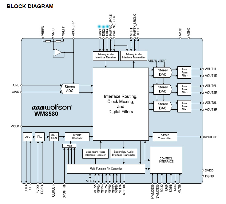

I'm tempted by a MikroElektronika MINI-32 board (25.00 usd), featuring a PIC32MX534F064H inside. Don't know if the built-in USB can be used as audio input.
The 64-pin 'H parts have 3 I2S SPI, the 100-pin 'L parts have 4 I2S SPI.

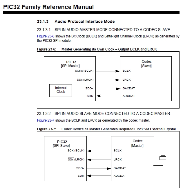

As shown above, if the PIC32 redesigned SPI can synchronize three SPI in audio (aka I2S) mode, a proof of concept can be designed right now using one MikroE MINI-32 and one MikroE AUDIO CODEC PROTO (Codec in Master Mode). The oscilloscope can easy tell if all three SPI outputs remain in sync. If all three SPI outputs remain in sync, it will be time for designing a "shield" for the MikroE MINI-32, hosting a WM8580 Audio Codec.
