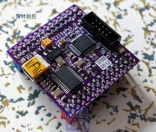

Nope, a much cheaper one. See attached pictures - cute eh? Thanks for the links btw 🙂
Hey, it reads Cortex-M0 on the PCB. Are you using the ARM Cortex-M0 as DSP engine ? Does it imply that you are using a 32x32 bit multiplication with a 64 bit accumulation ? Looks impressive. But wait a minute, how do you attach a I2S audio DAC on such CPU ? Are you using the built-in serial ports, or a FPGA maybe, so in a nutshell, how do you manage the frame sync and how do you guarantee it remains jitter-free ?DSP56K ? Nope, a much cheaper one. See attached pictures - cute eh? Thanks for the links btw 🙂
Bingo 😀 Well spotted.
No - the multiply on the M0 is a lot more rudimentary. Perhaps you've been indulging in too much of the M4 user manual - I must confess to salivating on reading all about its DSP extensions 🙂 M0 can do 32*32 in one cycle (20nS for the incarnation you're looking at there) but there's no way to handle any overflow so its best to keep the input values to 16 bits or less. Accumulation can be any number of bits (up to the limitation of 14 user registers) so long as the individual products don't overflow 32bits. This means long FIRs are not a problem but coefficients can't easily exceed 16bits.
Yes - at the moment one built-in serial port is generating the BCLK and DATA signals, I use a timer output to create WS. That makes up a single stereo I2S channel. The built in FIFO means this is good for up to 4X oversampling. There's a second serial port available for more fancy effects or doing a two way XO potentially (which is in the pipe of course, no timescales yet...).
Frame sync is admittedly a bit of a hack being generated by a timer. Have to set that up empirically which is a bit of a hassle. Its not jitter free yet - I have noticed jitter sidebands on the output of test tones, but they're fairly low in level (below -110dB from memory) so not overly concerned about them just now. A solution is available - use the SSP in slave mode with an external clock - for those who are jitter averse.

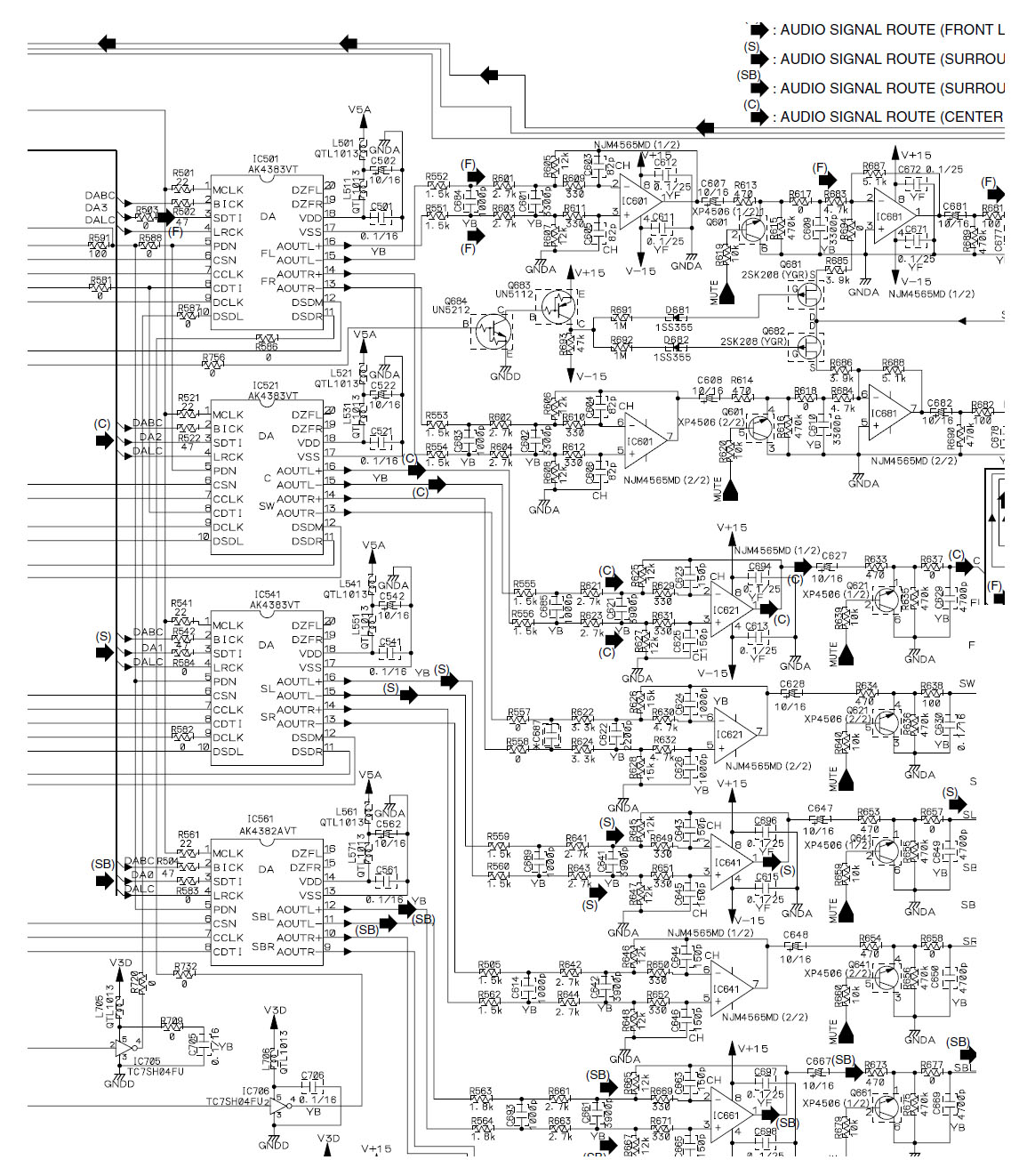

Would be nice to have such tiny lovely PCB replacing one or more AK4383 DACs. Hacking an audio-video receiver this way, you can be multichannel and multiway, all in digital domain. Imagine a USB port for configuring it in a flexible way, basing on a LTspiceIV netlist. See attached picture.
