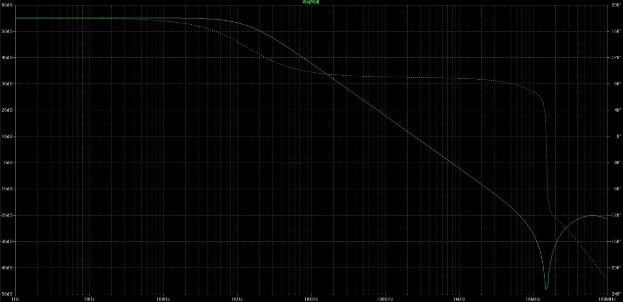

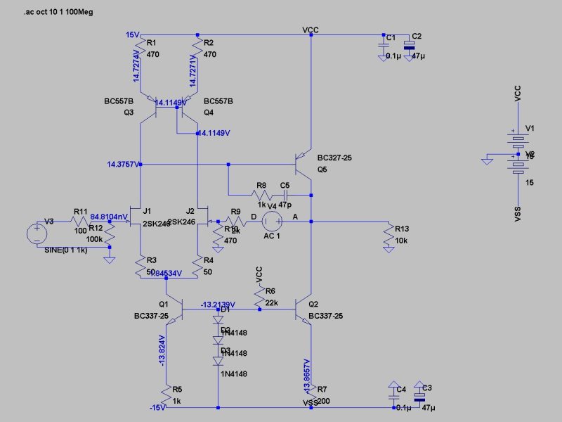

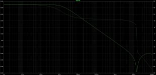

Hi, everyone, I am a new here and just begin my adventure with audio ampifier from ground recently. Thank you for such a great post here. It really give me tons of information about how to get the correct loop gain simulation. See pictures of my recent design. Maybe it's over compensated as a result of following the open loop gain way. I am glad to be here.....
karajanlee- you have it very right and no I do not think your amp is necessarily over compensated. I give it an excellent design award. Believe you will find this amp to be exceedingly clear and smooth unlike the other 99% of what you will ever experience. I prefer push pull complementary output though.
