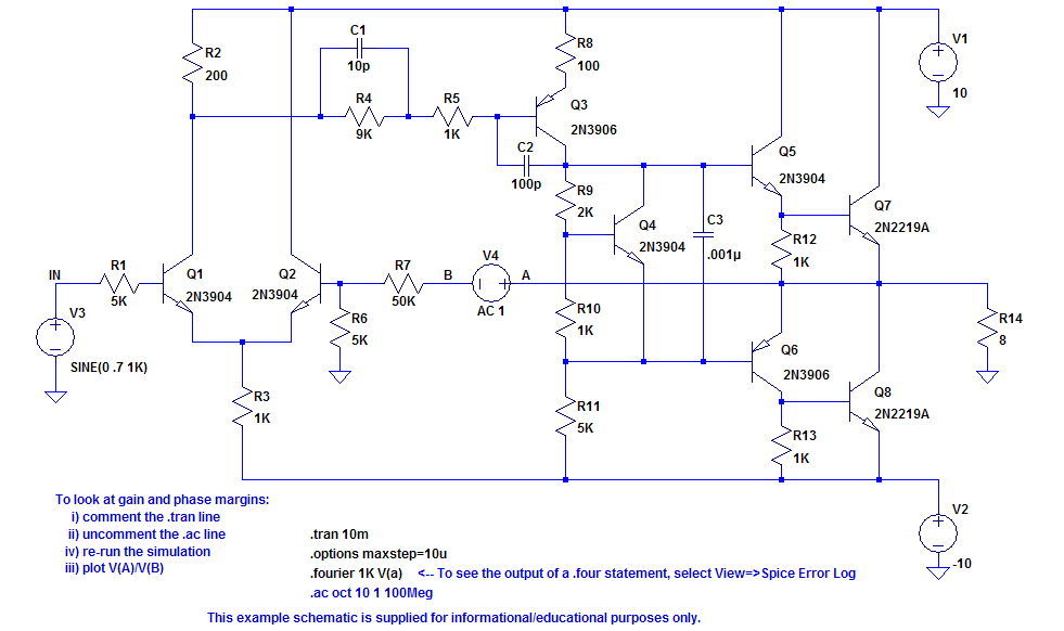

Meanwhile, there is an approximate way to simulate the loop gain, which appears in the LTspice example called "audioamp.asc". I've posted the relevant schematic below, which also has instructions on how to do the simulation.
Edit: I think you'll want to plot -V(A)/V(B) here, so the phase approaches zero as you approach DC. Put the voltage source in the same place as in the schematic, that is, from output to feedback resistor, with the nodes "A" and "B" defined as in the figure.

Well.... now I've finally got off my **** and started simulating the right thing, I'm getting some sensible results. According to the proper loopgain simulations, albeit by the crude method, all I need is a 10pF miller cap around the VAS and nothing else to get me 60deg of phase margin and 16dB of gain margin. Amp is actually far far more stable than I had thought by looking at the wrong plots!!!
Sorry for wasting everybody's time by insisting on simulating the wrong thing!

In this test with the voltage source in series is this giving us the open loop gain or loop gain?
David.
I think this gives the voltage loop gain.

I don't get to read about the right halfplane zero too often. But Bob Cordell covered it pretty good in post 42.
When I started with (diy) amp design, I also fell for the open loop gain trap, as I tried to determine wether my design was stable by looking at the open loop gain instead of at the loop gain. As a result I got heavily overcompensated amps.
By now I use the middlebrook method to determine the loop gain, and so far it served me well.
Sometimes my approach can be a little enerving, because every change has to be done twice, as the circuit has to be duplicated to determine both the voltage- and the current-loop-gain at the same time.
I attached an LTSpice demo file.
sorry for the black bar at the bottom. A bug in my screencapture program. However the most important parts are still visible.
I think I will look out for a loopgain probe for LTSpice to make things easier.
