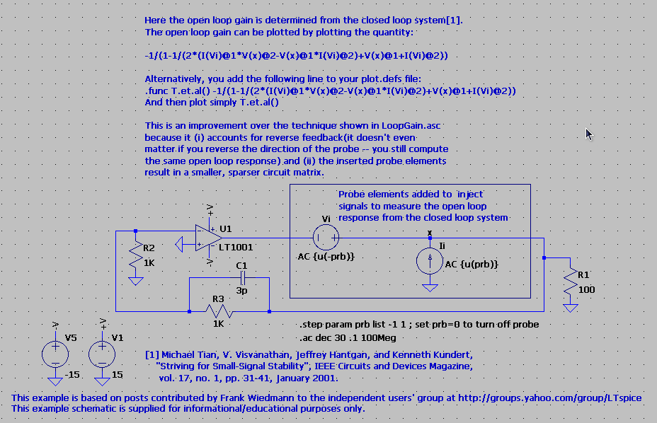

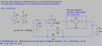

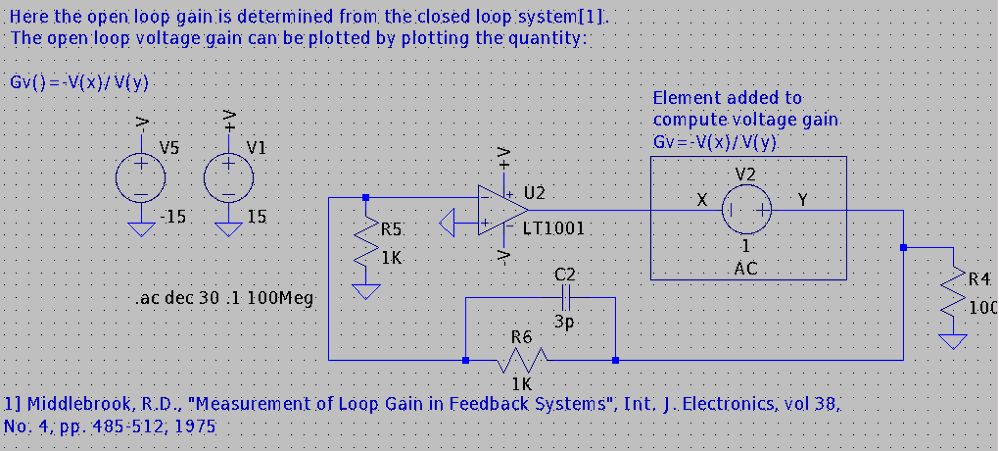

And here is another way of OLG simulation.
