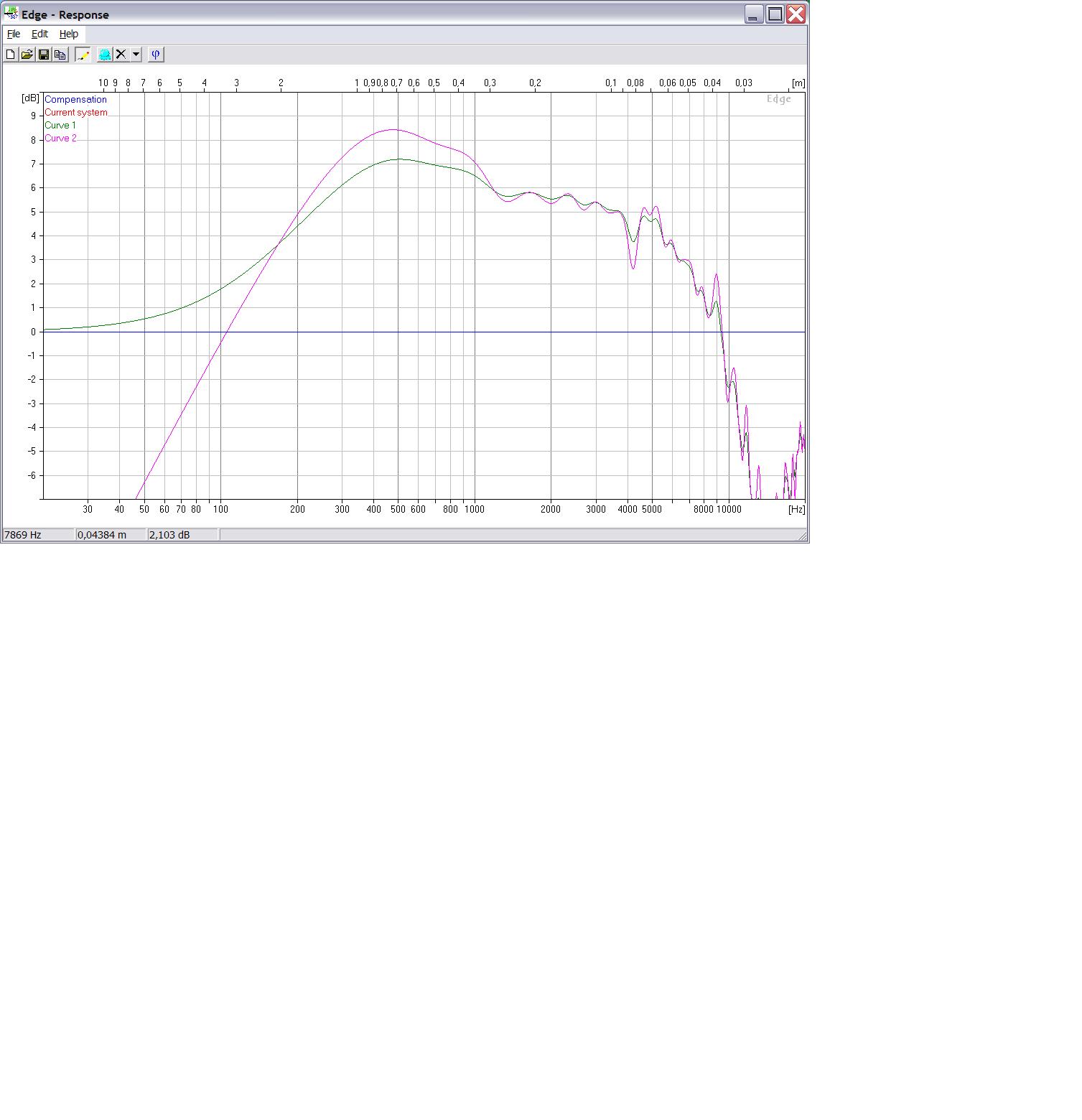

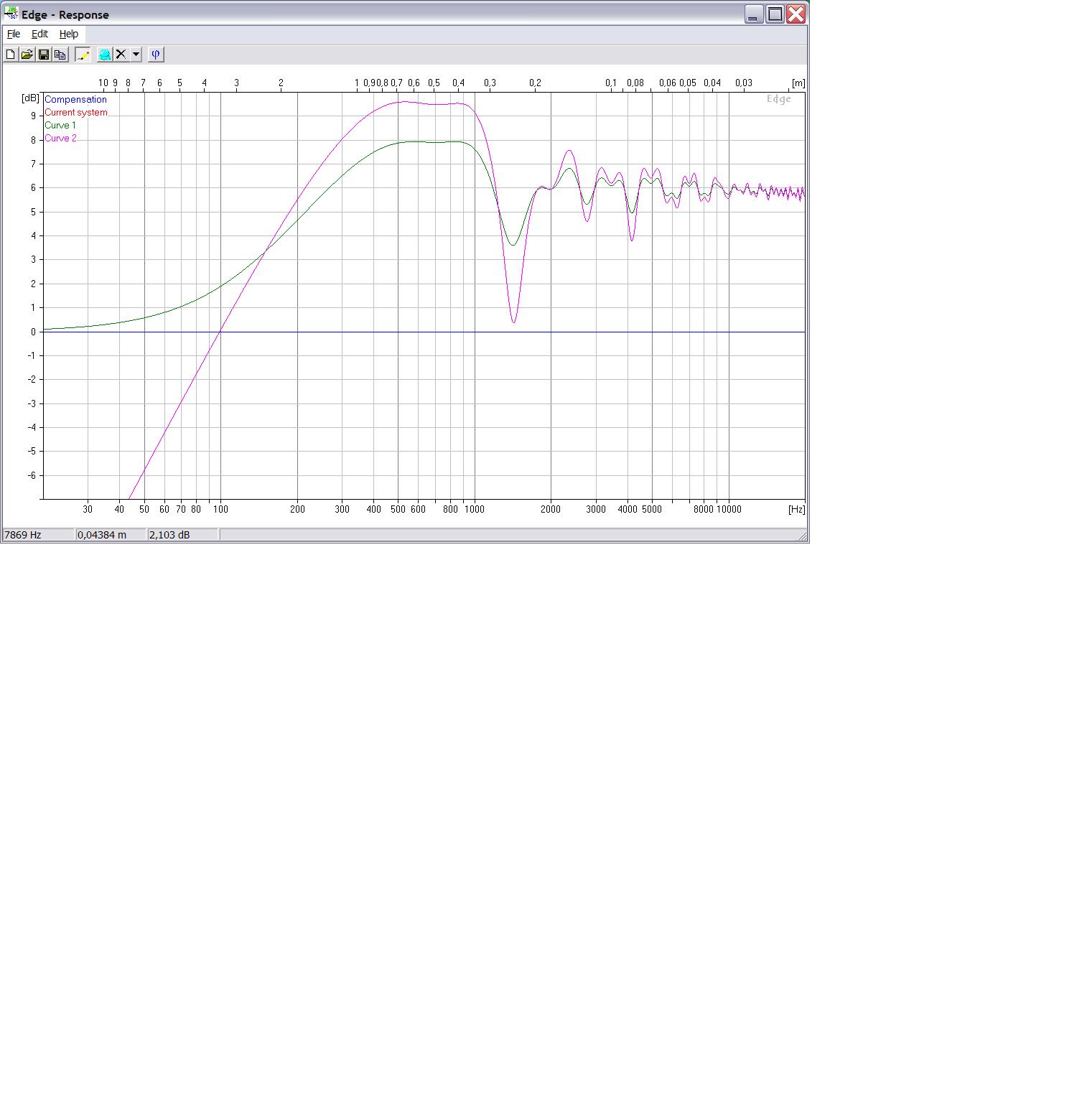

I used "Edge" to substitute a 30mm (!) driver by a 300mm driver on
a baffle about 65cm X 40cm.
I switched between
"open baffle" (pink curve) and
"closed box" (green curve).
Goal was to produce large differences in baffle diffraction
effects. The closed box condition is not the same
as the "active cancellation" approach, but it may show
the potential benefit.
A potential benefit in less pronouced ripple (epecially notches)
is only there with very small drivers operating up to
the Khz region.
The mounting of the "canceller" would have to be very close,
and it must be driven into the Khz region too to take effect.
I agree, that passive "rear wave cancellation" seems much
more attractive.

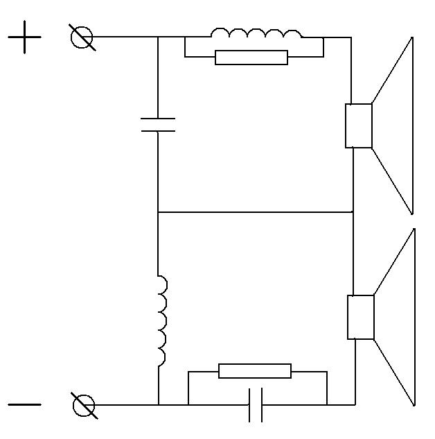

Hi Guys,
Can somebody give me opinion on the applied here-below idea of schematics of the filter of the speaker discussed in that thread?
If someone is able to run a simulation of it and see what happens as I don't have the needed knowledge for it 😱
I don't insist on the compensating RL and RC circuits, but they are a way to manage different sensitivity for instance or baffle step and etc...
Best regards!
Best regards!
